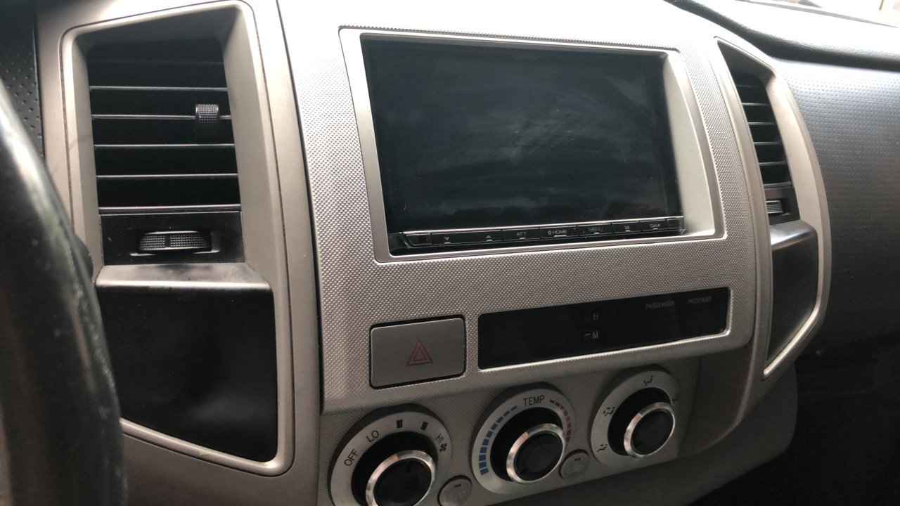

    I just finished installing a new Kenwood head unit with wireless Apple CarPlay. Part of the installation required to tap into then VSS (Vehicle Speed Sensor)
    Took the truck for a test drive about two miles. All worked well. Came back home to put things back together. On restart about an hour later; the truck will turn on but will not engage the transmission.

    The unit that installed is a Kenwood Excelon DMX906S
    The unit has wireless Apple CarPlay and Android capability.
    In order to be able to use CarPlay wirelessly, one must tap into the Vehicle speed sense. On the Tacoma 2005 is found in pin #5 of 13-pin black plug at driver’s side dash fuse box - purple/white

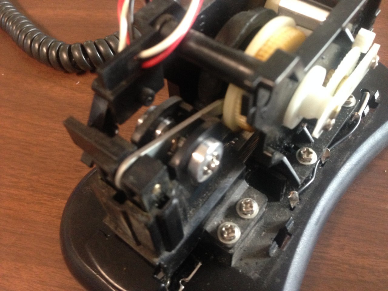

    My 06 had the same problem as the bushing disintegrated. Where did you find the part?
    I found an aftermarket replacement part for $25 but that is way too much for a tiny piece of plastic.
    I ended up fabricating a bushing using a hard rubber grommet/plug. Holding good but should probably get the right part.

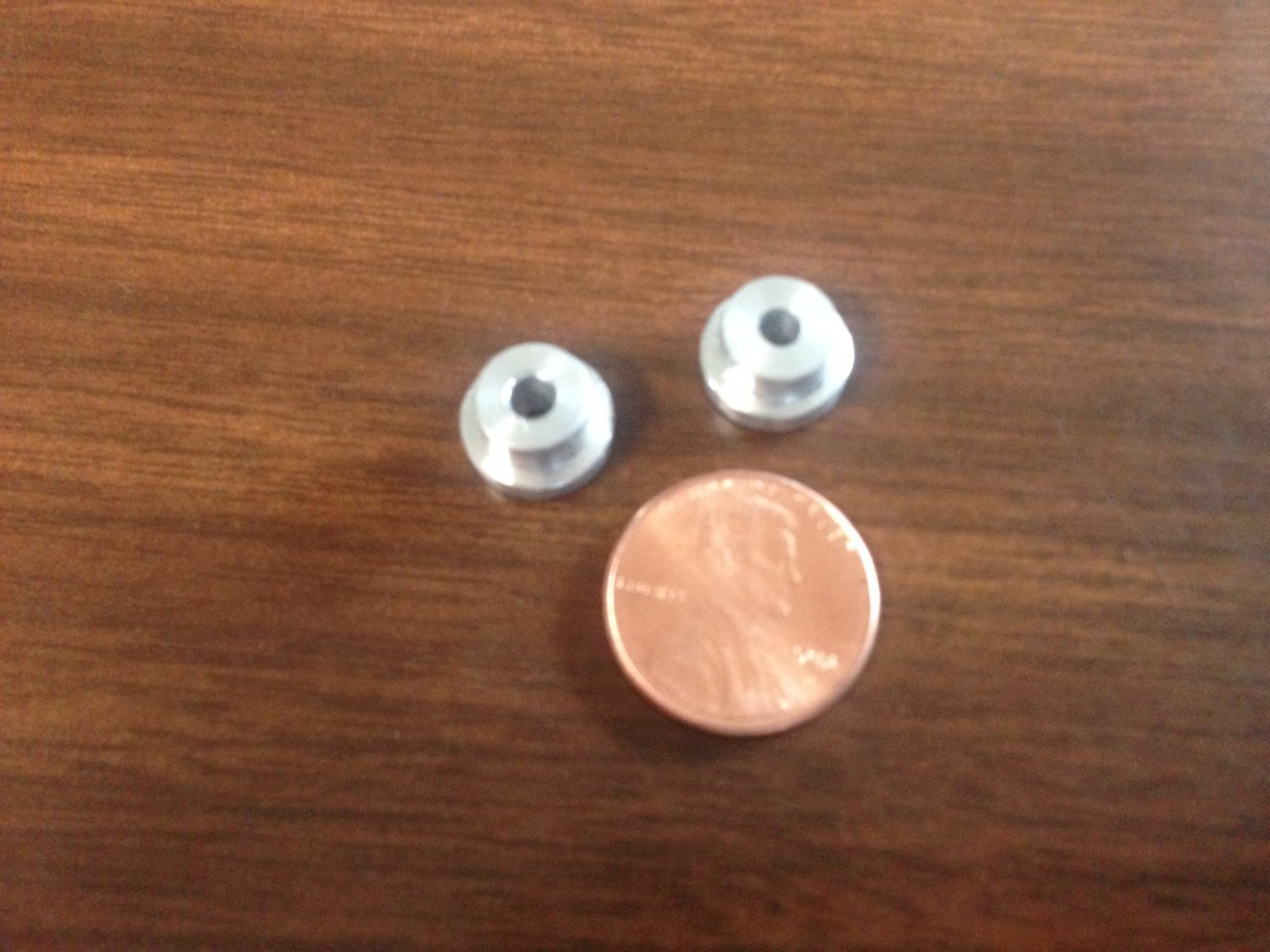

    Thanks for letting us know. So, I guess if the dash indicator stays on some letter other than P, try to push the truck. If it rolls, the cable fell off. Also, if it stays on P when you shift to D, and the truck can't be pushed, the cable fell off. Looking at that bushing on ebay makes me consider that maybe I should buy 1 for my '06.
    The other day, a plastic bushing in my electric stapler broke. I decided, screw it, I'll make my own bushings.
