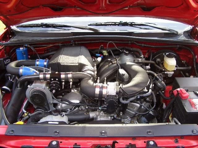

    OK, The guy at the Toyota Dealer doesnt apperantly know how to talk to the system. Here is the pic of the x-runners setup. We checked the things mentioned above, and everything seems tight, booster pipes, etc. Hoping somebody here can tell us what we got.

    You need to find someone who can work with that URD tuner

    if my memory serves me correct, the URD controller ONLY activates when it sees boost. So if the problem returns after 3-4 min after resetting the factory ECU and is idling the whole time then I doubt it's blower/controller related

    If I'm not mistaken the MAF harness has to be extended to reach its new location on the MKI. Check to make sure the connections are still soldered correctly. I had one of my MAF wires come loose after extending the harness and my truck did the same shit intermittently and never threw a CEL
