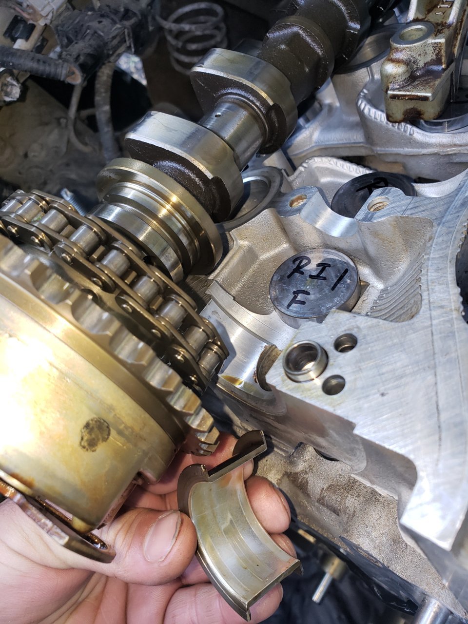

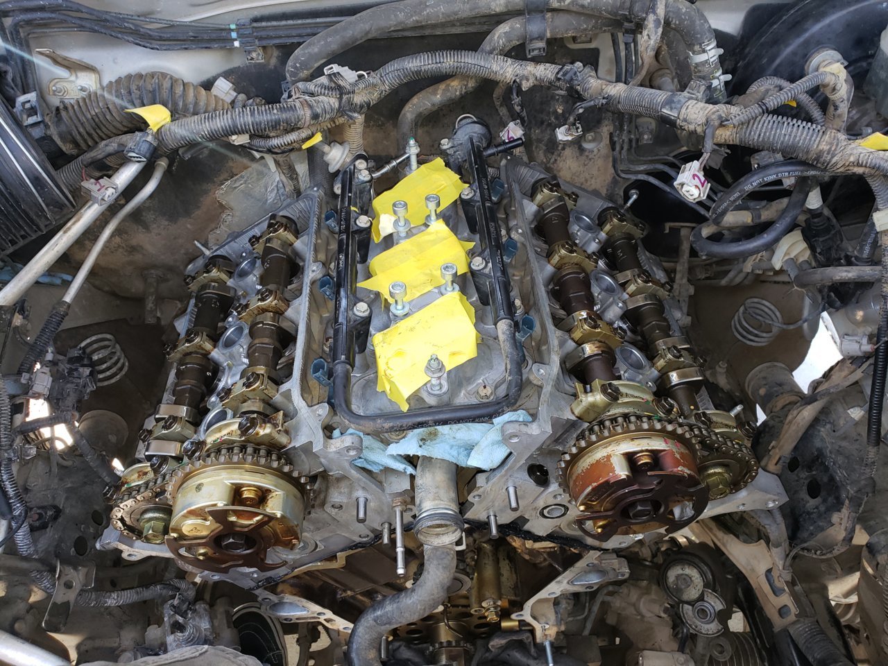

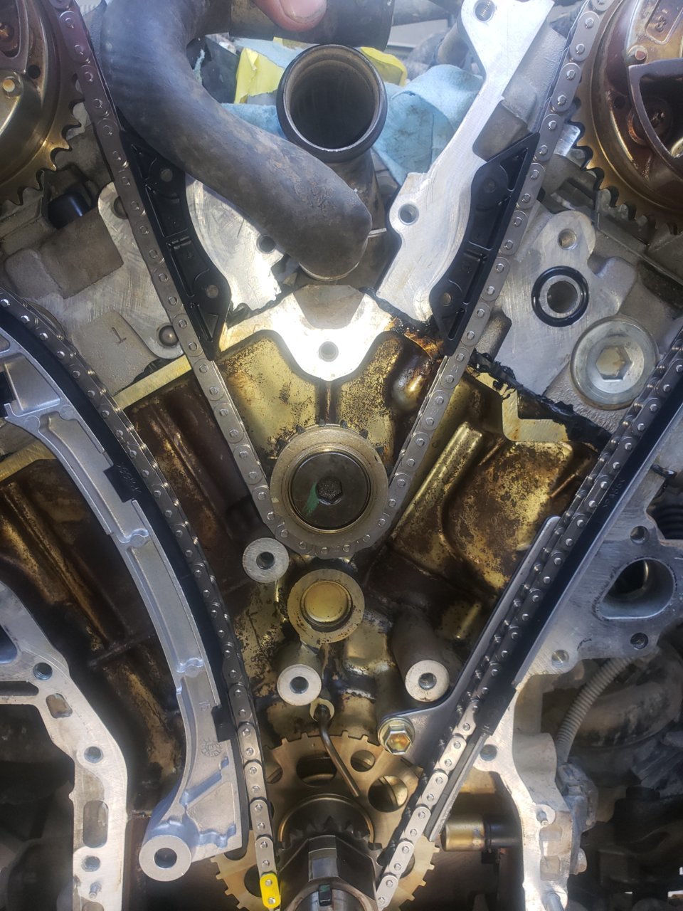

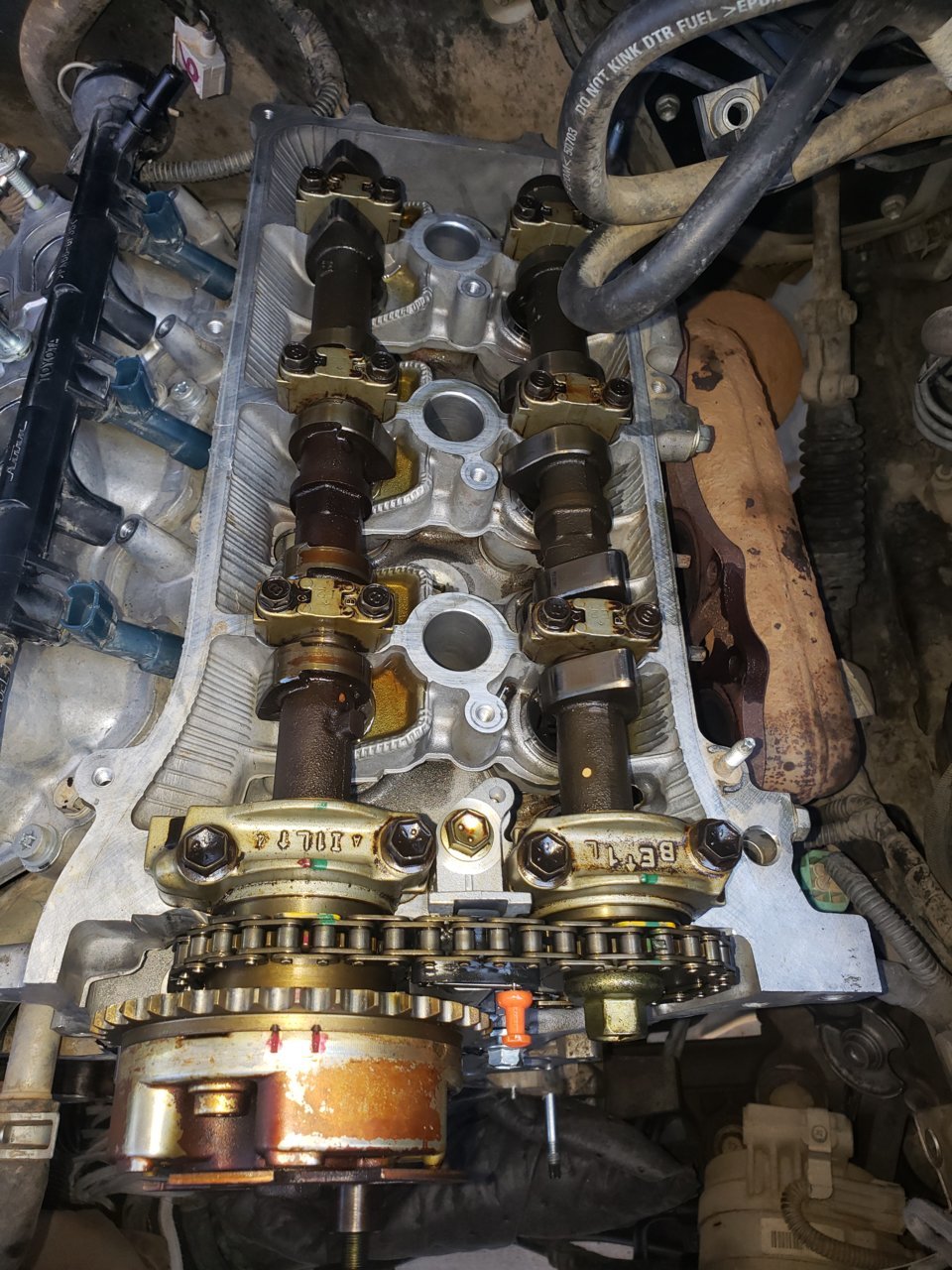

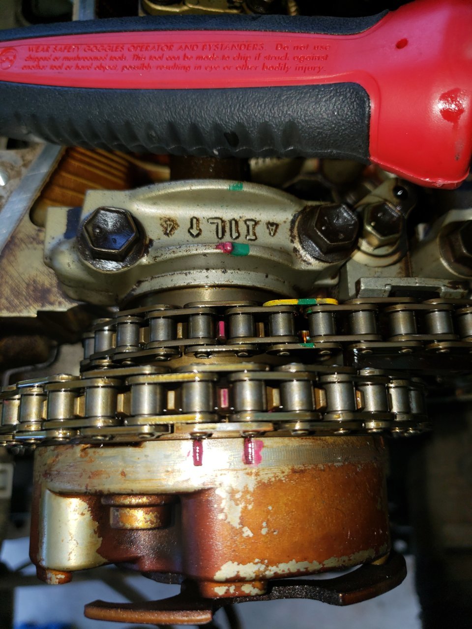

    +++++++++++ THE JOB ++++++++++++++++

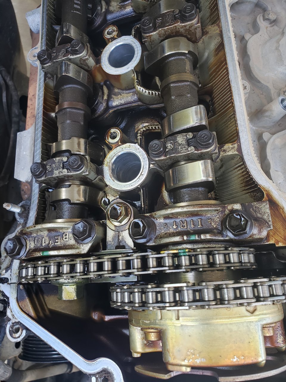

    :) 20190815_084412.jpg
    :)*PICTURE ABOVE. The right side intake cam is the only one that take the bottom half shell.

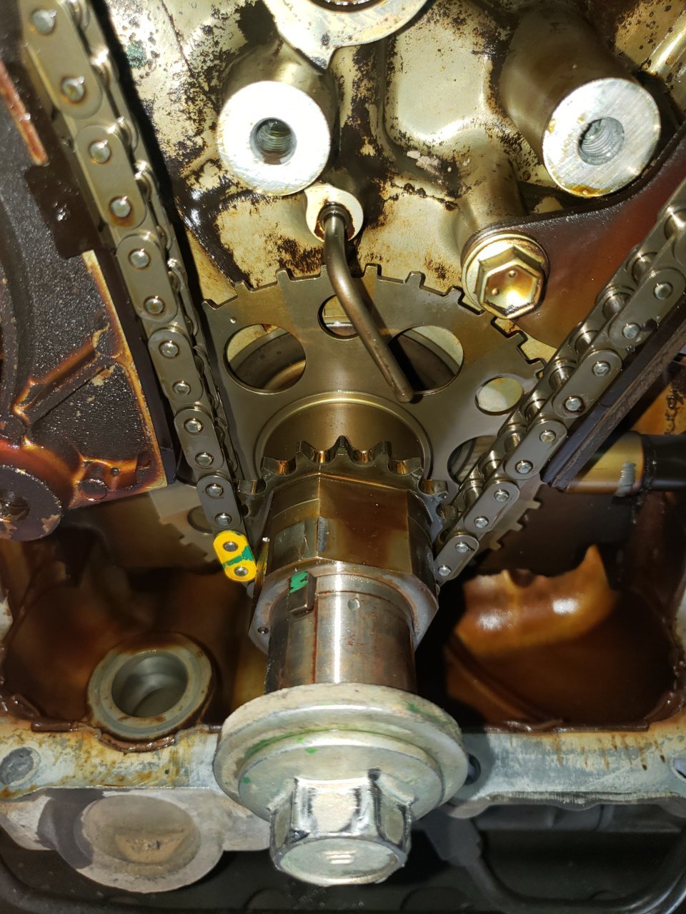

    ========== SPECIAL NOTES TO TAKE ============
    1. The right side intake cam is the only one that takes the half shell bottom. pictured*
    2. keep your cam bearings in order. Left and Right side.

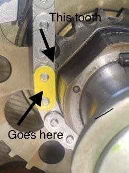

    3. make sure all your timing marks are EXACT! Even the bottom crank sprocket. i was 1 tooth off and had to redo.
    4. The water pump and the oil cooler DOES NOT need to be removed in order to remove the cover.
    5. Be patient. BREATHE. and label everything:fingerscrossed:
    YOU CAN DO IT!

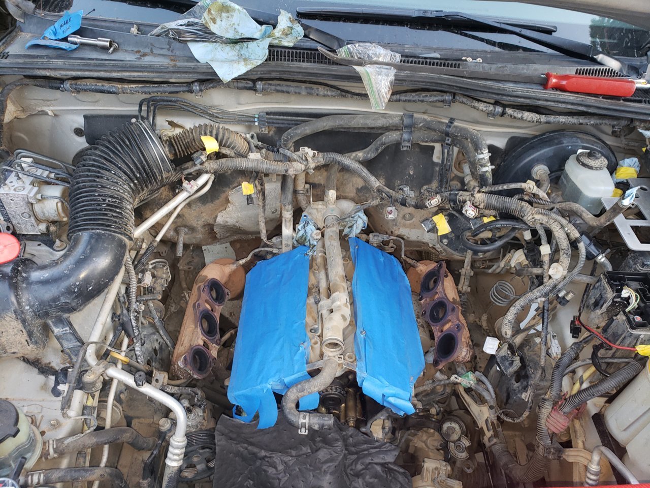

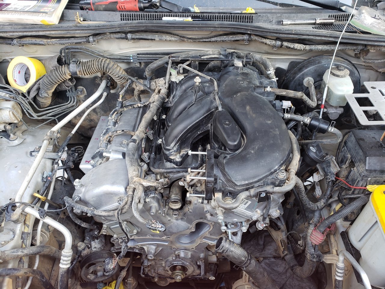

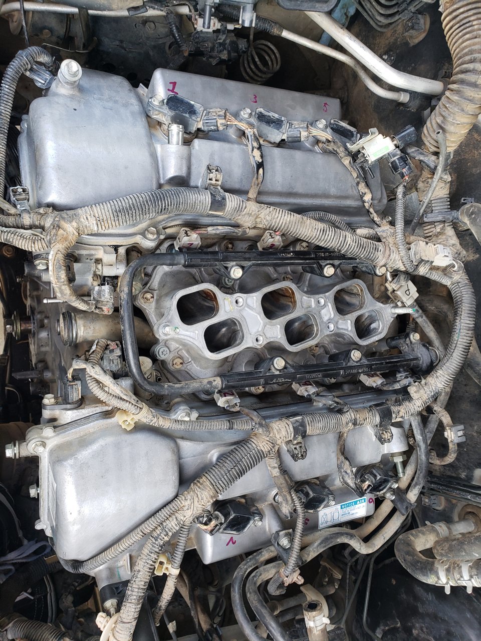

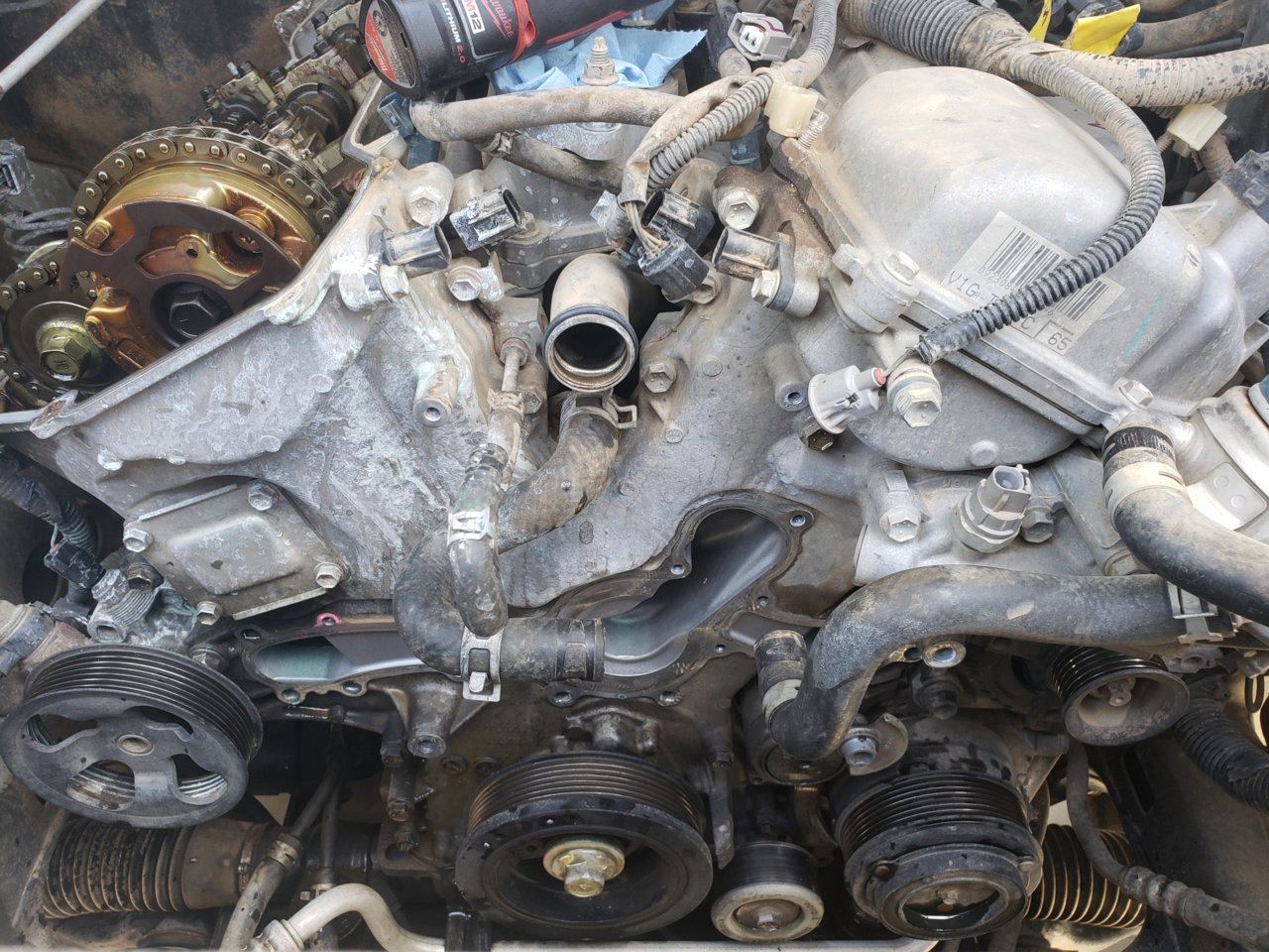

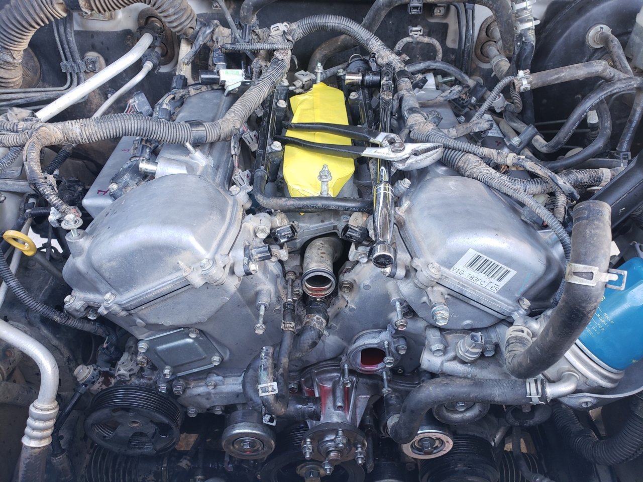

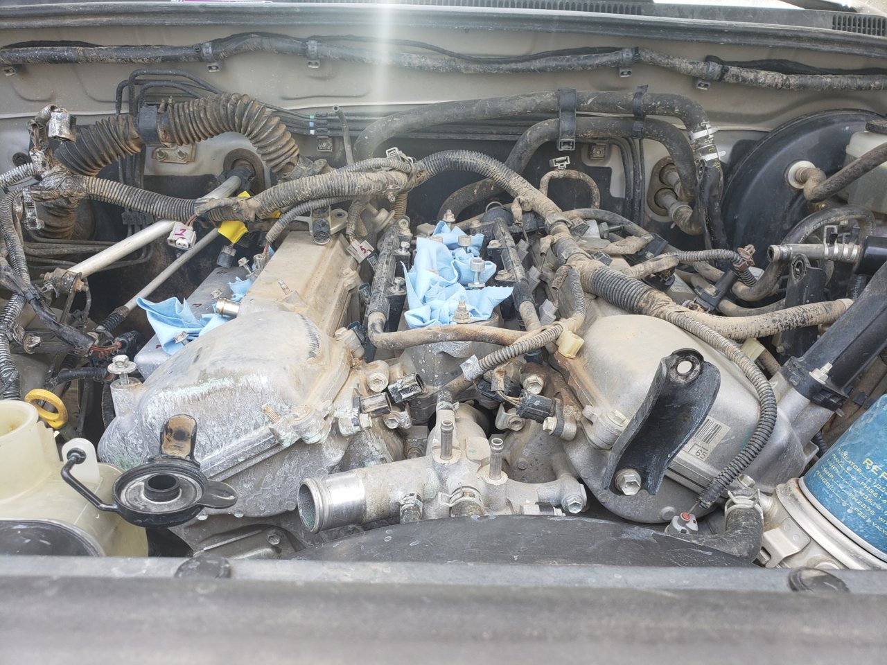

    Started the removal process today.
    PzTank likes this.

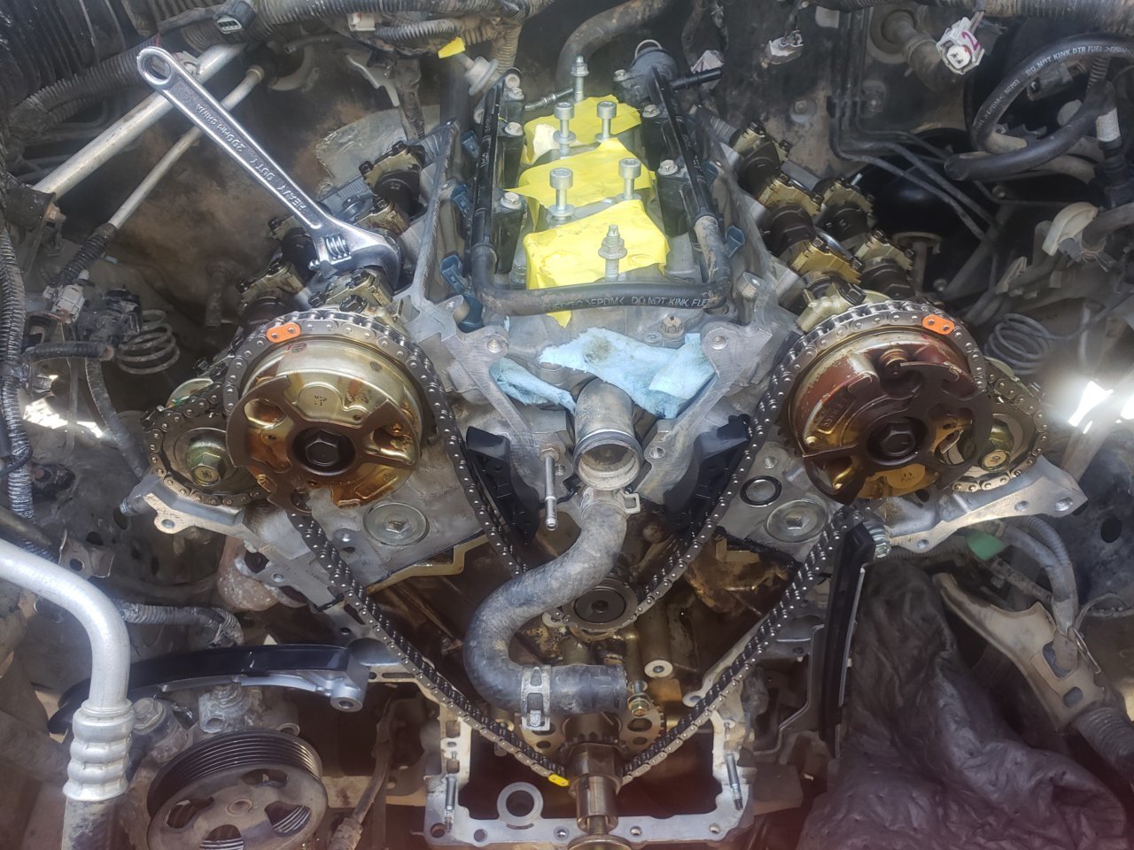

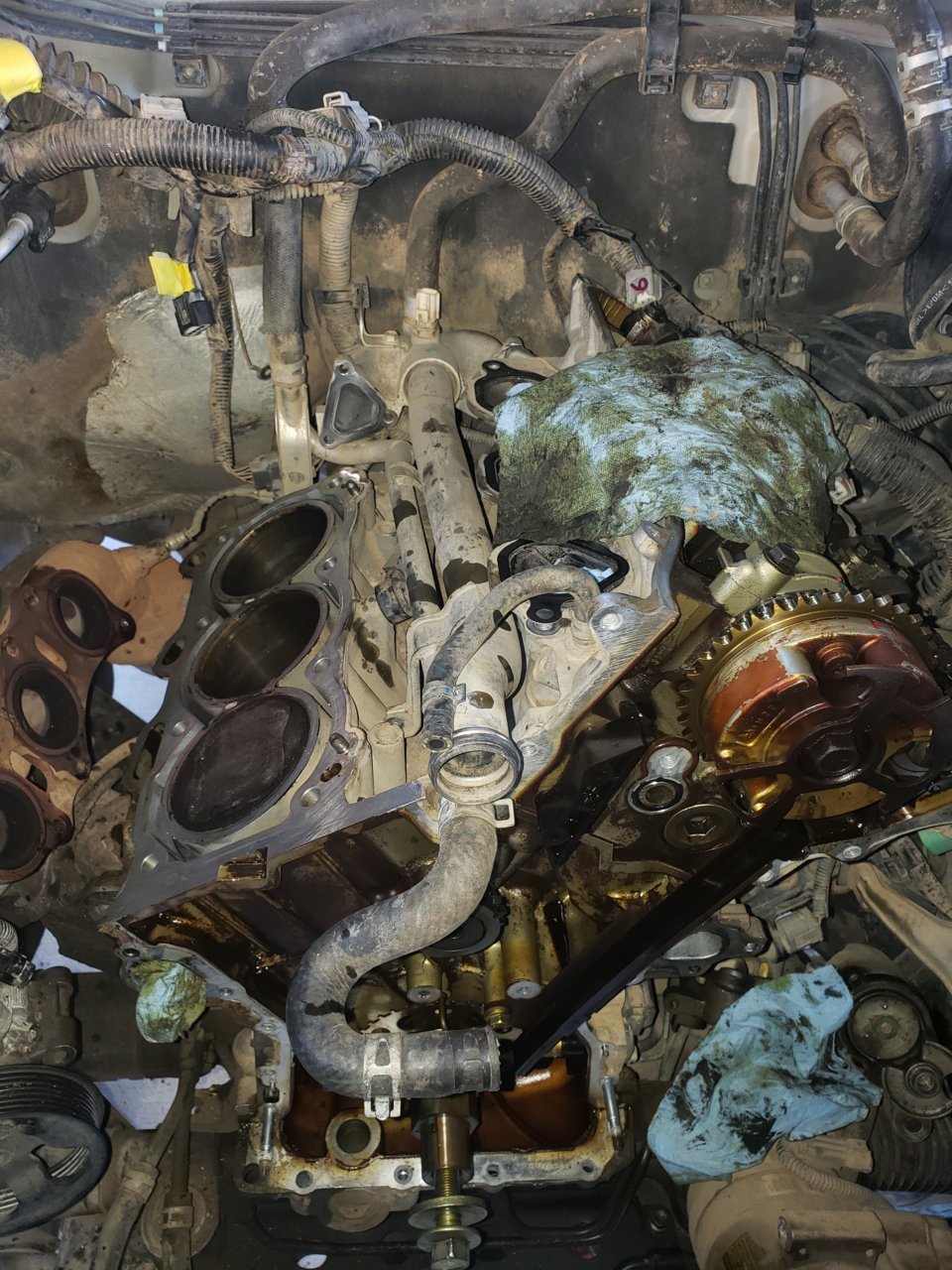

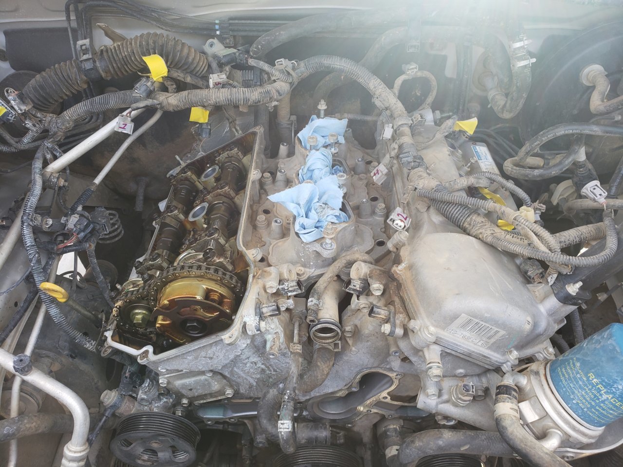

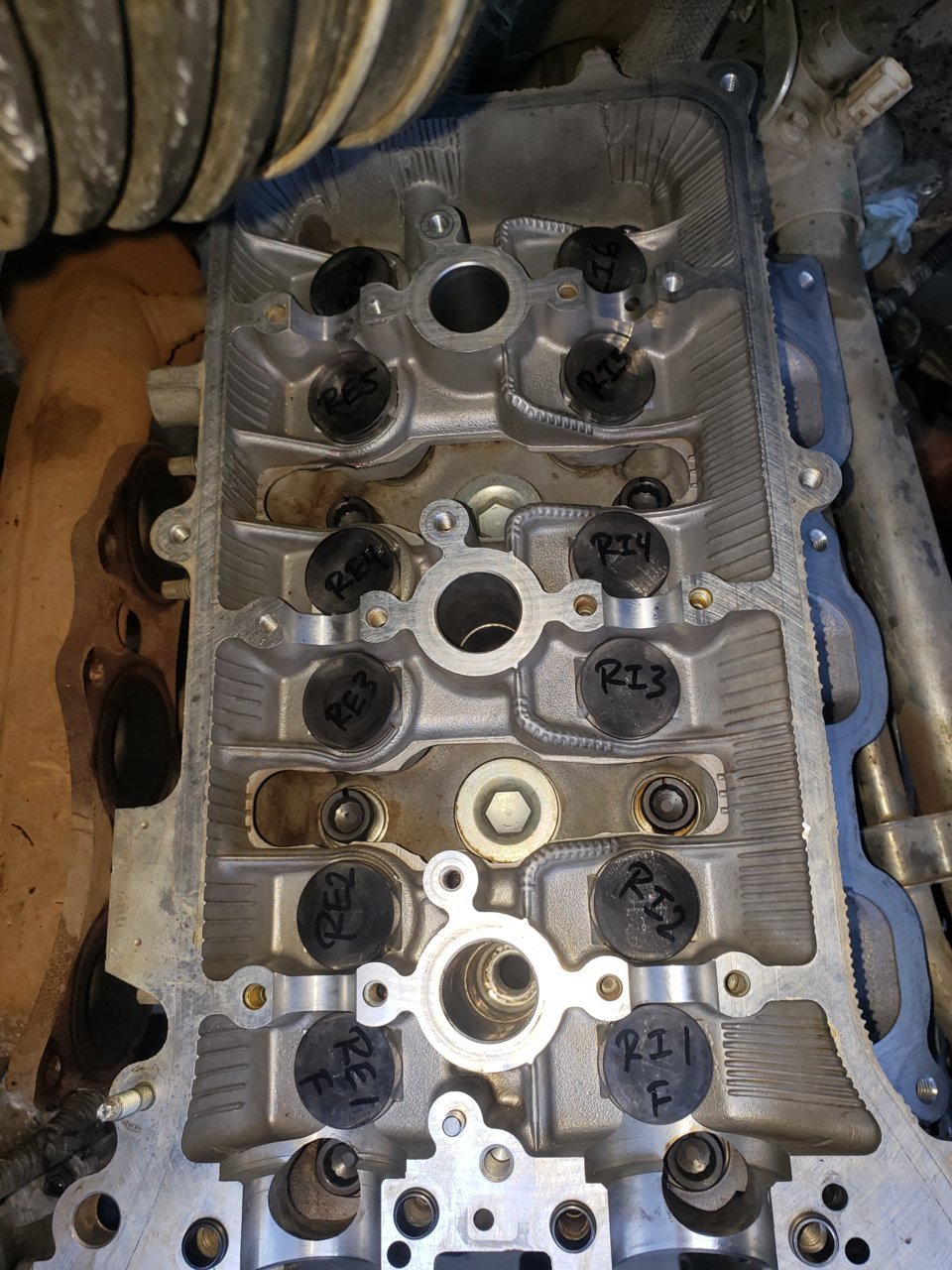

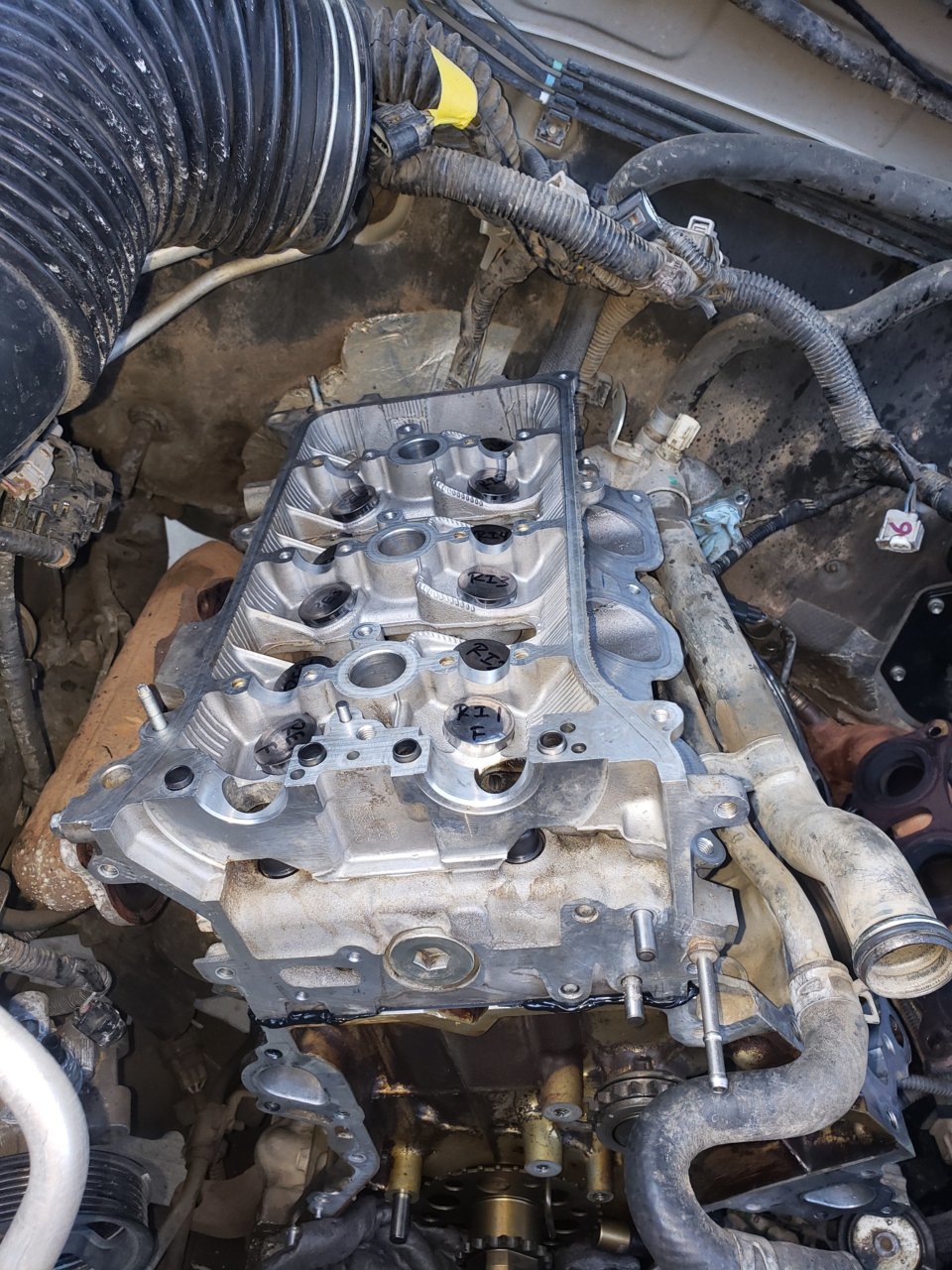

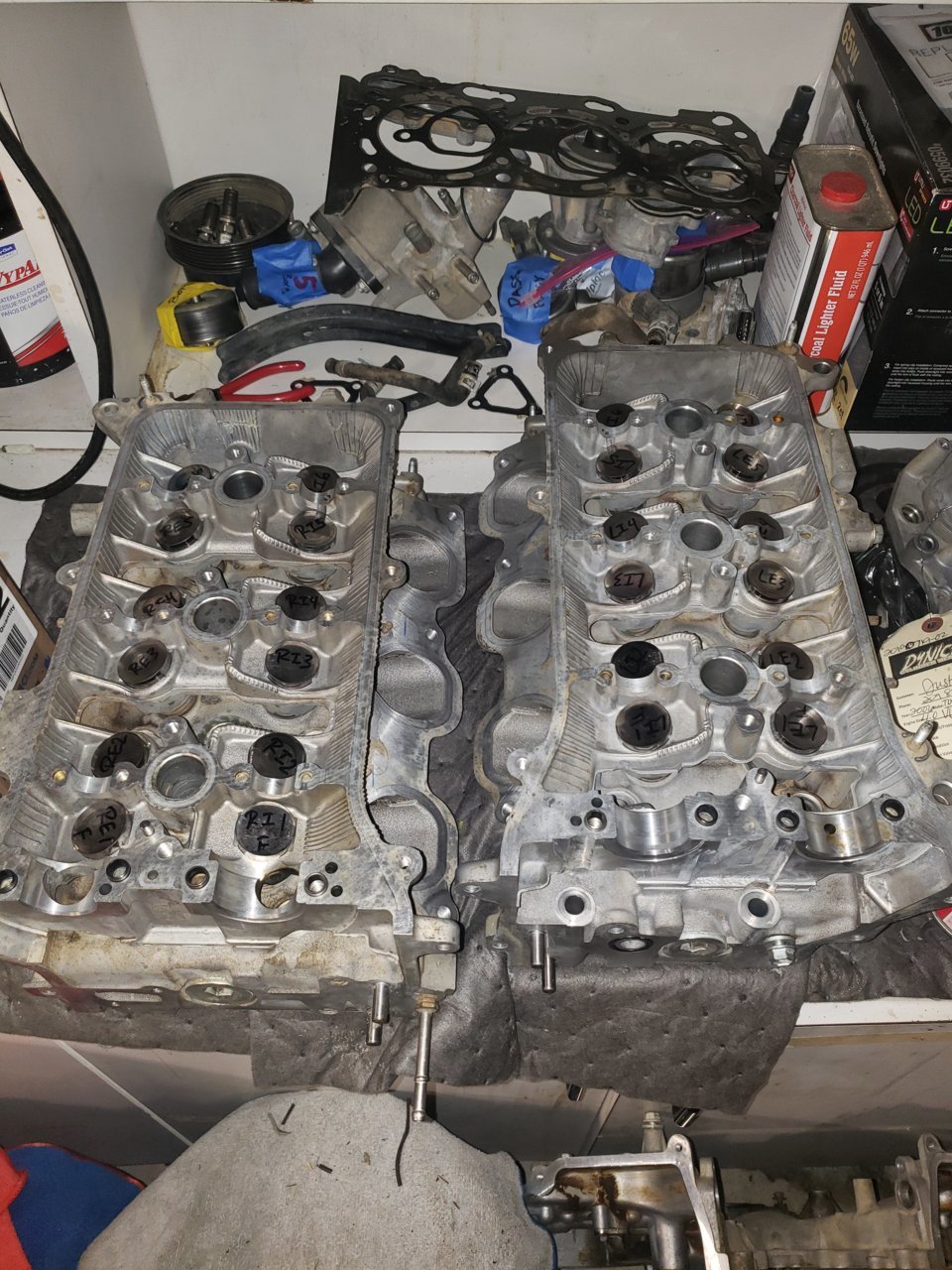

    Both head removed today.
    Progress...
    Will take them to be resurfaced in the morning.
