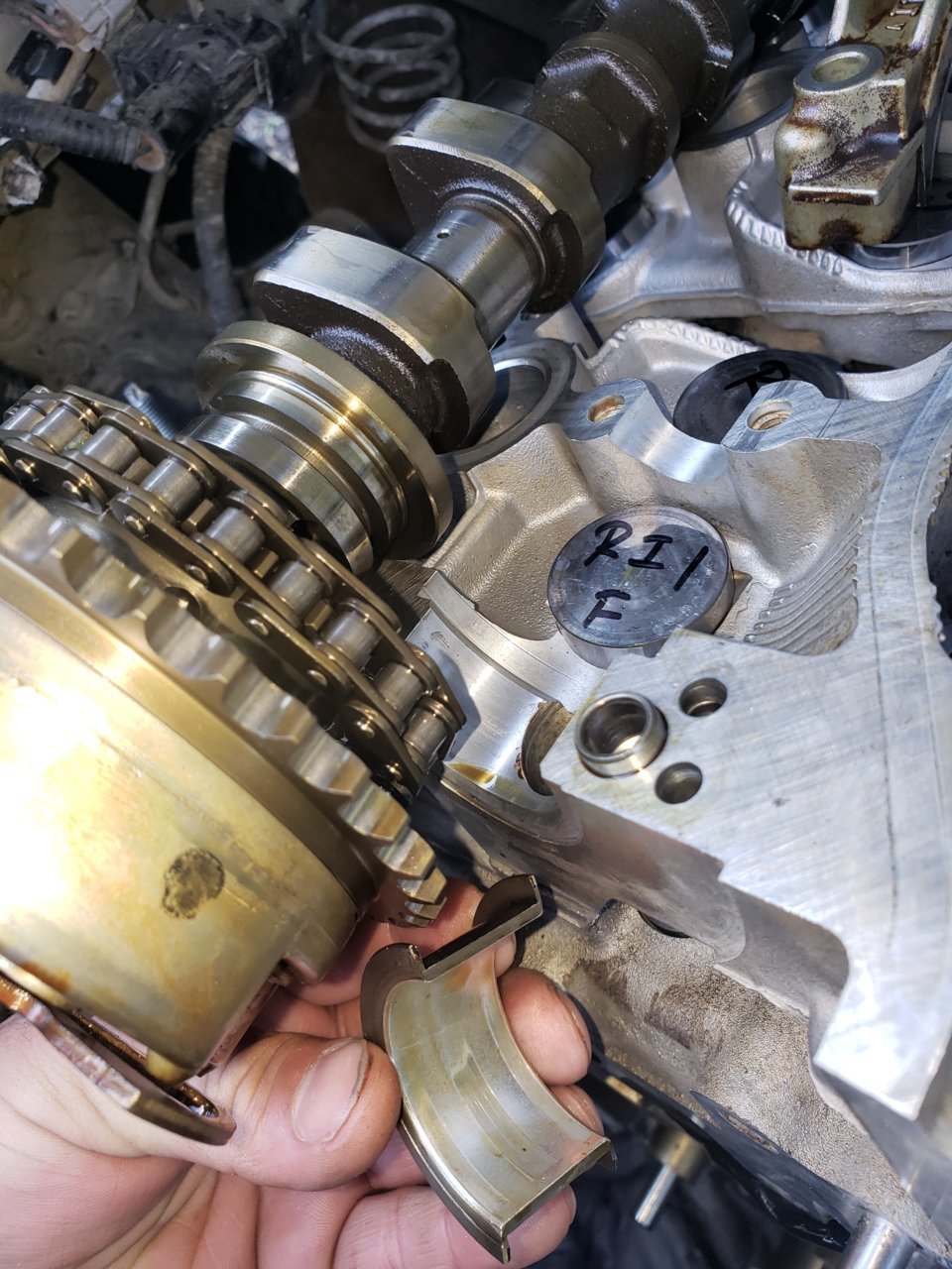

    Question:
    Installing my cams now.
    I found 1 sleeve.
    I'm guessing it goes on my exhaust cam.
    Does the other head need one as well.
    I'm guessing I misplaced it or accidentally left it on the head and sent it out to be resurfaced. ‍:facepalm:

    Confirmed with the shop foreman @ Tracy Toyota that only the right side intake cam needs it.

    That's strange. So the left side has no enlarged hole to hold one? I find people at dealerships can not form the words 'I don't know' with their mouths.
    edit: I suppose I don't understand. Doesn't the top picture show an alignment sleeve on both sides of all 4 end cam journals?

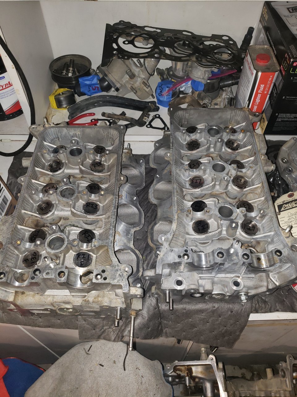

    These are the heads side by side.
    Left is the passenger (right)
    Right is the driver (left)

    I'm not sure as well.
    To me.
    Common sense would tell me all 4 cams need the bottom bearing half.
    But i guess not. :notsure:

    I thought you were talking about the alignment sleeves. Jeez, a 1/2 a shell.......
    Is the cam loose in there?

    I sort of see what you are saying. Where there is a cut out on all 4 cam ends where a bottom half would go?
    Looks like it to me.
    Parts was gonna sell me 4 bottom half sleeves. But talked to the shop foreman and then called back and said it's not needed.

    Not when I tighten the cams down.
