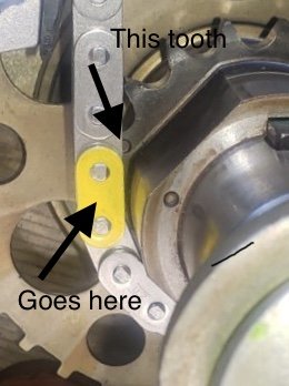

    Like this?

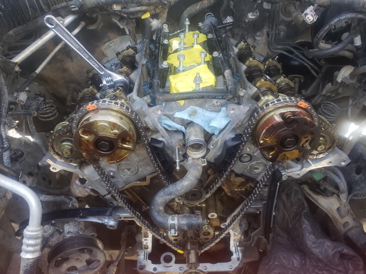

  14. Aug 21, 2019 at 2:04 PM
    #94
    DocME
    DocME Well-Known Member
    Aug 24, 2018
    #263956
    1,583
    California
    '07 FJ Cruiser
    TRD S/C, UCON, 61# inj, 2.5 pulley, 7th inj, Roostfactor Y Pipe, URD exhaust, WAT Nomad Valve body, Dana 60, DK LT, JD FAB LCA mounts, custom roof rack...and way too many others.
    https://www.youtube.com/watch?v=il9iR095teM
    Good vid for you. However, if you're seeing this on both banks it makes me think you could have been 180degrees out when you aligned the timing marks. How did you determine TDC?
  15. Aug 21, 2019 at 2:11 PM
    #95
    Justintheegreat
    Justintheegreat [OP] Well-Known Member
    Feb 20, 2015
    #149152
    539
    Northern CA
    06 DCSB Sport
  16. Aug 21, 2019 at 2:12 PM
    #96
    Justintheegreat
    Feb 20, 2015
    #149152
    539
    Northern CA
    06 DCSB Sport
    I got all 3 markings exactly on point.

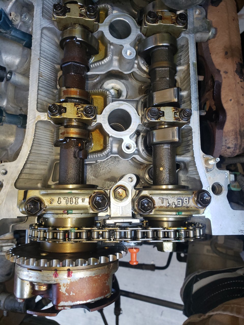

  17. Aug 21, 2019 at 2:15 PM
    #97
    Justintheegreat
    Feb 20, 2015
    #149152
    539
    Northern CA
    06 DCSB Sport

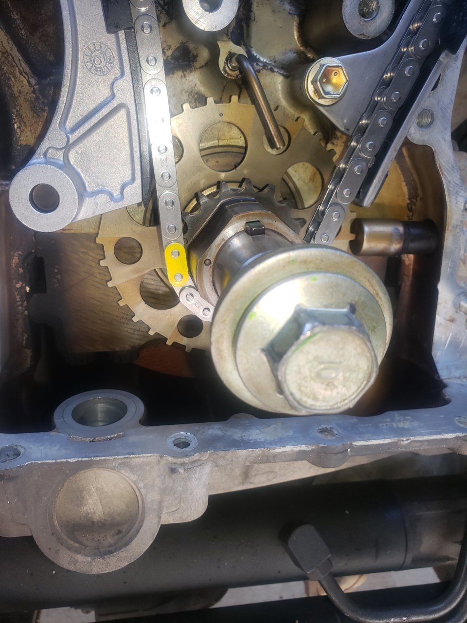

  18. Aug 21, 2019 at 2:19 PM
    #98
    DocME
    Aug 24, 2018
    #263956
    1,583
    California
    '07 FJ Cruiser
    Did you put your finger on number 1 spark plug to ensure it was coming up on the compression stroke?
  19. Aug 21, 2019 at 2:20 PM
    #99
    Justintheegreat
    Feb 20, 2015
    #149152
    539
    Northern CA
    06 DCSB Sport
    Unfortunately no. I had my flashlight in there and checked it. After the chain was on.
    It takes about 5 full turns just for all the markings to match back up. That's the chain markings and all the cam markings.
  20. Aug 21, 2019 at 2:23 PM
    #100
    DocME
    Aug 24, 2018
    #263956
    1,583
    California
    '07 FJ Cruiser
    I'm no expert, but I think your main timing chain is 1 roller off (retarded).
