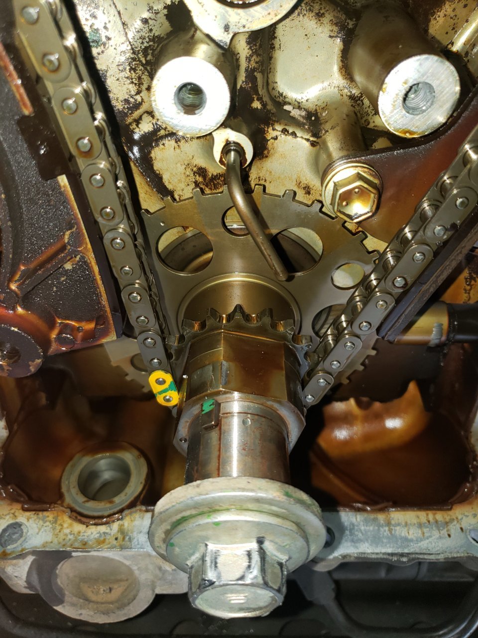

    Justintheegreat
    Justintheegreat [OP] Well-Known Member
    Feb 20, 2015
    #149152
    544
    Northern CA
    06 DCSB Sport
    I actually found a picture of my #1 cylinder at TDC.
    all I did was align all my markings back. And aligned the new chain.

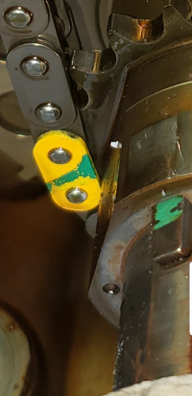

    Damn I thought it matched up to the other mark.

    Yup. This is the old chain.

  5. Aug 21, 2019 at 4:19 PM
    #105
    Justintheegreat
    Feb 20, 2015
    #149152
    544
    Northern CA
    06 DCSB Sport
    Well. :bananadead:
    I'll just go back and cry now.....
    LoL
    Time to redo it all. Live and learn.
