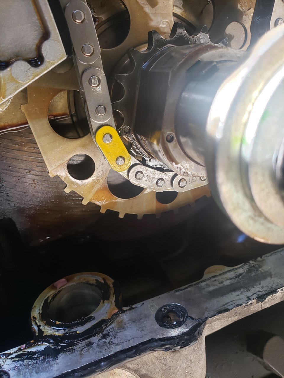

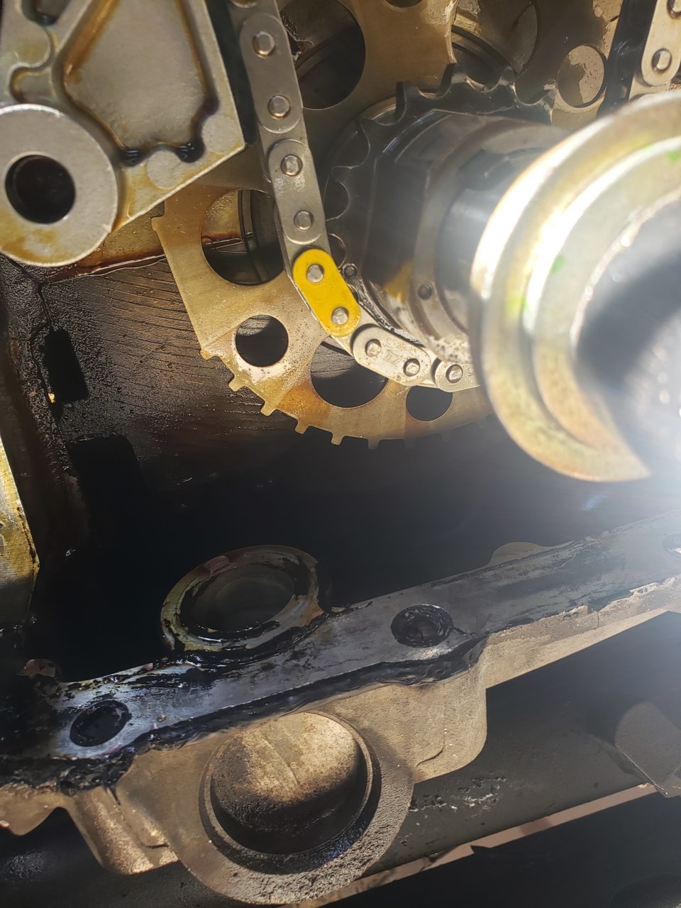

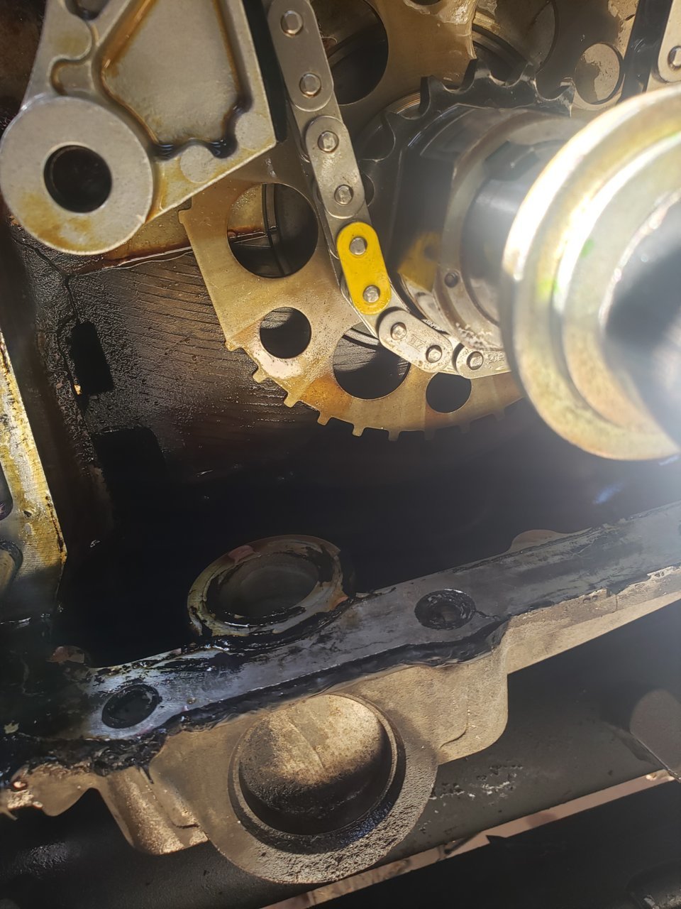

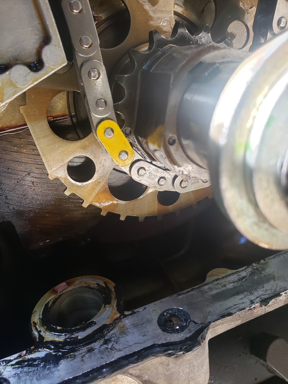

    I think we found my issue.
    If you look back up. I was 1 tooth off on my crank gear and my chain.
    @DocME found my issue.

    Now I'm gonna try and reset everything to DTC and triple make sure all my timing is 100% on point. If this doesnt work then I'll come back and post on here.

    I plan to upload all these photos in order as well.

    All lined up this time.
    Take #2

    No this is take #2. I lined it back up.
    The 1st time it was off like you said.
    So I lined up the timing Mark's again to TDC.
    then lined the bottom chain up with the marking on the crank.
    So we should be good.
