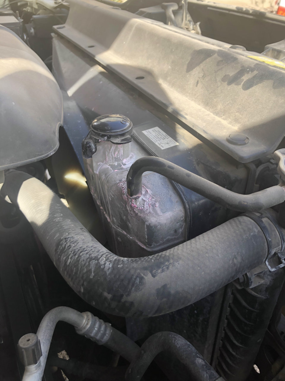

    I did a coolant swap a few months ago. Fairly recently, i've noticed a gurgling sound from behind the dash on start up and sometimes on acceleration. I just checked under the hood and noticed that not only am I low on coolant, but there's some dried coolant around the reservoir cap. My truck has never overheated since i've owned it and there's never been any visible coolant leaks. I also haven't noticed any burning coolant smell. My truck has a little over 204k on the odometer and i've heard that around this mileage the 06's have been known to have head gasket issues. I also have the 4.0 V6, Any thoughts? I'm headed to the dealership tomorrow to pickup some coolant and will try to bleed any excess air out of the cooling system and see if that helps. I might be taking her in to the dealership whenever they have an opening to see if its a head gasket issue if the coolant continues to leak.

    Set up an appointment with toyota to have them check it out next week. In the meantime I bought some toyota brand coolant and topped off the reservoir, and let the truck run for about 30 minutes with the heater on full blast and the reservoir cap off. All i noticed was a small bubble every 5 seconds or so, that continued after I turned the truck off. I marked the coolant line with a sharpie so I can track if it continues to drop.

    Also here's a pic of what the coolant reservoir looked like before I topped it off today. IMG_8595.HEIC.jpg

    Looking at the pic, you may need to put a hose clamp around the tube to make sure it’s not leaking, or better yet just replace the hose.
    I had a bit of dried pink crust around the hose going into that reservoir and that cause mine to drop low, not to the extreme yours is, but I put a small host clamp around that and it seemed to fix it. You might be able to use a zip tie as well.

    Check your radiator cap. Could be coolant boiling in the reservoir because the system can't keep pressure. Had a similar looking issue on my girlfriends subaru and a new cap fixed it!

    Check your reservoir for any cracks and replace if it is damaged
