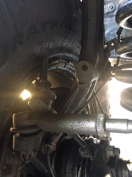

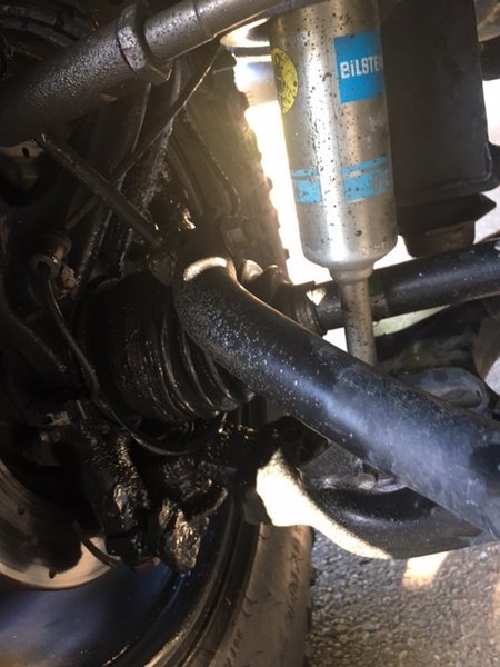

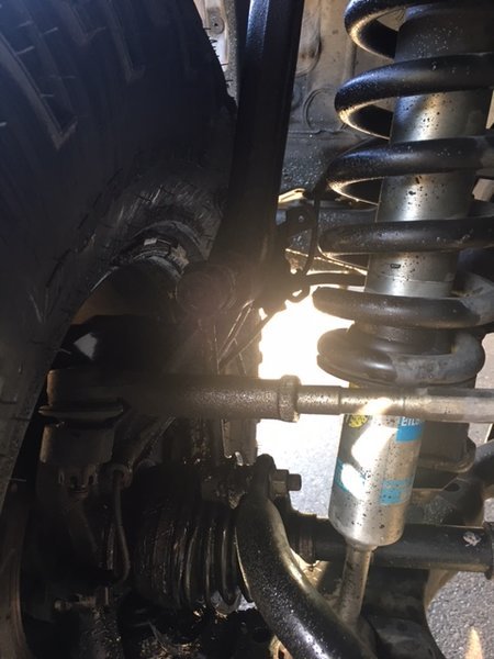

    Hi All,
    several years ago had 4wheel p[arts install pro comp lift.
    today as i drove into driveway my roomate says wtf is that?
    appearently sway bar extention somhow came unscrewed from drop spindle and ate up boot.
    dont know what to do from here...... yes agreed not a lift professional so dont kick the nuts too hard. thanks!

    If you're brave or crazy, you could just go without a sway bar. Or you could buy a new end link + CV axle and install yourself/bribe a TW buddy with frosty beverages to help. Either way, good research and the right tools and it can be done in a couple hours.

    I would personally just replace the cv axle and remove the sway bar.

    the sway bar end link somehow came unscrewed.... no nut on end it screws into drop spindle.. do you guys think i be ok without sway bar?

    I've been running with no sway bar for a few months. I'm not sure if a 6 inch is extremely different. Also, aggressive driving can be a bit scarier without sway bars.

    no sway bar means you get to slow down and not take corners fast.
    The new axle is 30 minute job. Don't go cheap get OEM and you will need a 32 or 35 mm socket (look it up or call Toyota)
    Removal of sway bar is maybe 10.
