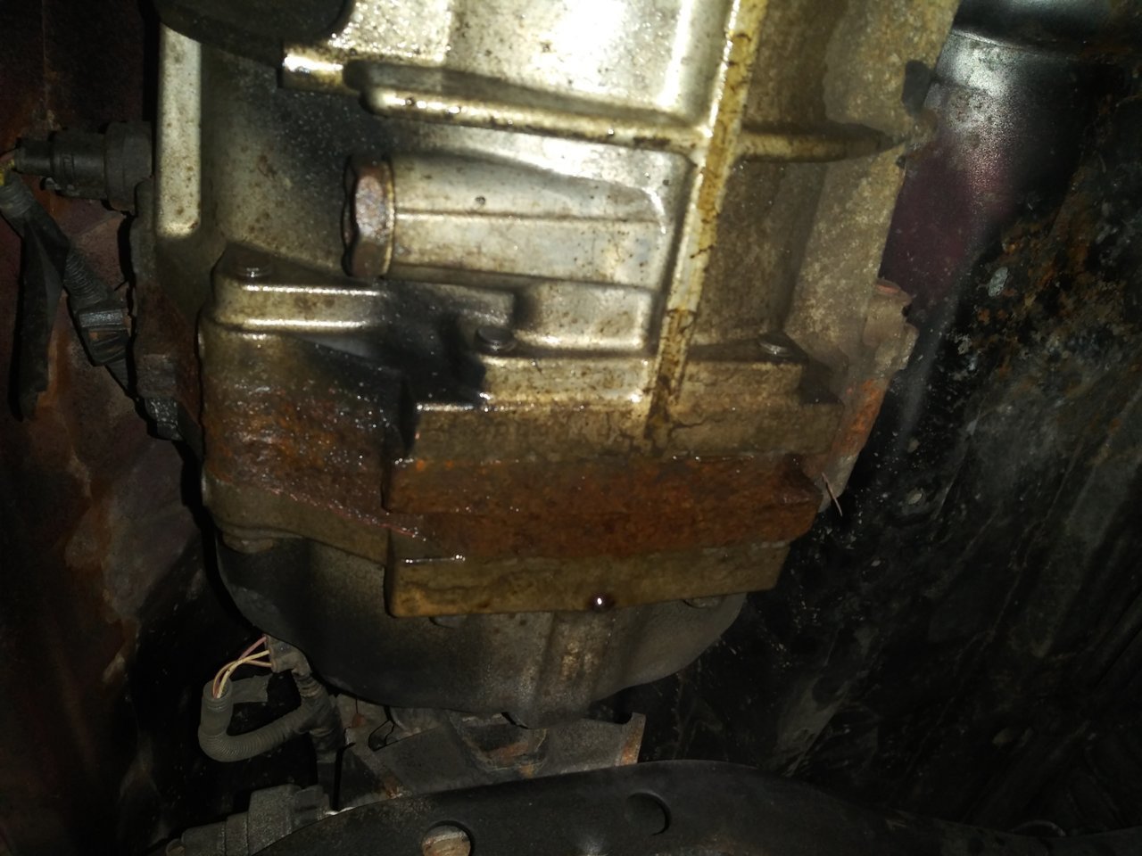

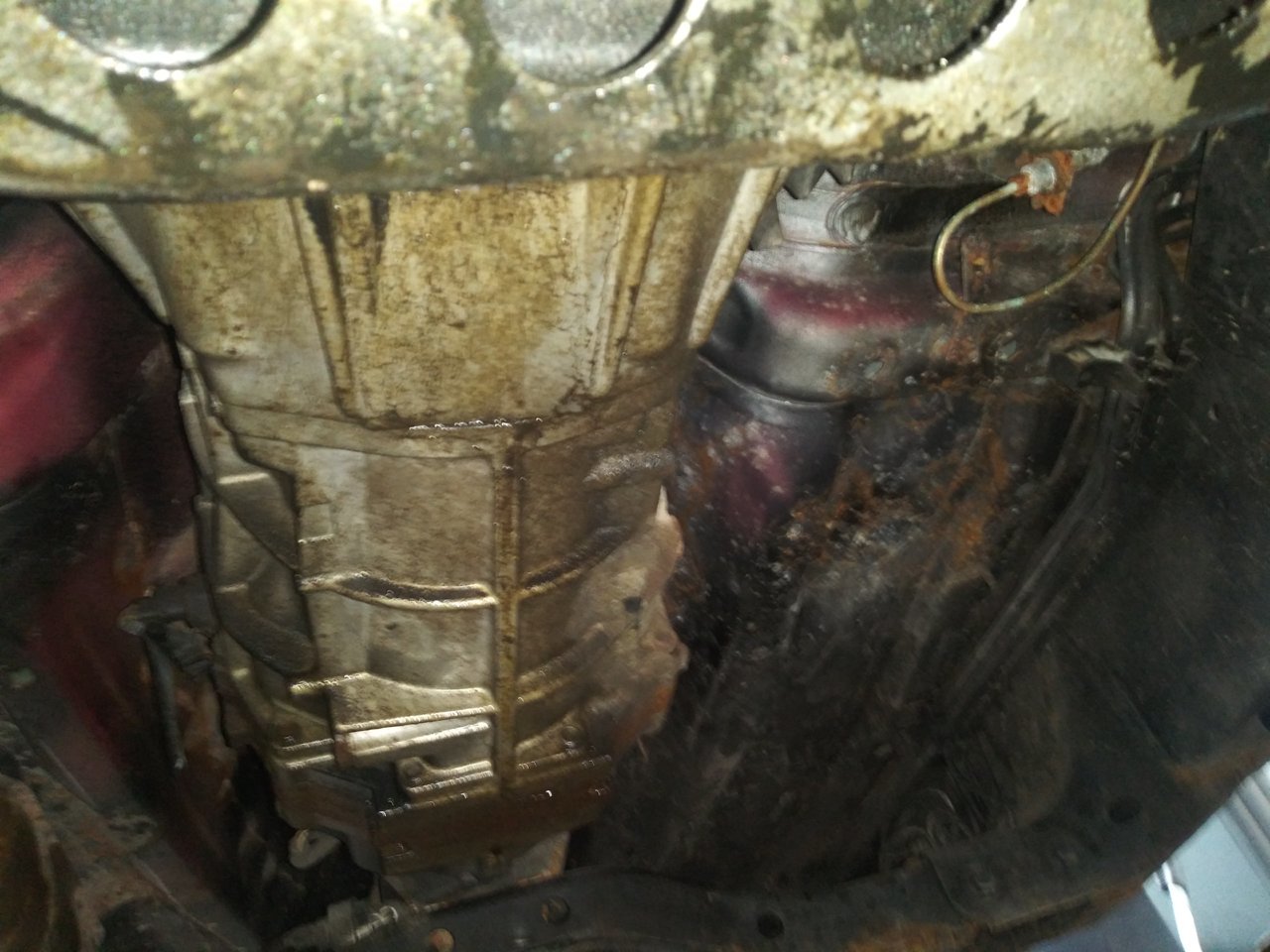

    Hello everyone
    New member, first post. Looking for some help/advice.

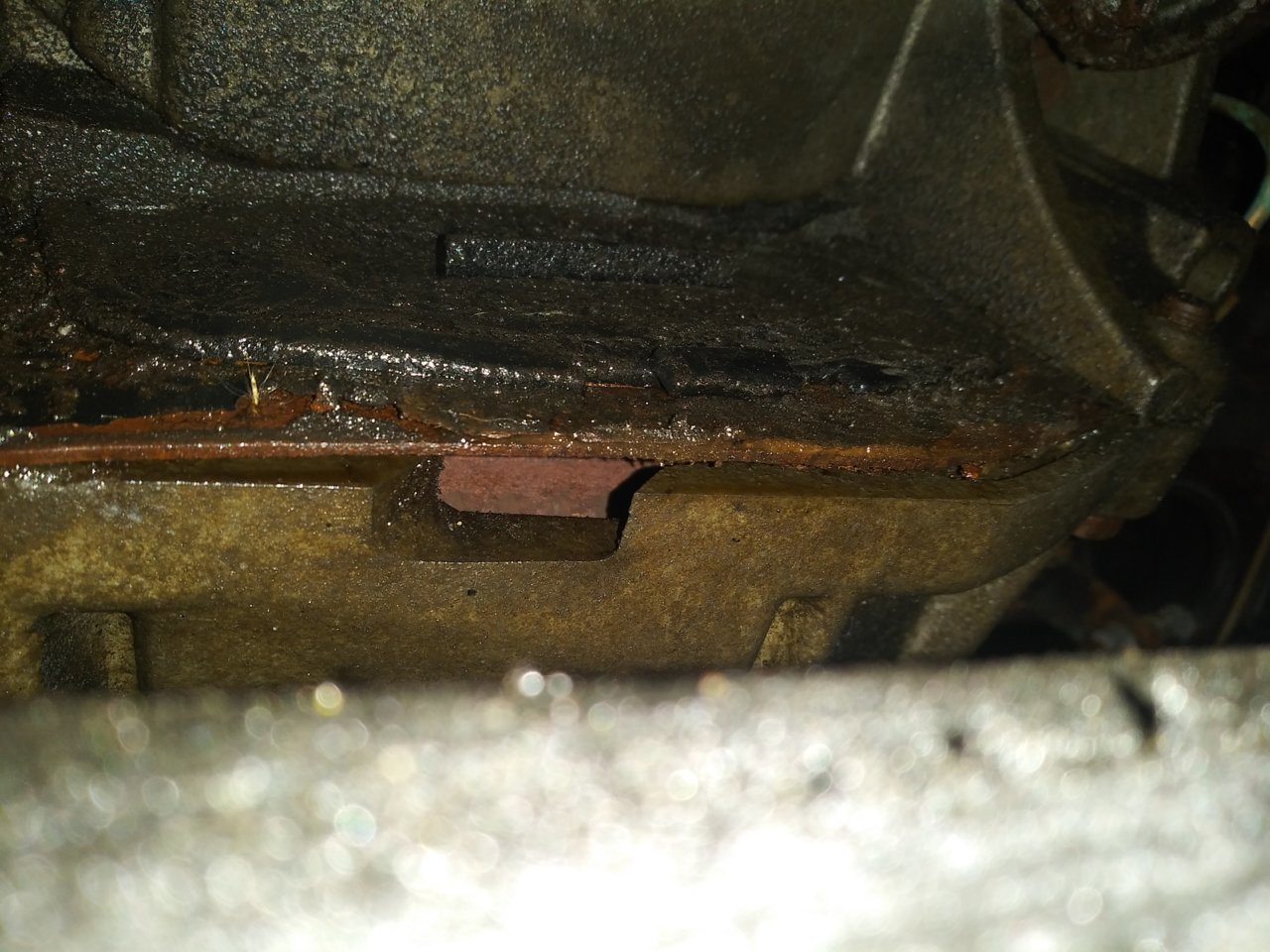

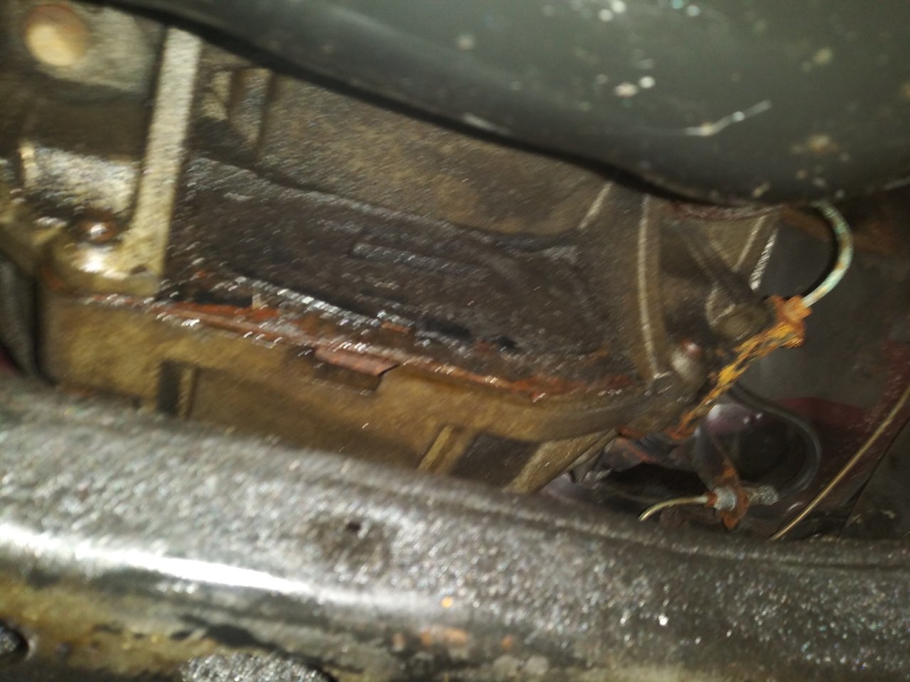

    Ive noticed my tacoma has an oil leak. I jacked up the truck and took a look underneith. It looks like the gasket between where the engine meets the transmission is wet with oil. When i went to touch, the part of the gasket crumbled apart and fell off. It looks as if this is where the oil leak is.
    What do you guys think? Assuming this is the problem, what would something like this cost to fix? Is it even worth fixing, assuming the tranny would need to be dropped. The tacoma is a 2006 with only 83k miles.

    Rear main seal Id say no question. You'll have to drop the trans. Depends who you are if it's a big deal. That leak looks pretty bad so you may or may not have to replace other stuf.
    It's definitely worth fixing If the truck is good.
    I would fix asap

    what gasket fell apart?
    there is no gasket there.
    is it a plastic inspection plate for the torque converter bolts? thats what the picture looks like, I have a manual so I dont know.
    if its a plastic inspection plate you can take the plate off and look inside, if its dry in there they oil may be coming from the Valve covers and dripping down the back of the block.

    they are saying the rear main seal. it is up above that seam. back of the motor. where the output shaft comes out.
