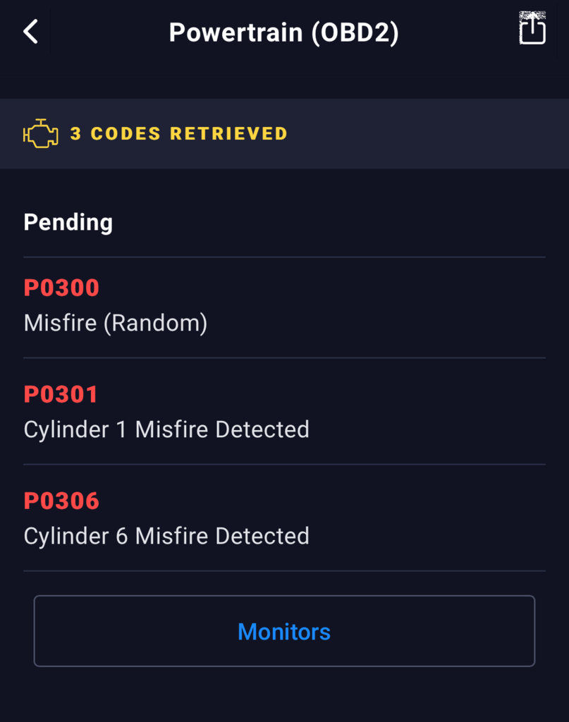

    2006 Tacoma Off Road
    I swapped #6 coil with #1 and am still getting the misfire code. I even swapped a used coil in #6.

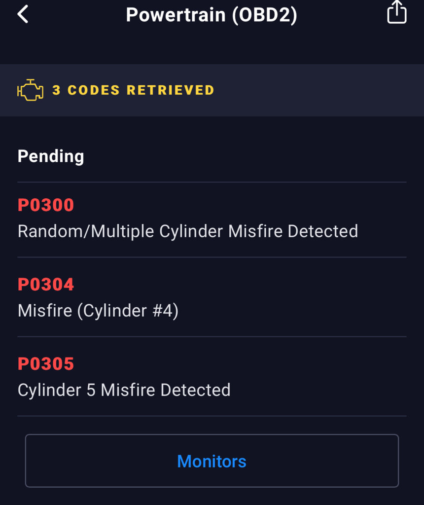

    I swapped coils, one and five, now getting misfire on 4 and 5. Wack-a-mole!

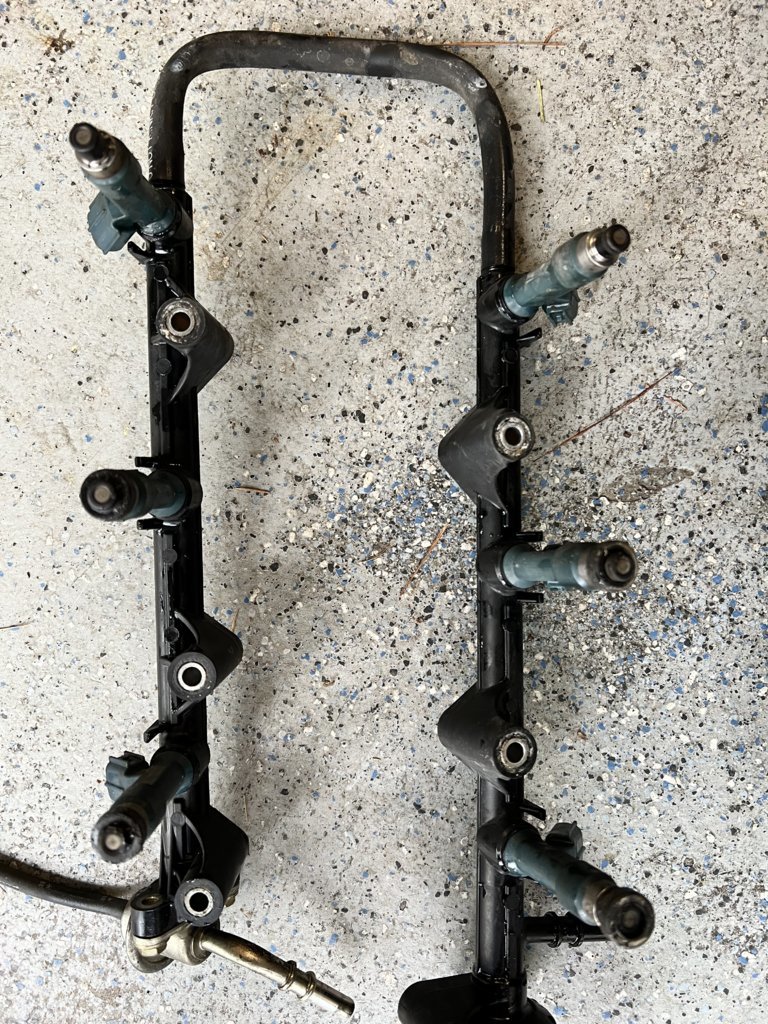

    I just removed the fuel injectors. It looked pretty dirty to me, but, I’m no expert.
    Waiting on them to be delivered. I did take off the fuel rail and clean the injectors. There were a couple that with broken gaskets stays.

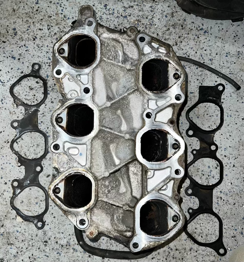

    Scott
    I've ordered some lower/upper gaskets. Hopefully it'll be running again once the injectors arrive.
