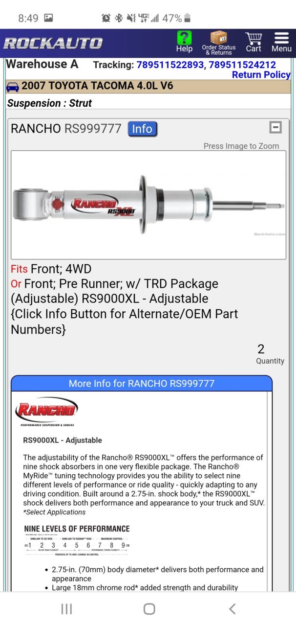

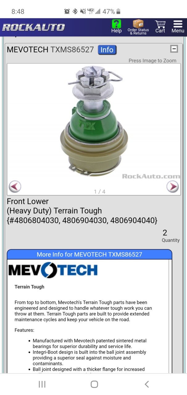

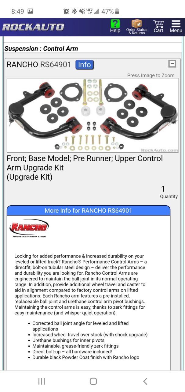

    I'm replacing my wheel bearings, while I've got it apart, I decided to swap out the UBJs since one of them tore a while back. Made the impulse buy for some Rancho upper control arms and struts - at least this will save me the trouble of pressing in the UBJ to the UCAs. I went with the Mevotech LBJs. Does anybody here have experience with these parts? I'll post a recap once I get it all put together. Screenshot_20190904-204909_Chrome.jpg Screenshot_20190904-204855_Chrome.jpg Screenshot_20190904-204926_Chrome.jpg
    ***UPDATE***
    Mevotech LBJ have shit the bed after two years. I don't recommend these ball joints.

    No experience with those parts you show. I just did mine LBJ like 2-3 weekends ago but used Autozone stock. Never had issues with their stuff.

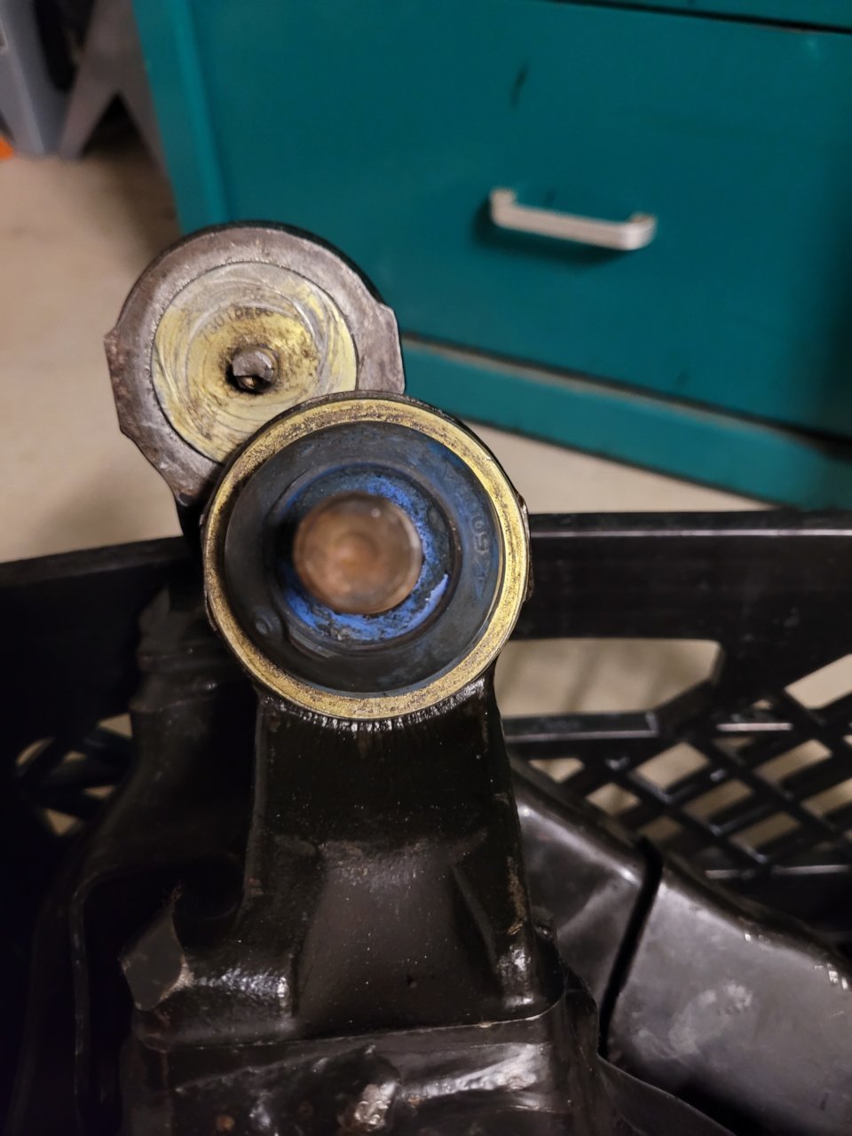

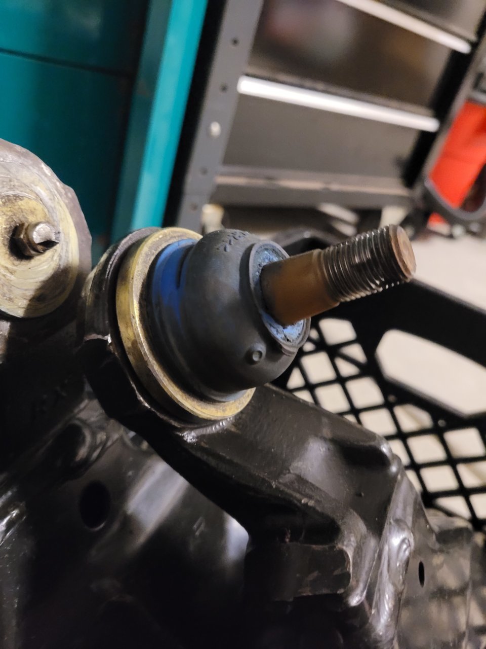

    Question for you all. I had to replace my Tie Rod end and Sway bar link due to the boots being cracked and torn. While doing that I thought to inspect the ball joint really good since my truck is at 124K. I took things apart and have it down to what you see below. The boot looks to be intact, no up and down play or grinding of any kind when I move it around by hand and it didn't have the up and down play when the wheel was on either. I am thinking it might still be good but It does however, move around easily with just two fingers. It is not stiff at all. Would this constitute replacement?

    Id probably replace it sooner than better. Mine were easy to move around and then gave out making a creek noise. It’s easier replacing the entire arm but if you have time to do just the joint then I’d go for it

    I agree, I really want to change them out but I am literally out of money right now. They are not squeaking, popping or grinding so I am just gonna have to use them till I save up to buy OE Arms and ball joint assemblies.
