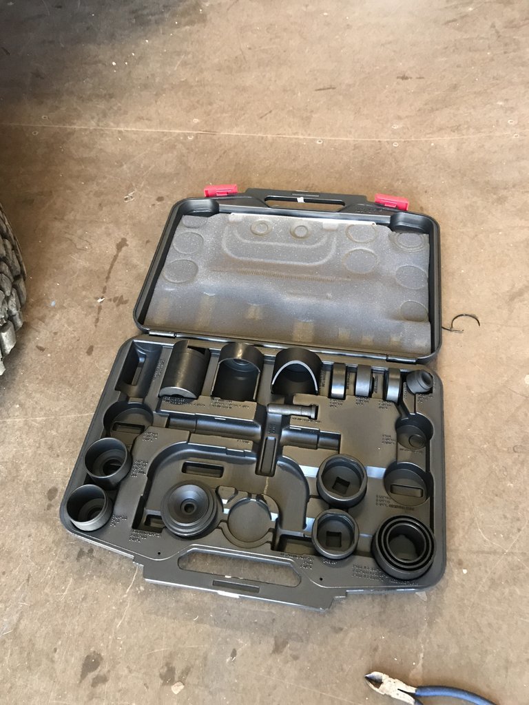

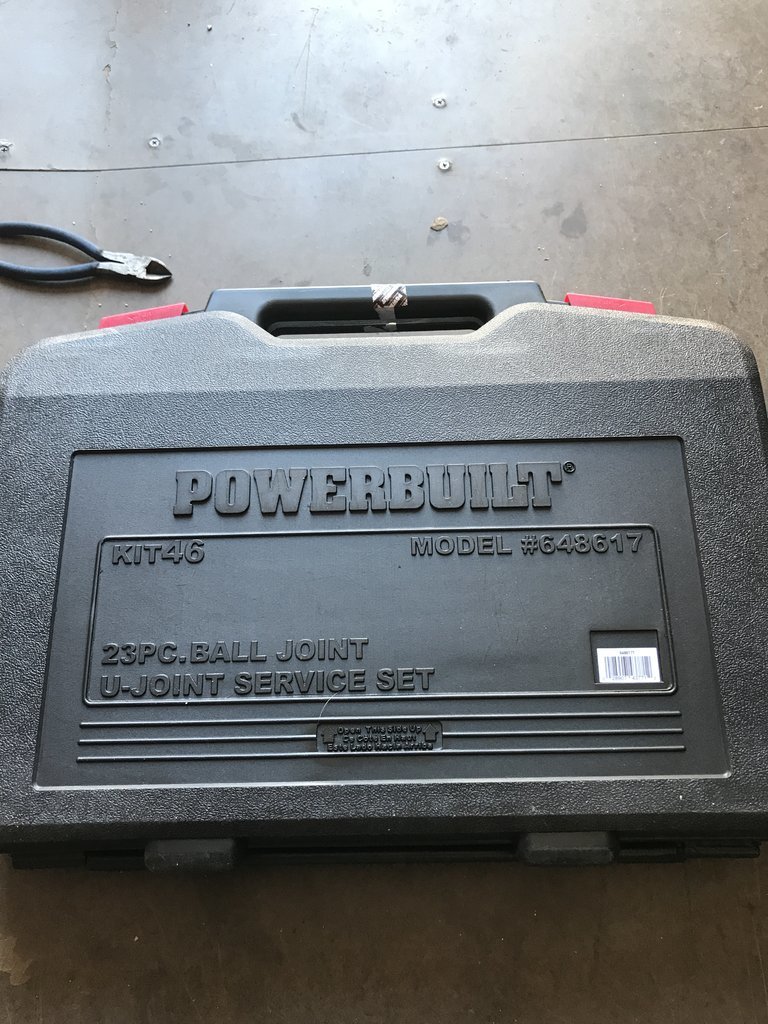

    I went to the local auto parts store and borrowed the Ball Joint/U Joint Tool Set.
    You have to deposit the money (AutoZone about $200) and you get that back when you return the kit. You Definitely Need This Kit! It would have been a nightmare without it...

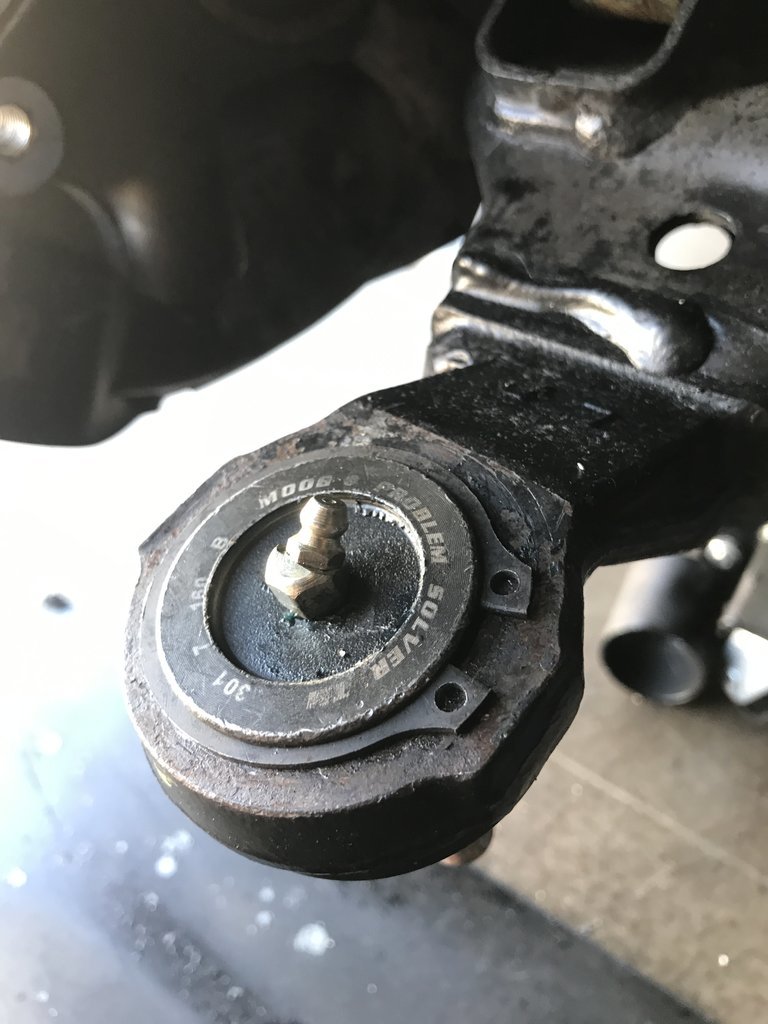

    -You'll need to remove the snap ring, I used a couple of flat head screwdrivers and a hammer and... it was a little tricky and I was cussing at this point. :angrygirl:

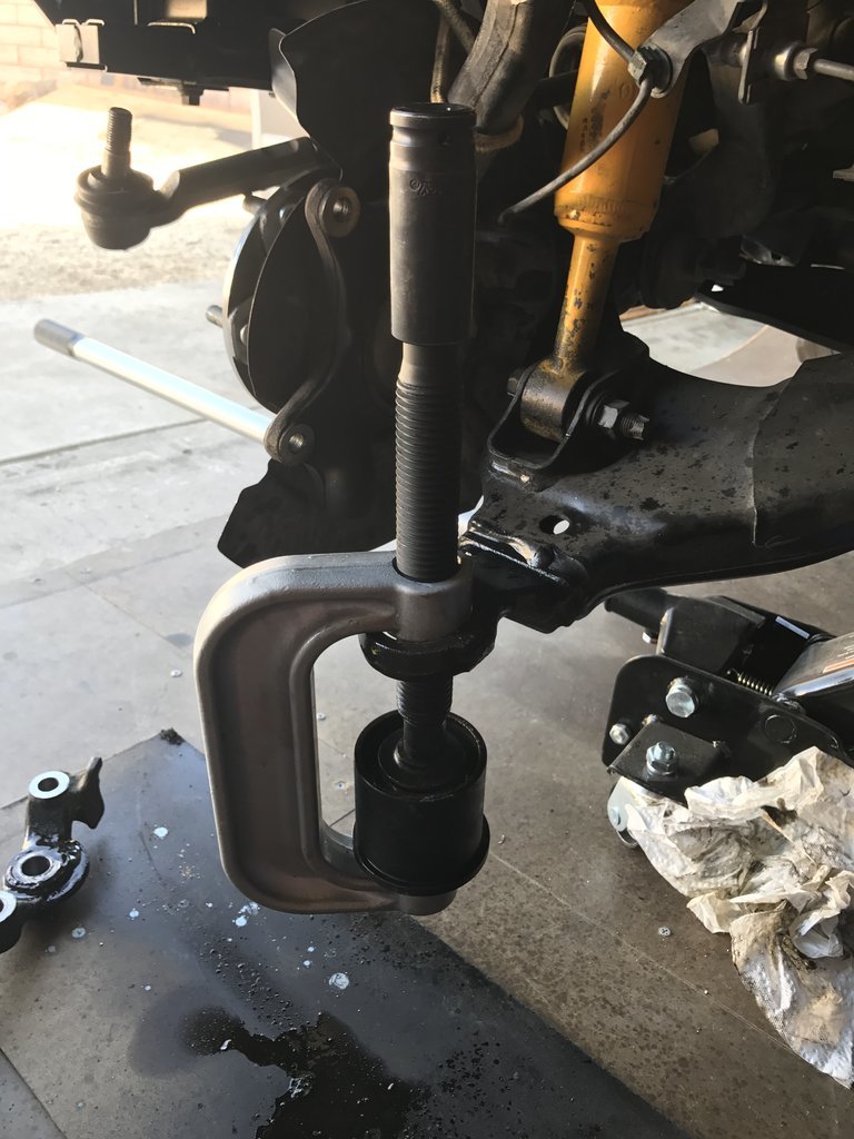

    -Now you're ready to use the Ball Joint tool. You will have to find the right sizes and may need to mix and match pieces to find the correct set up to push the joint out. I used my impact to torque the press and pop the joint out and it dropped without too much resistance... you have just finished with the easy part. :bowdown:

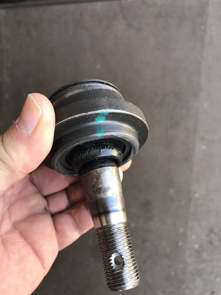

    -Time to put your new Moog ball joint in!
    -There is a mark on the new joint that needs to be pointing toward the engine (refer to your Moog intstallation guide)...
    -Again, you will have to mix/match pieces from the set to find the right set up...
    *IMPORTANT*
    -Make sure that as you get your new Joint started on its way into it's new home that you start it off level & even with your control arm. If you are "off camber" on this the joint will go in crooked and you will have to pop it out and start again (I did this twice before getting it straight :facepalm:take your time and get it right)...
    --Might make a note here that you should wipe out and clean all of your holes, parts, threads, armpits, balls/gina, asscrack, etc...

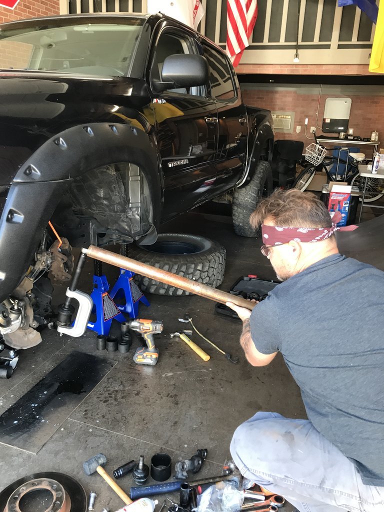

    -This was the most difficult part of the job, getting the joint started straight and then seated... I used my impact on the press to get the Joint in as far as possible, my impact was definitely put to the test as she was heating up and struggling once past the halfway point... This is where I broke out my big ratchet & cheater bar! :muscleflexing:
    I was lucky to have some pipe laying around (you might want to find suitable cheater & ratchet/breaker bar before you begin)... This took some effort and elbow grease to finish seating the joint...
    -Once your confident that the joint is seated you should be able to get the snap ring in place (be sure the ring is seated by tapping around it with screwdriver to be sure it's fully seated in the groove) the hard part is over and you're now ready to screw on the zerk and reassemble... :yay:

    -Ball/U Joint Set (I like AutoZone’s)
