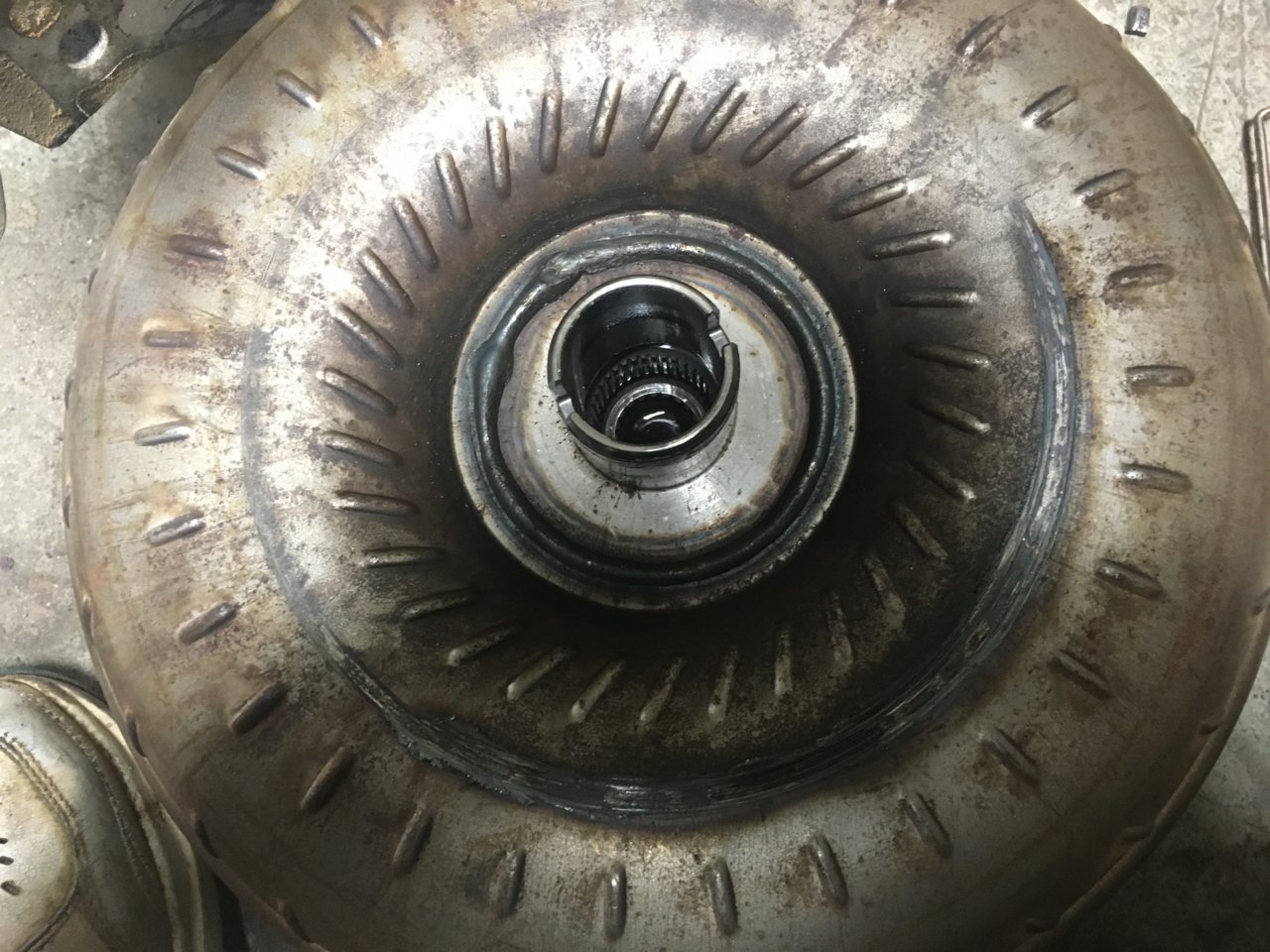

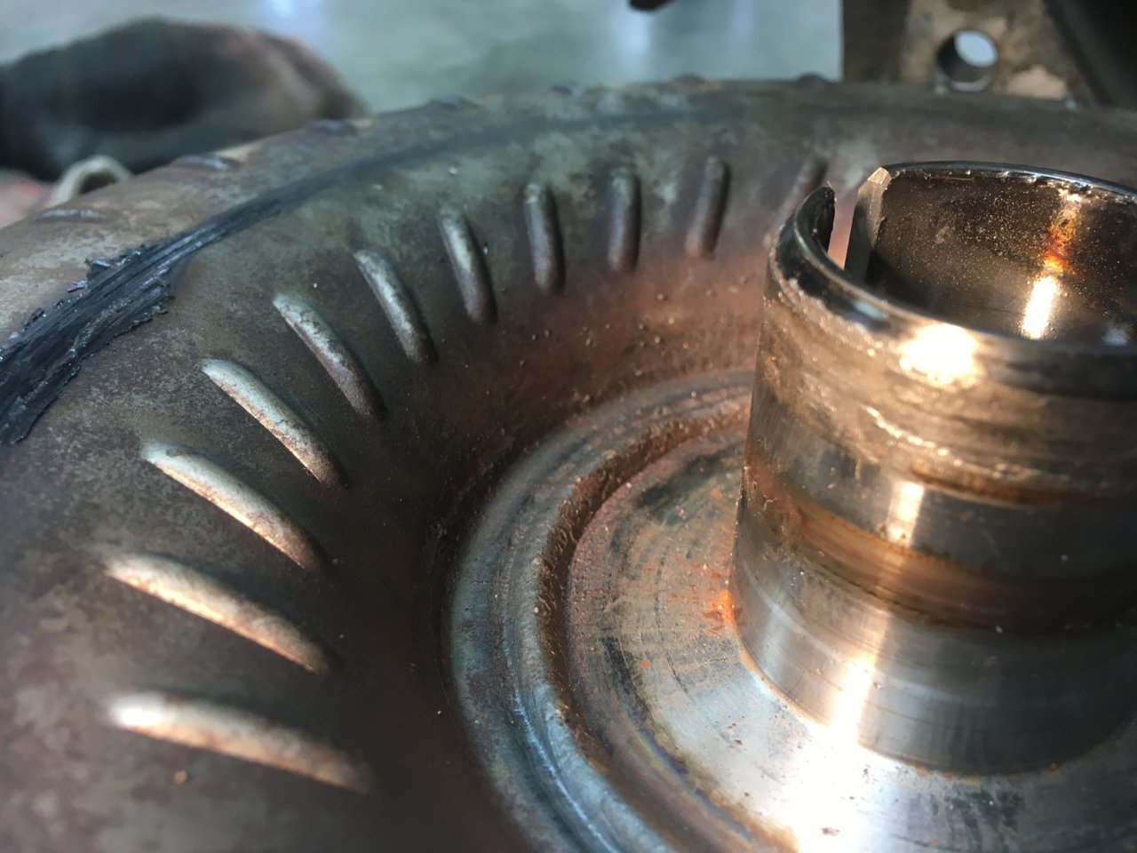

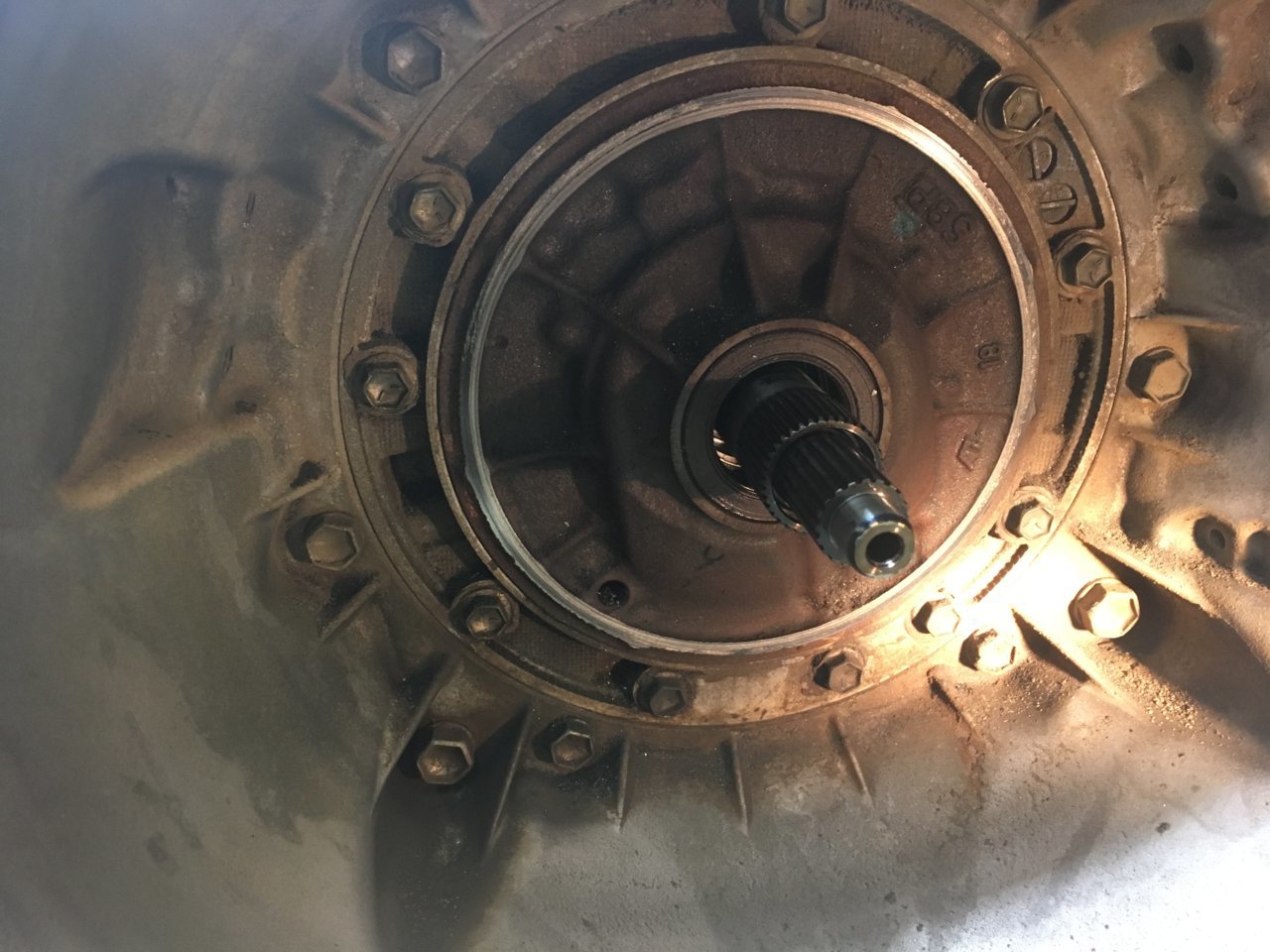

    I finally got it checked with a good scanner. It isn’t good news. I pulled the transmission out today. I see what the problem is but I am not sure how it happened. The ears were broke off the pump. There was a wear mark around the back of the transmission where the torque converter rubbed it. There was also a sleeve that was stuck on the end of the converter. When I put the transmission in the converter was all the way back. I don’t know if I could have pulled it sideways a little when I tightened the converter bolts. I have started putting the other transmission in today but I will have to finish it hopefully tomorrow. I am a little concerned because I am not sure what I did wrong.

  20. Apr 1, 2018 at 11:48 AM
    #20
    Ttrucks3
    Ttrucks3 [OP] Member
    Mar 24, 2018
    #248274
    21
    2006 Tacoma
    This is what it looked like.
