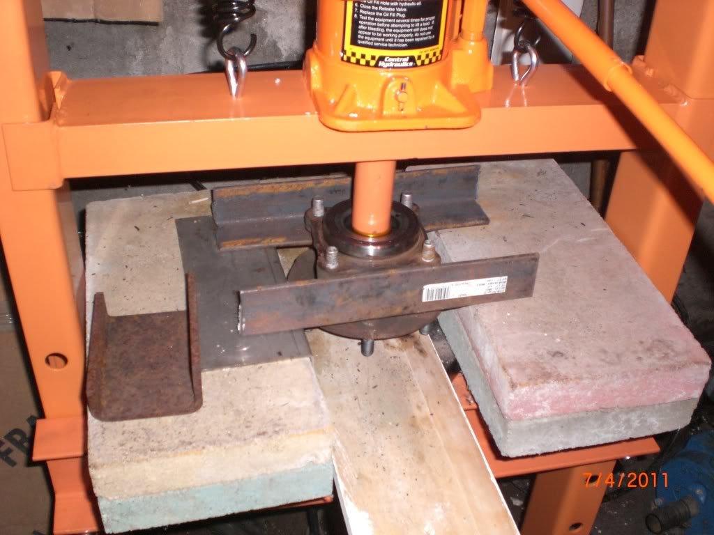

    Its surprising that more people don't complain about cross members failing. Either people dont know or trucks are not rust enough for cross members to snap.
    I will be upgrading mines, I already made brackets to attach new cross member to frame. Its on this picture (its on the left side of the hub that U thingy.
    As you can see from amount of rust I am slacking on that project. I just had no time to finish the rest of the stuff. :eek:
