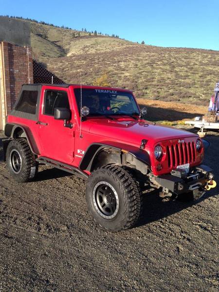

    Thank you for the responses! I sent him the link for the thread so he can read it. So it sounds like a 2.5" lift and some 275/70's are his best bet to keep the cost low. I know he wants a complete coilover kit so the Bilstein one sounds right up his ally.
    As far as the drop brackets go for a sfa, yea drop brackets suck. What's the point of lifting your frame 2.5" if you just going to lower it back down 2.5" with the brackets. It's kinda silly if you ask me. I would rather spend the coin on a good set of adjustable control arms that currie sells cause they have Johnny joints which are the best joints out there and totally rebuildable.

    Thanks! I sent my buddy the thread so he could read your post and others and learn a little.
    And thanks! I love my jeep! I can post more pics of it later if you want to see a few more

    Ok I will see if I can find some more later and post them up for shits and giggles.
    Yea I still have the D30. Running 315/75r16 nitto mud grapplers currently. Once I can get a D44 or a Dynatrac Pro Rock 44 up front I will upgrade to 37's and a set of ATX slab beadlocks.

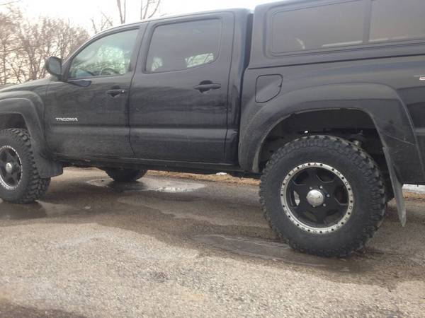

    Yeah he knows but he doesn't want to change gears again and he likes not rubbing and having more room to flex. Here's a pic of his jeep :D
