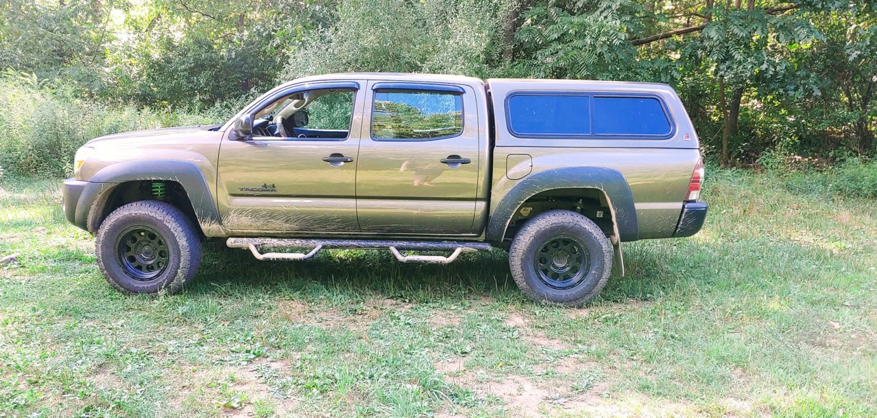

    I have the Ironmam nitro stage 1 and Freedom off-road UCAs and love it. Rides great on and off-road and handles almost stock in corners. I purchased the the performance option, you also get constant load if you have aftermarket bumpers and haul alot of weight0905201557~2.jpg
