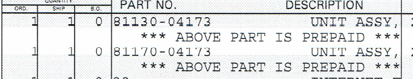

    These are probably the best restore kits I've used. I've turned a bunch of folks on to them as well.
    Unfortunately my DRLs eventually melted my headlights, so I replaced my OEM 08 lights with another set of OEM lights about three years ago.
    These are the part numbers I installed:
