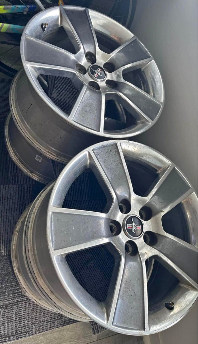

    I just picked up a 2014 X-Runner and I’m looking to replace the rims. I live in Hawaii and it’s difficult to find someone selling the stock X-Runner rims.
    Would the 2008 Ford Mustang rims fit on my truck? I uploaded a picture of the 18” rims.
    What size tires would you also recommend?
    I appreciate the help. Mahalo!!

    Bolt pattern is the same so no problem there
    Hub bore is 70.5 so you'll want some hub centric rings to fit the hub bore on the truck
    Offset is +45 compared to the stock +30 of an X-runner wheel so you'll want to run at least a 15mm spacer. The spacer can also be used to change the hub bore eliminating the need for a hub centric ring.
    As far as tire size you can stick with the stock X-runner tire size since the Mustang wheels are the same width at 8 inches.
