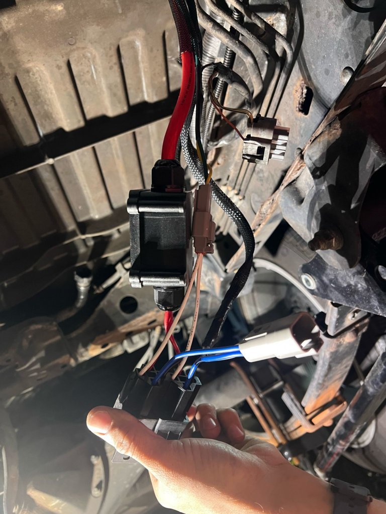

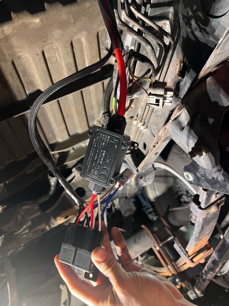

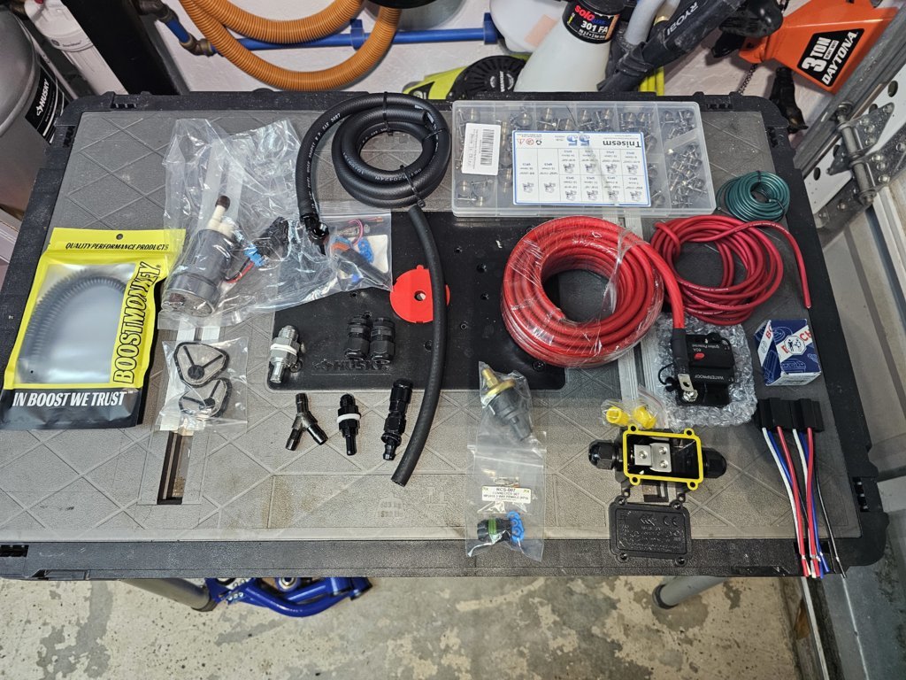

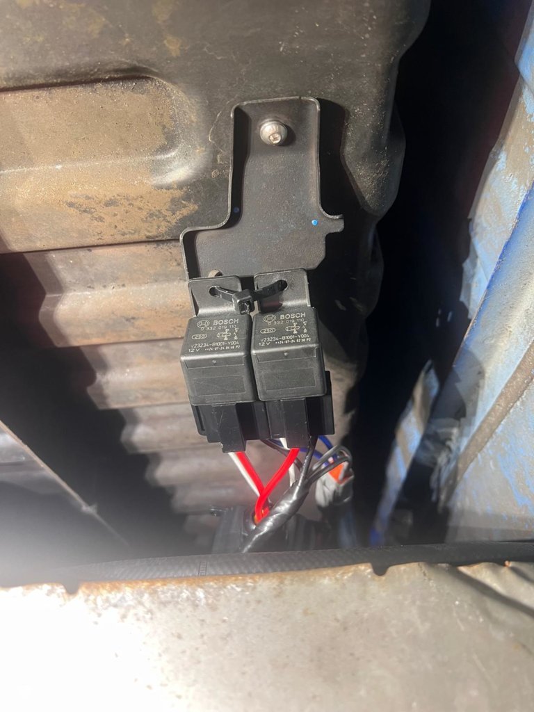

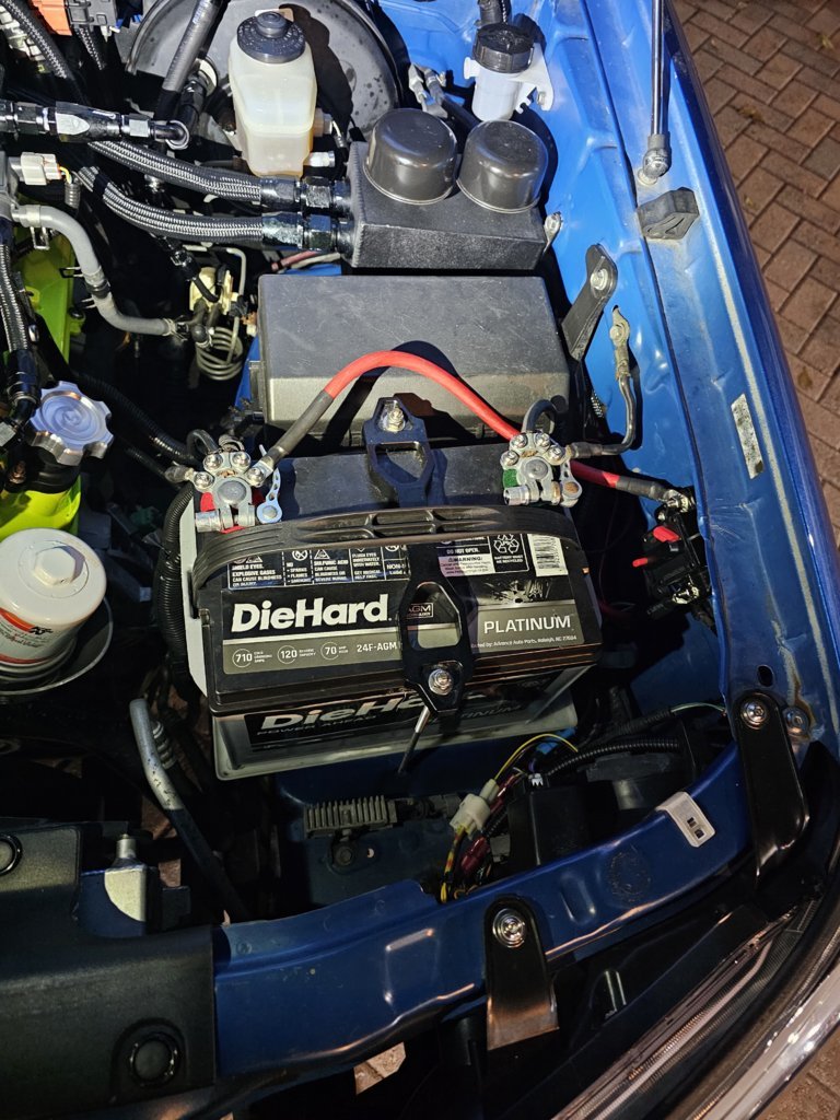

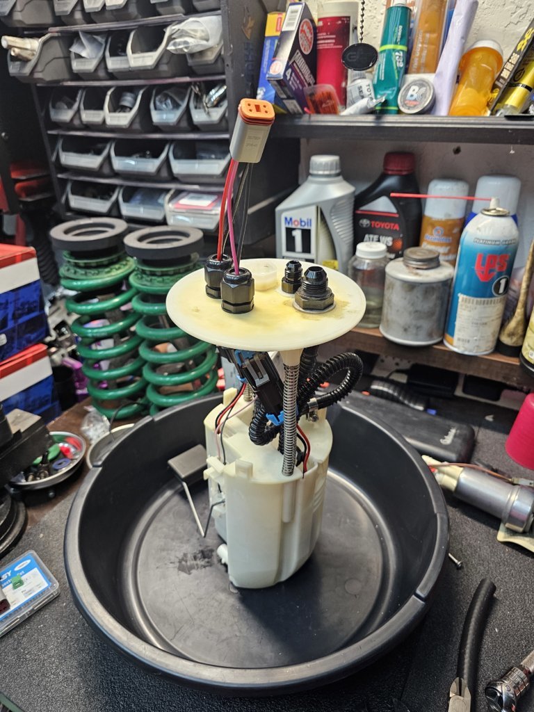

    Everything that went into wiring and installing the second pump. 4g power wire into a distribution block that is inside of a water proof junction box. Relays get direct power in a short distance. And I used deutsch connectors

    On the first iteration of my front mount turbo kit, this is the same ideology that I used.
