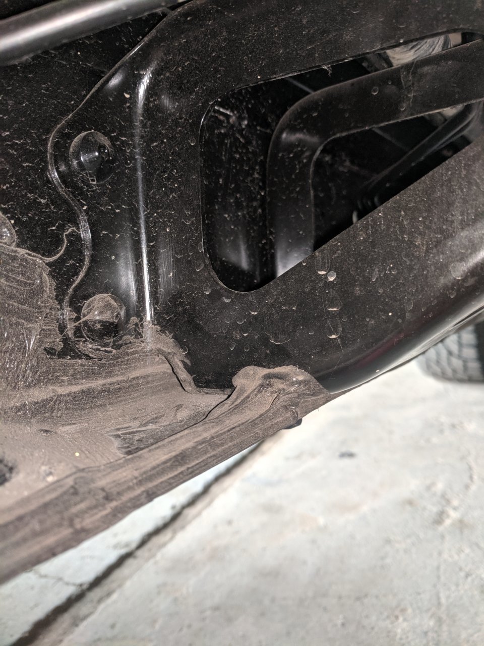

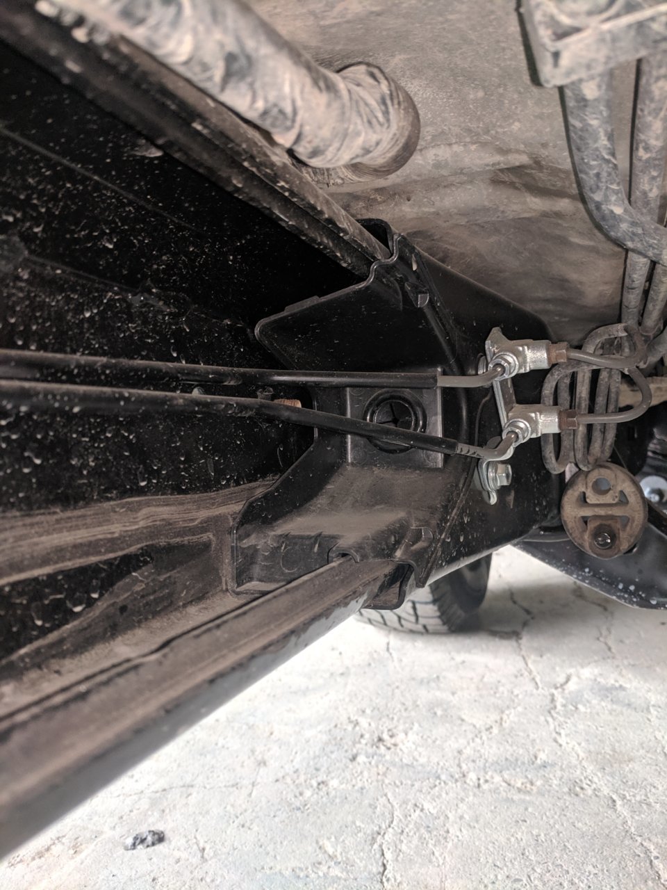

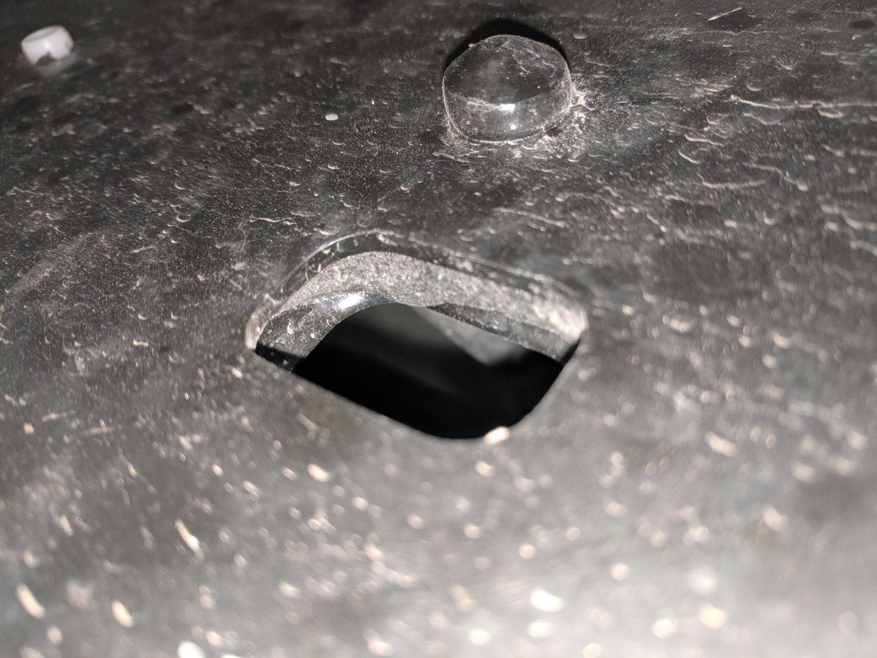

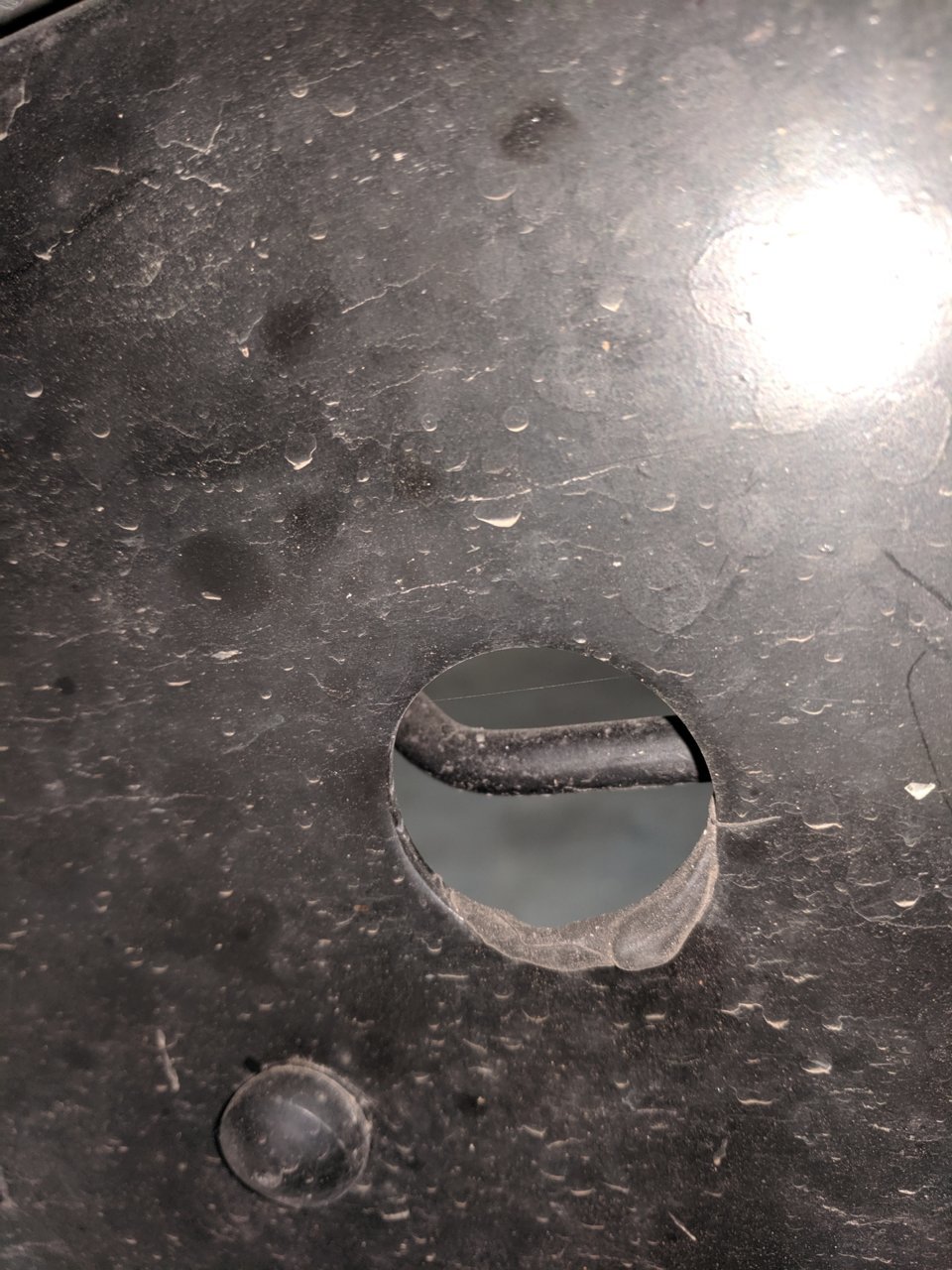

    As far as I can see the vin is not stamped into the replacement frame or carried over anywhere. I've crawled under my truck and thoroughly gone over and looked at everything since the frame has been replaced but havent found it. It's a bare frame with only various stickers which include the claim number issued by Toyota when your truck first qualifies, the dealer ID performing the replacement and some stickers with your/the owners name. I took pictures of them in case they decide to fall off or wash away.
    Overall my observation is that they changed certain holes and the locations of them between my old frame and the new frame. There's also a layer of silicone/epoxy that appears to be laid between or just along the edge of where separate layers meet to IMO eliminate the delamination some people where experiencing. There also seems to be a foam layer that I've found between certain areas of the frame and any where they had to scratch the surface to attach a ground strap was painted over to prevent sightly rust. They even provide covers that are installed to prevent dirt from entering the boxed portion of the frame. The hole that was previously located inside the cab mount behind the front tires is gone and the 2 holes just below that have been plugged with bolts. Those holes where previously threaded on my frame.
    My truck qualified February 6th and I got it back on April 27th. Just over 3 months from start to finish. It's an 06 4dr off-road and only been in Washington state it's entire life.

    Thanks for the information and pictures. Has everything been working good? Does the truck feel tight?
