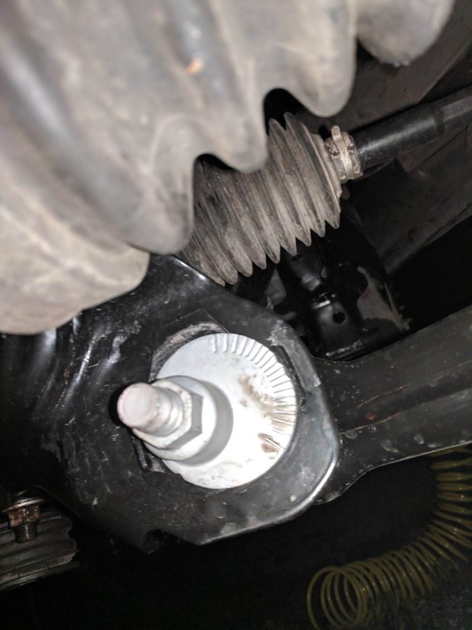

    Truck feels good after the swap and drives straight. I've got a ujoint in the front driveshaft to replace and one of my calipers sticks so I'll be doing a front brake job soon. I found a few things that weren't torqued properly, on major thing being a cam bolt on one of the front lower control arms. A few days after I picked it up it started pulling to the right and I crawled under the truck to see what was up. First thing I noticed was this.
    The bolt had loosened up and shifted the alignment causing the pulling to the right. Bent the tab on a BRAND NEW FRAME! :mad::annoyed: I was pissed for a few days but over it now. After that I went over the whole thing with a ratchet and wrench checking for anything else that might have been over looked. My rear bumper wasn't aligned correctly, there's a tight gap on one side and a biiiiig gap on the other. Also noticed the common complaint of more than a few wire harness clips broken and just zip tied back to the frame. A couple of the rubber plugs on the cab floorboard weren't properly reinstalled or even put back in at all. They were just laying under the carpet next to the hole they were supposed to plug.
