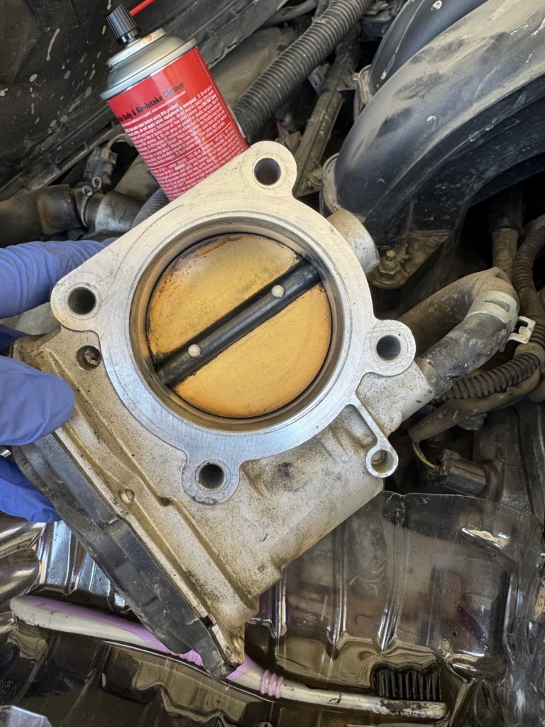

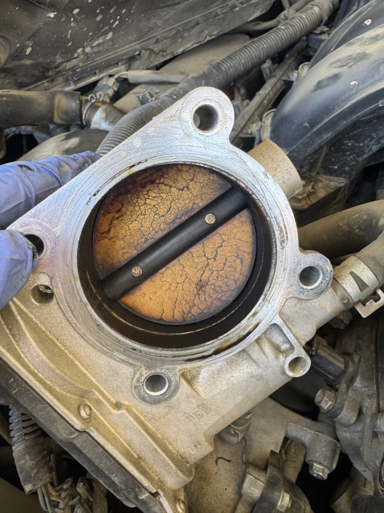

    Thank you for this visual tutorial it made life easy! First time doing MAF maintenance. Truck has 115k now. It is easier to clean the back of maf if the whole throttle body is removed.
