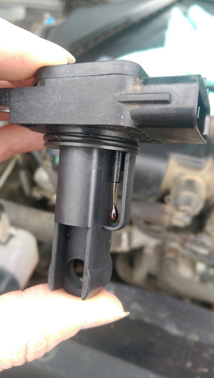

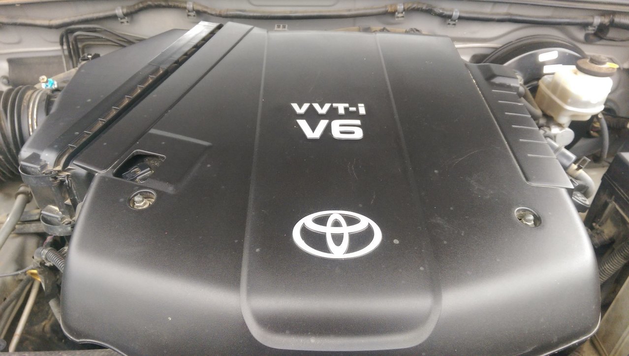

    I'm new, and not sure if where this goes, but I wanted to add it for some DIY guys that are just getting started. I couldn't find anything about the MAF on second gens and wanted to clean mine. It's super easy and I noticed a smoother idle immediately! Here's the pics for removal:IMAG1943.jpg -first remove the engine cover

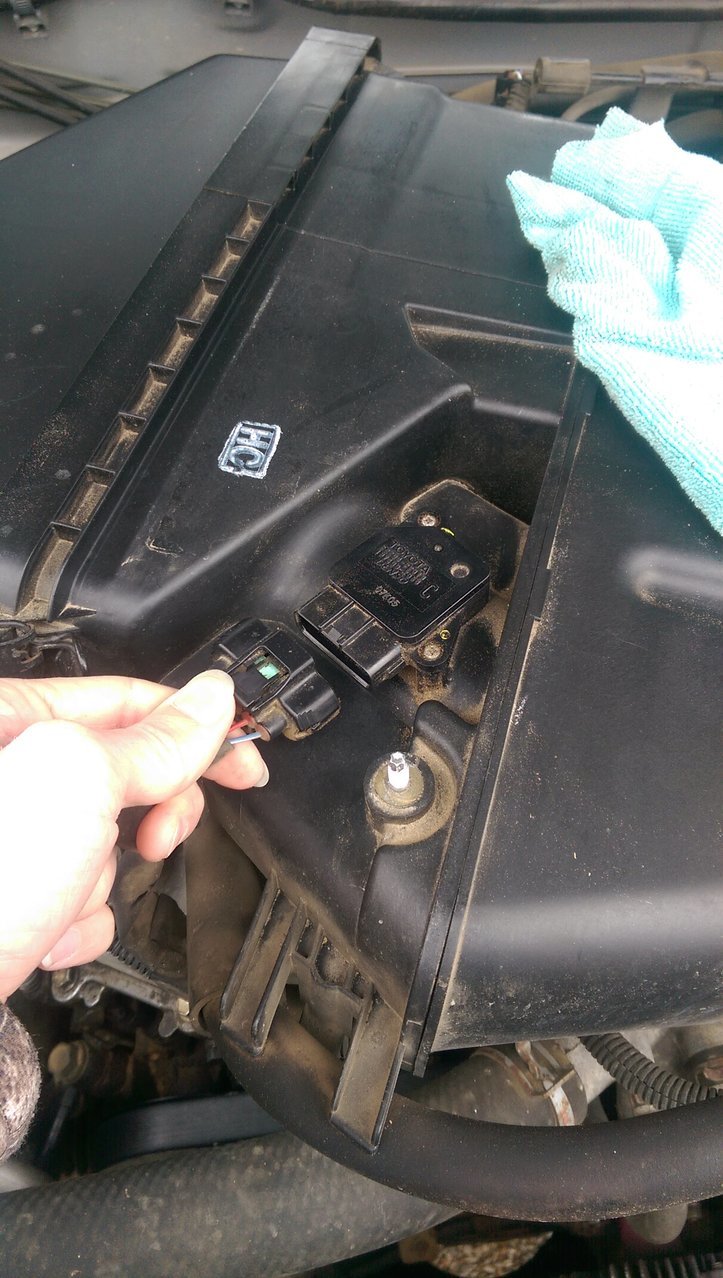

    IMAG1944.jpg -undo the negative terminal on the battery, and unclog the MAF sensor. It's just behind the left engine cover retainer stud. Then remove the two Phillips head screws that retain the MAF sensor.
    -gently pull the sensor from its place and pug the hole with a rag to prevent debris from entering. Spray the sensor plate, and the wire harness connections on both ends with MAF cleaner.
    The plate may require multiple applications to fully clean buildup. After satisfactory cleaning, allow to dry and replace in inverse order of removal. Don't forget to hook the battery back up or it won't start lol. Good luck!

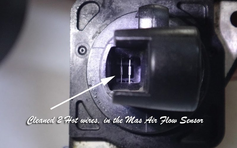

    Not trying to hate on your write up, just wanted to add, there's also elements inside the housing that can be cleaned also. DO NOT STICK ANYTHING SOLID IN THERE. The wires are very delicate and can be damaged easily if not careful and you will need a to purchase a new one if you damage them. I used the sensor safe cleaner as you mentioned and a q-tip in a gentle twisting motion. Clean until you're q-tip doesn't discolor. You will probably need to use more than one q-tip.
