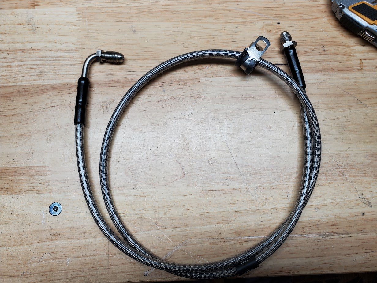

    I ordered and returned several different OEM hardlines but was never able to find the right one for my application. I just ended up getting a custom braided SS line made from HEL Performance. Cheaper than the factory part and since it was going to the Tilton HRB I installed, I didn't need to use a metric to AN adaptor; I just had HEL build me a metric to AN line.

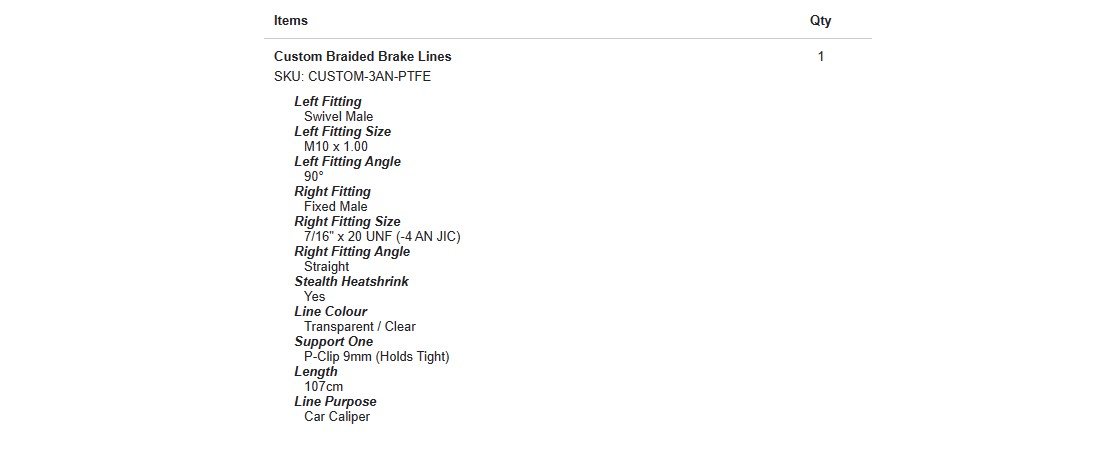

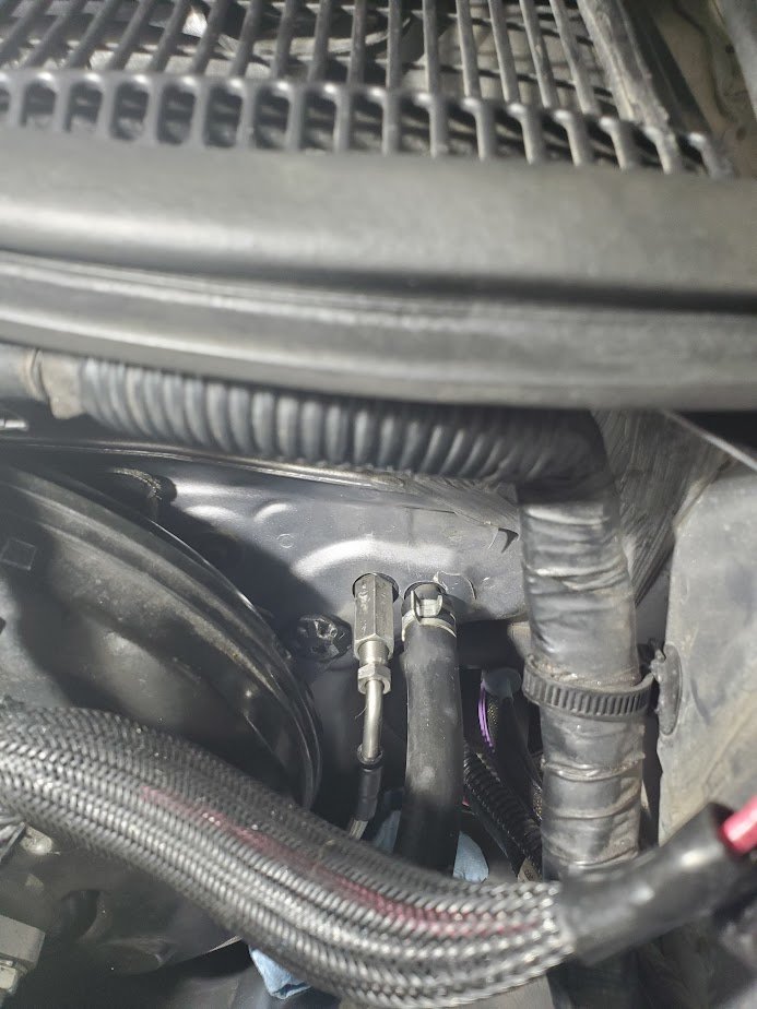

    Here's a screen shot of the specs from my order. Looks like 107cm for the overall length for me but I'd recommend running some string from the master to the slave and determining just how long your application is.
    I'm pretty sure both sides of the line are M10x1.00 fittings and I chose to do a 90 degree bend at the master cylinder as pictured below.
