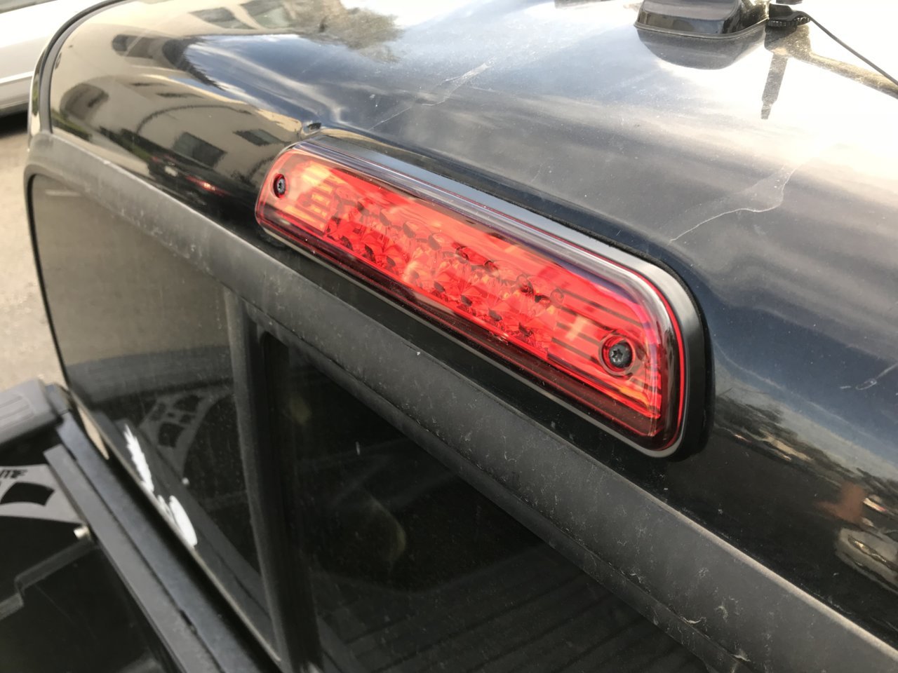

    I have been putting this together over the least couple weeks. I really want to grab the attention of the texting drivers here in cali....
    All said and done its less than a $30 upgrade.
    LED Flasher, Ebay, from china = $3
    LED 3rd brake light for a tacoma, Ebay, from china = $25

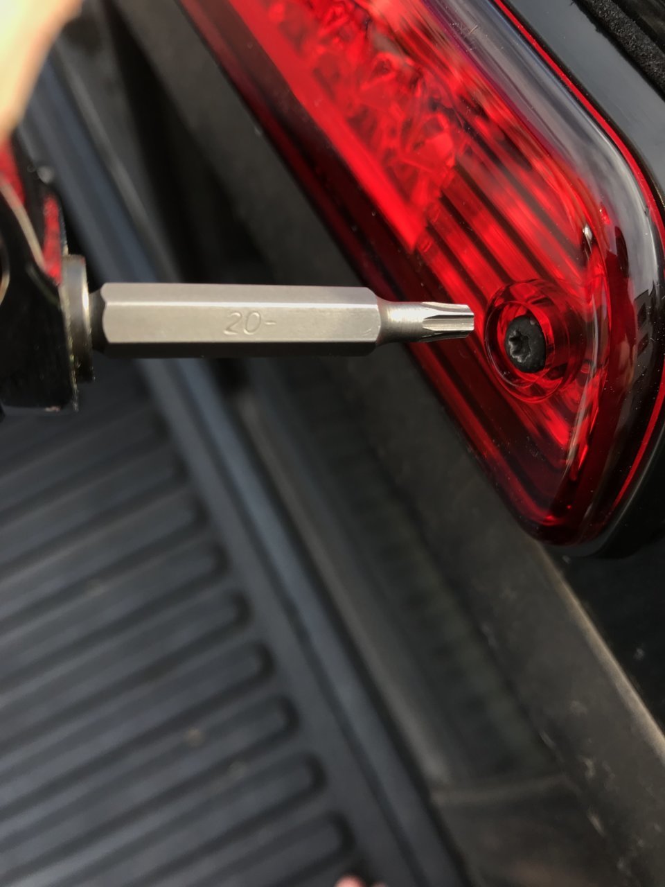

    Torx bits, Walmart, 3 pack = $2.50? (I needed to buy them for this specific job)

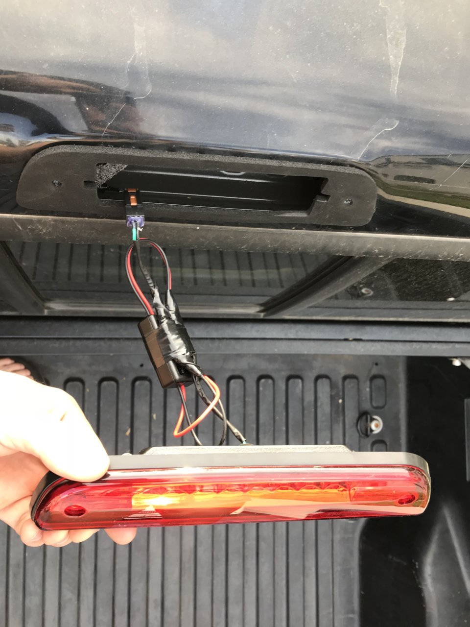

    Install was super simple. Just cut the harness of the Ebay light in have, test wired the module in place, once I got it right (yes you can install it backward, its much brighter if you install it correctly, its says "in" and "out" on the module), I wired it and taped it up. The Ebay light comes with a new foam gasket that is sticky on one side.
    I will shoot a dark video tonight and post it.
    Daylight:
    https://youtu.be/b5FoVpEontk
    What do you guys think?!

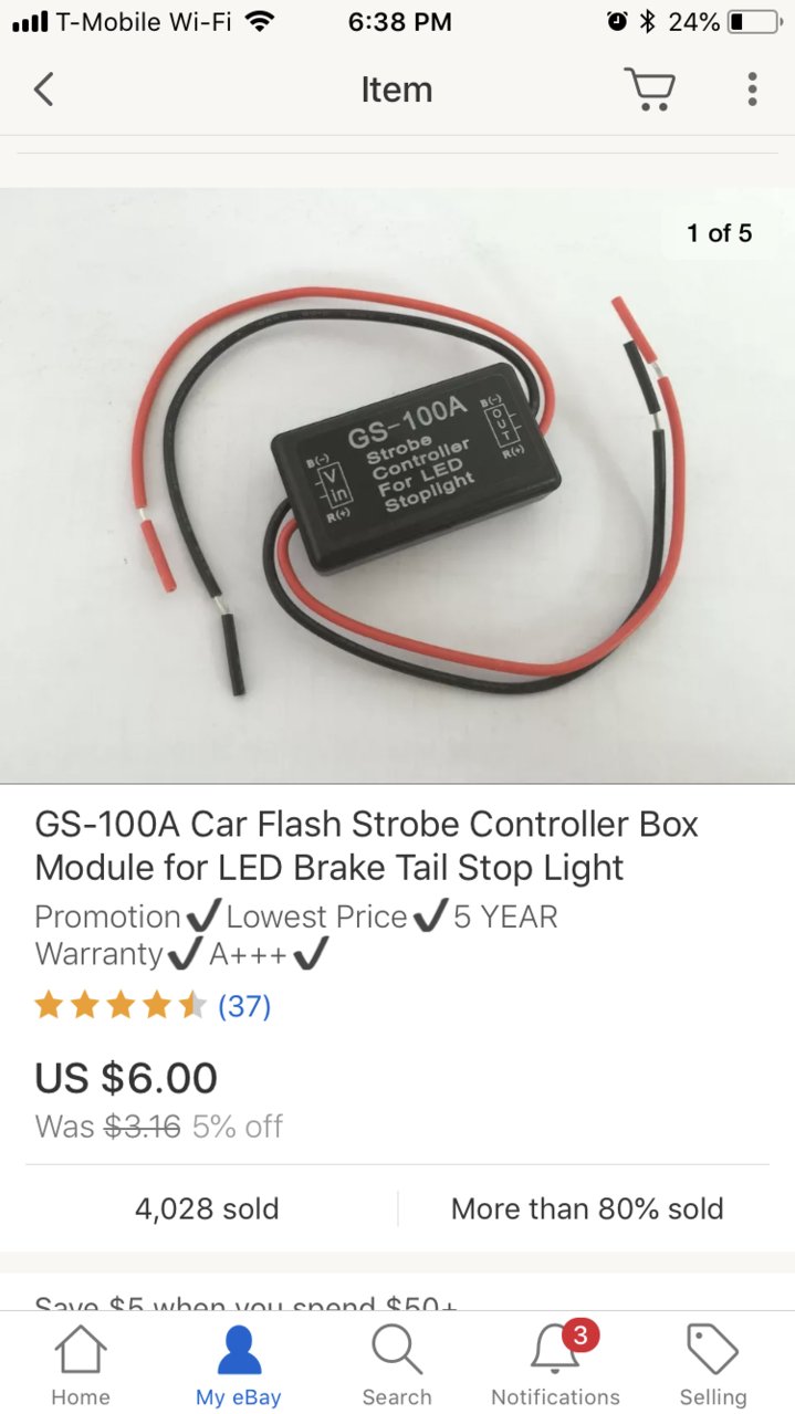

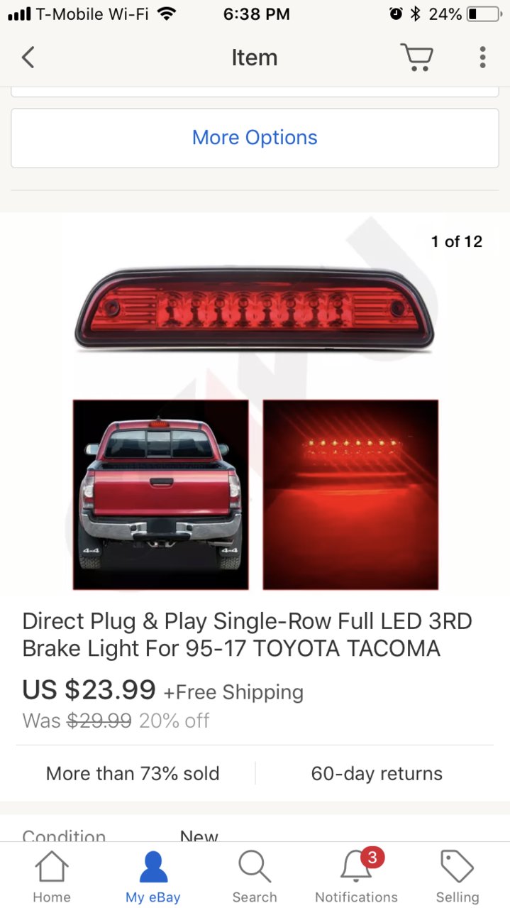

    Here are the parts I bought:
    The LED flasher went from $3 to $6, but still super cheap. Just takes a few weeks from china...
