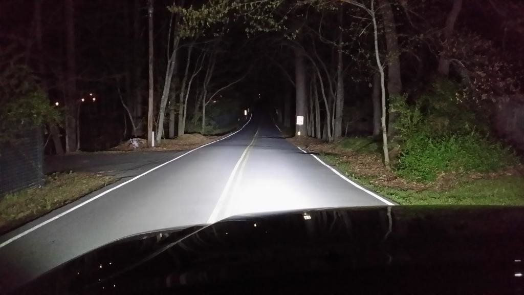

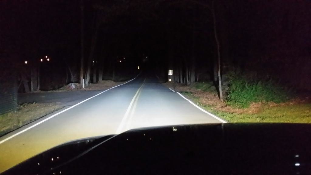

    On my 2011 I did a BHLM and it worked out great and I loved it. In fact I've done a BHLM on almost every vehicle that I've owned. But when I bought the 13 the "chrome surround" that is inside the light really isn't enough to justify me taking them apart this time.
    I ran into a thread talking about these LED lights and I got interested. Bought a set and quite honestly I could not be happier with them. They put out amazing light without blinding oncoming drivers and "so far" have been perfect. The write up is in the link posted earlier. Just another option for you.

    No.... I have no idea what pattern those would throw. I'm suggesting (and yes I know it hurts) factory lights with LED.
    Low Beam
    High Beam
