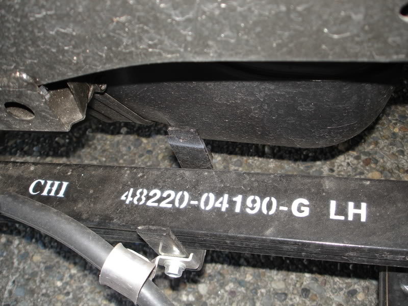

    I don't really think we have any proof at all that the G springs are in fact a "fixed" spring. Keep in mind that Toyota just updated the spring TSB to include ALL 2008 models.. and those (including mine) have the G spring.
    Why would they update the TSB to include a "fixed" spring?
    Having said that, my motorcycle (400lb) + me (200lb) + friend (165 lb) jumping up and down as hard as we could did not bottom out my G spring. :confused:

    i dunno....but the updated tsb doesnt say anything about the "g" spring either. just the part number up to that part.

    Hmmm... I guess these springs on my 09 are not the new ones. And I already got a one inch spacer in the rear, I guess if I can get this TSB done, the blocks won't be needed. Thanks for the info. Here's the spring that's listed on the TSB.

    yup...same ones i have
