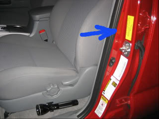

    My 2009 TRDsport double cab has the sticker inside the door. Its bright yellow and hard to miss.
    CLOSE UP OF STICKER
