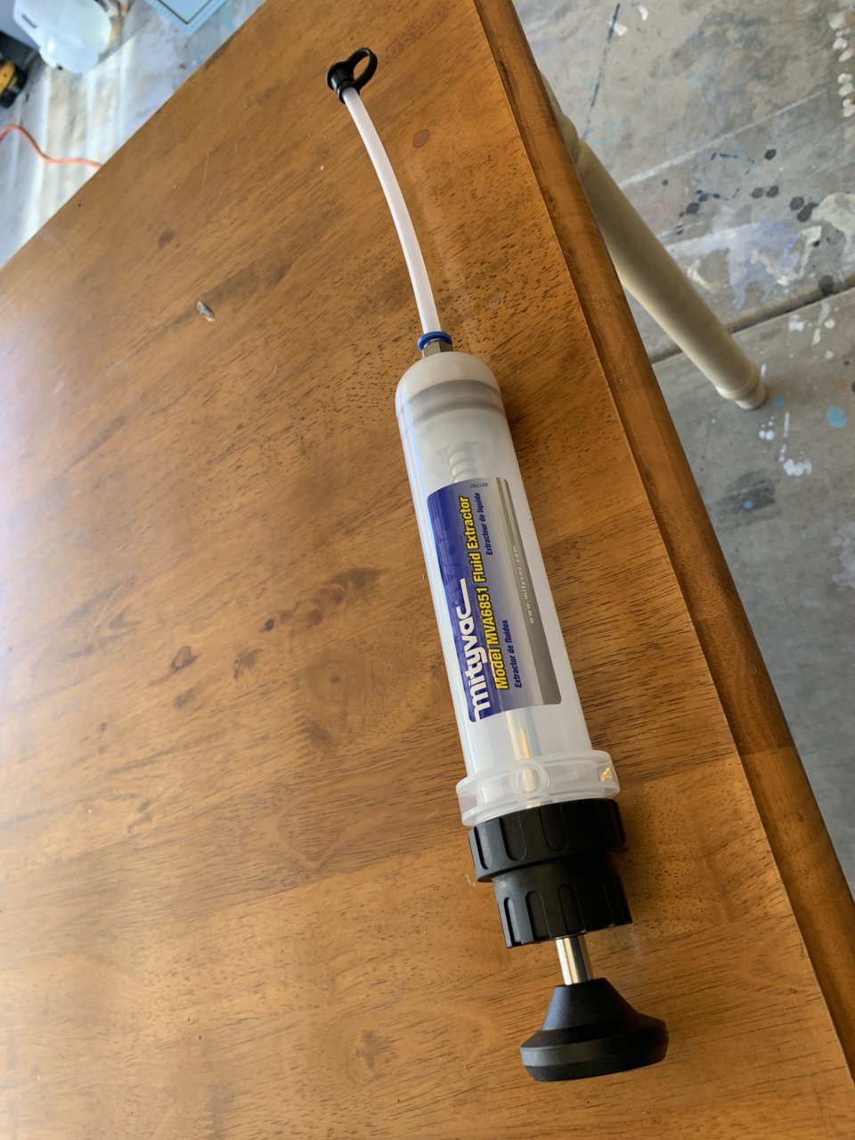

  4. Jul 7, 2020 at 5:55 PM
    #24
    Skydvrr
    Skydvrr IG: @kalopsianick
    Sep 13, 2017
    #229889
    12,647
    Nick
    YMH
    Black '17 OR
    It's really not *that* hard. Once u do it a few times it's really no that crazy. Get one of these if u do the oil change yourself

  7. Jul 7, 2020 at 6:05 PM
    #27
    Raylo
    Raylo [OP] Well-Known Member
    Nov 19, 2008
    #10878
    1,354
    MD, USA
    2023 Tundra SR5 OffRoad; (2009 Tacoma - sold)
    All stock, except for audio and convenience add-ons
    I've got something similar. I also have a Motive Power Bleeder kit that I use as a pressure source with some fittings for various containers to install fluids. Been awhile but I'll have to see if I have something that'll work.

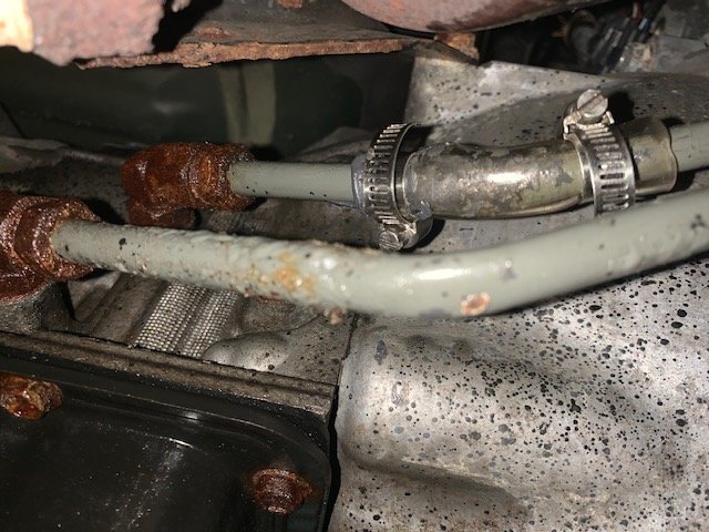

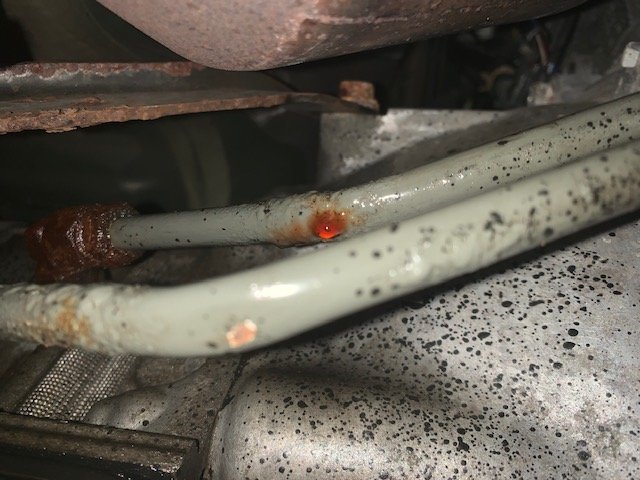

  15. Jul 8, 2020 at 8:47 AM
    #35
    Raylo
    Nov 19, 2008
    #10878
    1,354
    MD, USA
    Well, I have good news and bad news. The good news is that the transmission is fine. The bad news is I DO have a leak... which I didn't have a few weeks ago when I changed the oil. One of the tranny hard cooling lines has rusted out.. and the other isn't far from it. There is a steady drip with the engine running... I believe this just started Sunday and has been steadily been getting worse.
    I made up a kludged temporary patch with JB Weld Quik, some tubing and clamps. So far it is containing the leak. The transmission ends of these lines are easily accessible but I haven't gotten the truck into my tiny garage yet to be able to lift it and get a look where they clamp to the soft lines. I hope that is accessible. Otherwise seems like a simple job. Need to find the parts.
    I added a quart of fluid and the trans is behaving much better, but not perfect. It could be down a good bit more. I am not going to go through the fill procedure until I do the full refill. I may add another quart in the interim but it is such a PITA without a dipstick and fill in under the hood. Won't be driving much anyhow...
    OK, you guys can say "I told you so" now!

  16. Jul 8, 2020 at 9:20 AM
    #36
    Raylo
    Nov 19, 2008
    #10878
    1,354
    MD, USA
    Local dealers don't have these in stock so I ordered them from Toyota of Greenburg as noted in the other thread I found for this same issue. P/Ns 32921 and 32922. I need to study the drawings some more and/or get under to see if those rubber lines connect up to more hard lines that may also be on their way out. Damn, I hope the hard brake lines aren't headed this way also.
    Edit: looks like another set that goes across the front P/N 32907A
    Here is that older thread:
    https://www.tacomaworld.com/threads/replacing-leaking-transmission-cooling-lines.583887/

  18. Jul 8, 2020 at 10:53 AM
    #38
    Raylo
    Nov 19, 2008
    #10878
    1,354
    MD, USA
    That's exactly what I did. The leak probably began Saturday or Sunday when I first noticed the shifting issue whilst returning from a road trip. By the time I found it the the leak had had gotten pretty bad so I figured I had lost a good bit of fluid. I added just another 1.5 qts making the total added 2.5 qts. Trans is working perfectly again in all respects. And my JB Weld/tube cooling line patch is still dry after driving another 20 miles or so. Should easily hold until the parts arrive.
    I also learned something else... The ScanGauge 2 has a programmable Xcode for trans temp that will make doing the official fill much easier. Unfortunately my Scangauge 2 is so old, like about 10 years, the firmware won't support that... and to get the new firmware you need to ship the device to the mfg. What a PITA. Only $25 so I will probably go ahead and do that.
    Musubi3[QUOTED] likes this.
