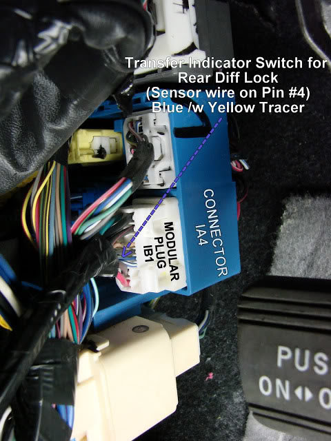

    Yes most likely it would set a code.
    OP still hasn't said if he checked that connector behind the kick panel yet.
