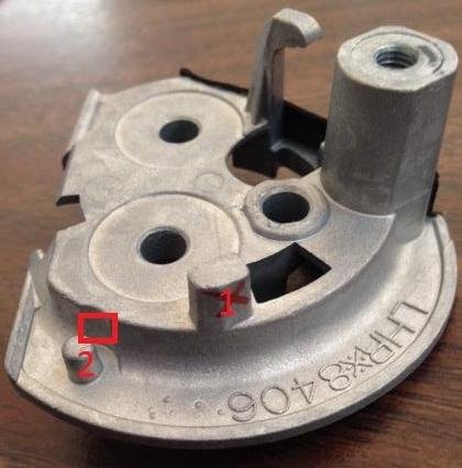

    Sorry this is a crappy low res edit but you can retain the 4Runner brackets if needed. You will need to trim either the plastic base (from Tacoma) or the 4 Runner bracket. I chose the bracket.
    1. Cut / grind knob until flush with surface
    2. Cut / grind knob until flush with surface
    3. Cut / grind this area minimally as it will hit on the plastic base. Or grind the plastic base where it hits.

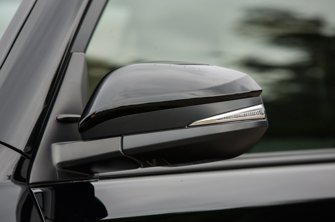

    and one more thing, has anyone tried the new 2014/15 mirrors? personally I think they are a little too sleek and look like they should be on a car, but someone might be interested.
