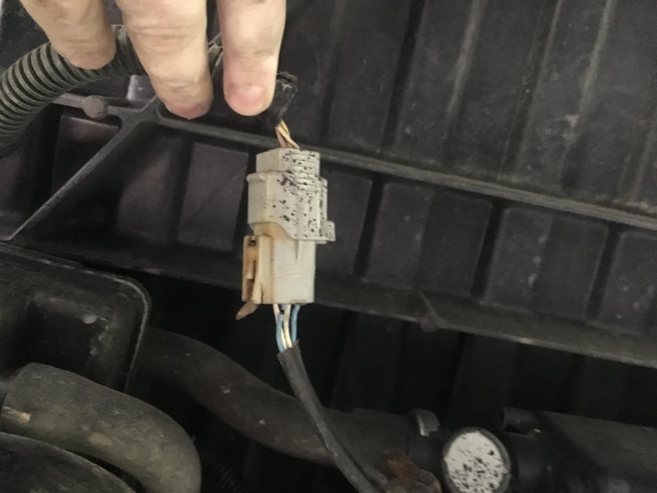

    2010 double cab with codes c0210, c0215, C1238. I have a broken wire at the harness in the the rear. Not sure if that is fixable. Not much to slice into. Maybe a new harness can be made? I see after the harness the 2 wires are joined and then go to each rear tire with multiple connection points. Would rather fix it if it is possible. Any suggestions?

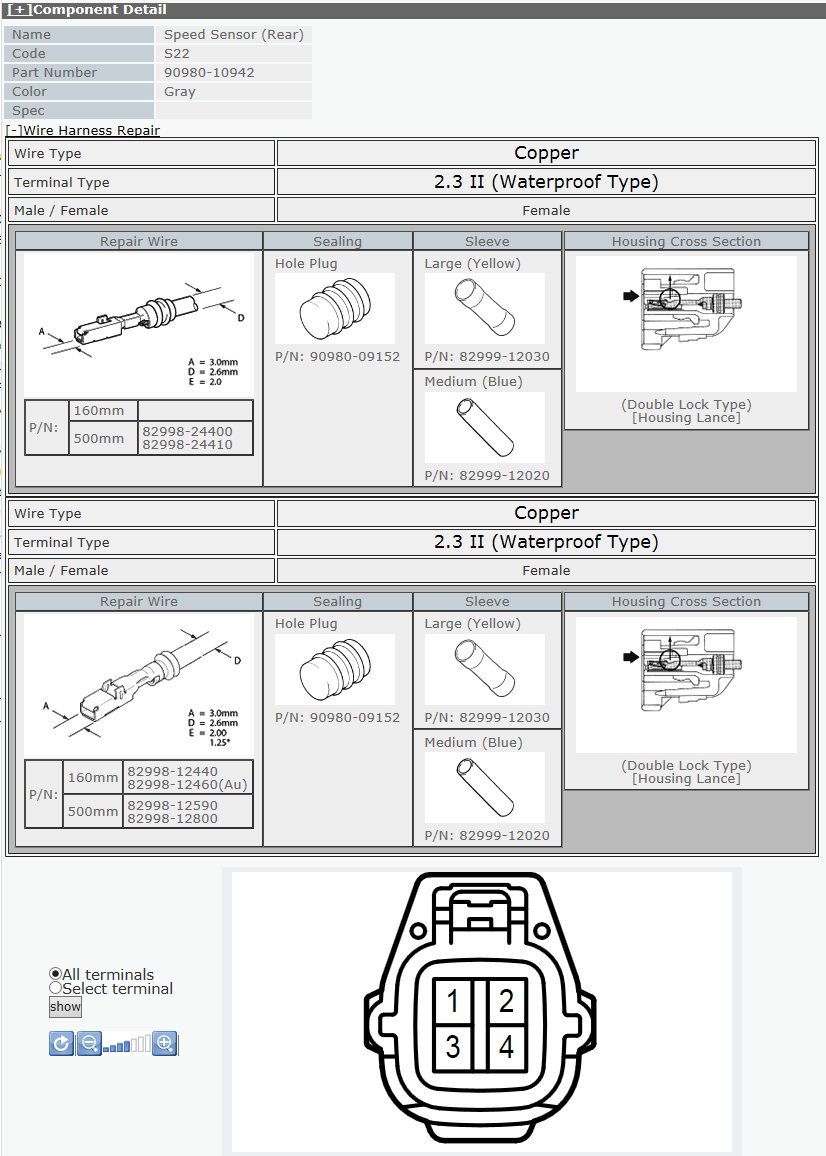

    I am guessing taking the plug apart and installing a new pin is beyond your skill level at this time .
    Take the plug apart remove the broken wire solder the wire back on. Anew pin makes it much easier.
    Used harness

    I would replace the terminal and solder the wire.
