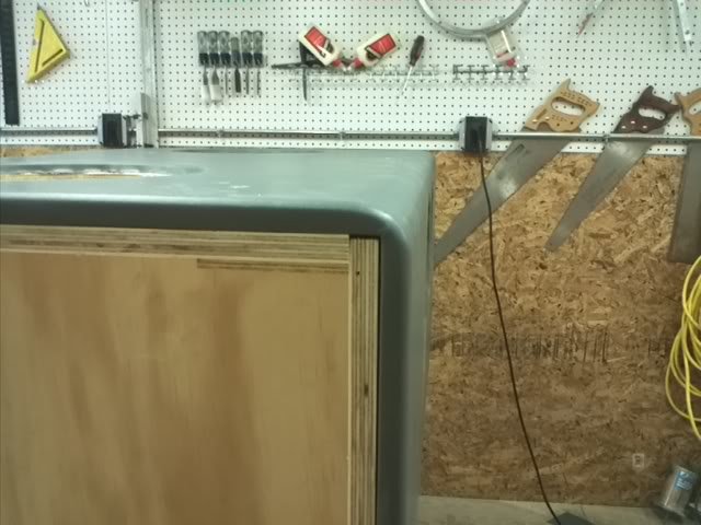

    here is a picture of the enclosure that replaced the rear seating area with out the trim panels in place there is literally nothing visible when they are in place
    some of the building of the enclosure

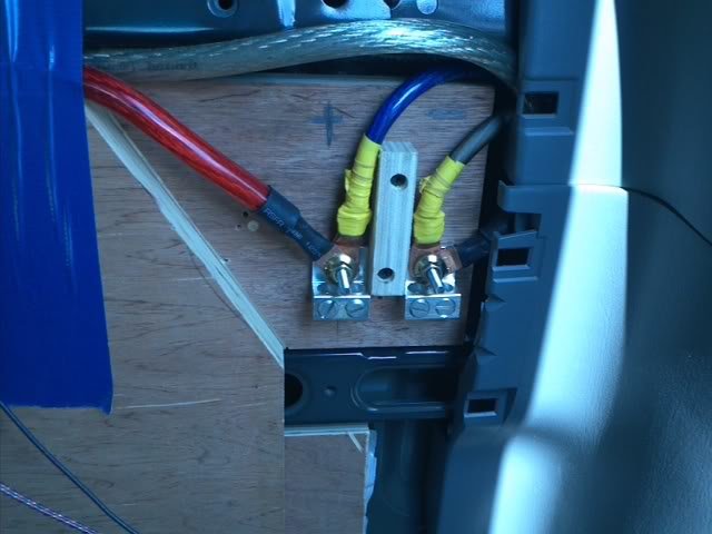

    battery cable wiring on drivers side

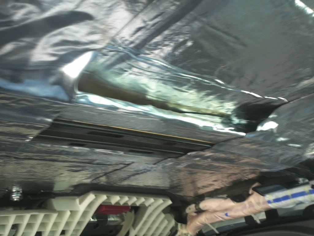

    this is the deadener installed on the roof and the red box is the tpms receiver
    as you can see i was very careful to not pinch damage or in any way alter any factory wiring during the install
