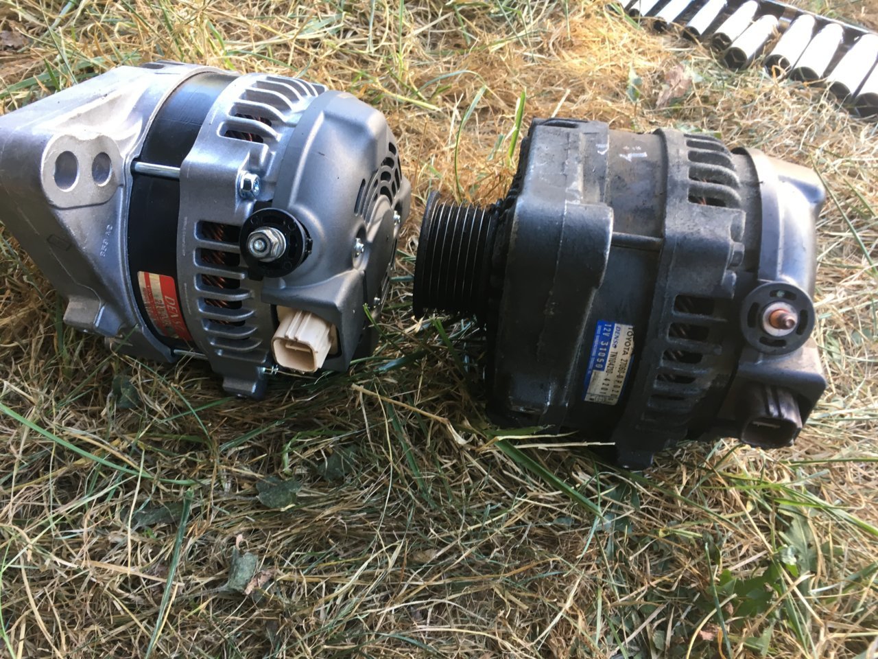

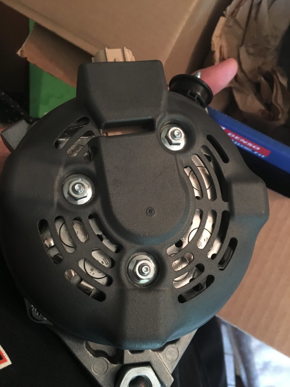

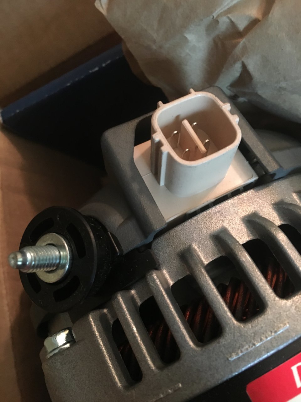

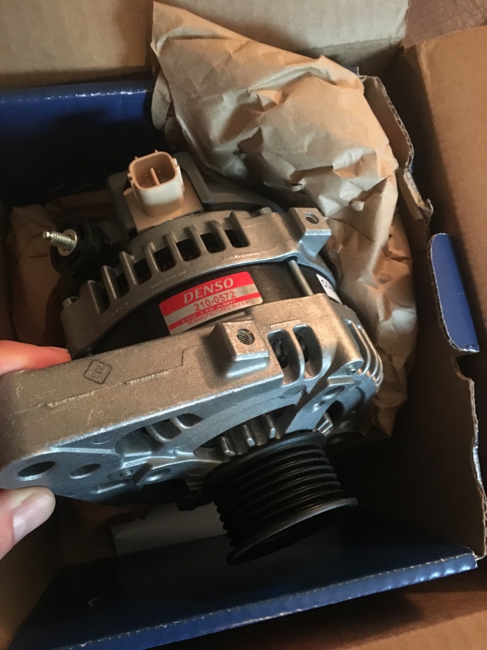

    Their description seems conservative. Mine looks pretty new, they’ve definitively replaced a lot of parts.

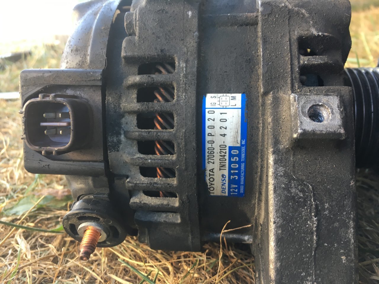

    Got mine in. Not a bad job, it came out through the top but it’s a tight squeeze. Old one still worked fine but after 9 years and 150,000 miles it’s pretty dirty and the bearing feels a little gritty.
