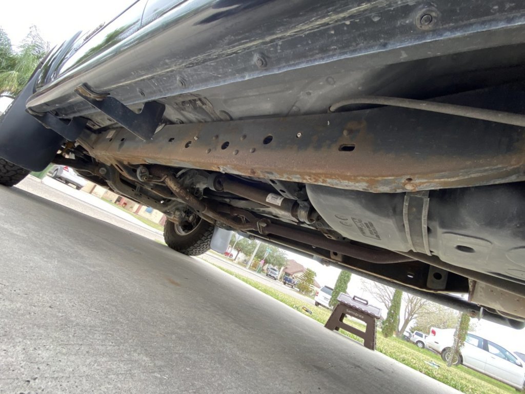

    Taking mine this Saturday. Unusually rusty for being a Texas truck all its life. I bought it with a badass frame and suddenly rusted on me over the last 2 years. Rust is expanding onto my drive shaft and differential

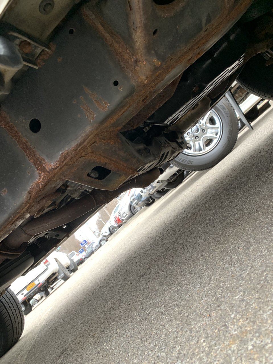

    IMG_7140.jpg Here's something interesting to check out. I saw this Tacoma Sport on a Toyota dealer lot in upstate NY this weekend. Since I've been keeping an eye on the frame of my 2015 I wanted to go take a look when I saw this gen 2 with a for sale sticker in the corner of the lot. This was a 2013 with 65ishK on it. This sure looks like a lot of rust to me but I am far from a expert on the subject. I don't think I'd be buying this truck having taken a look underneath. I wonder what everyone else thinks, is this acceptable "surface rust" or something more problematic. I didn't want to bother asking the sales team about the truck and the rust situation, I figured posting it here would provide some good feedback. I'm not in the market for another Tacoma, I'm just trying to keep an eye on frames and rust now cause I want mine to last me a long long time! I got home from seeing this truck and did my 2nd basting of Fluid Film since the fall ;-)

    CRC only works well if the metal is clean and rust free from the get go. Applying it over rust will only make it rust faster since it seals in moisture. I would go over your frame really well and sand away any rust and paint over it before you take it to the dealer for the application. Also, after a year or two the CRC will start to get dry and flaky, you can rejuvenate it by spraying Fluid film on top. Doing so will keep the CRC in the wet, greasy state that it works best in.
    My 04 got it in 2010. The frame is mostly shiny black paint under the CRC from where Ive scraped it off. There are a few spots (up by the engine mounts and shock towers mainly) where it was not applied well, or applied over existing rust. Ive had to scrape away the CRC, sand down to bare metal, prime, paint, then fluid film on top of these spots. If I were you, I would drop the spare, and remove the rubber fender/splash guards before you take it in. Mine never got sprayed behind those liners, and behind them was the worst rust on my truck.
