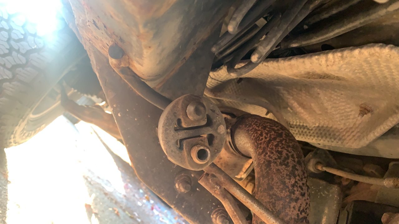

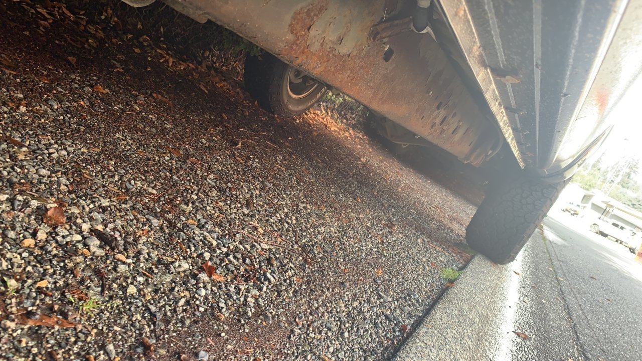

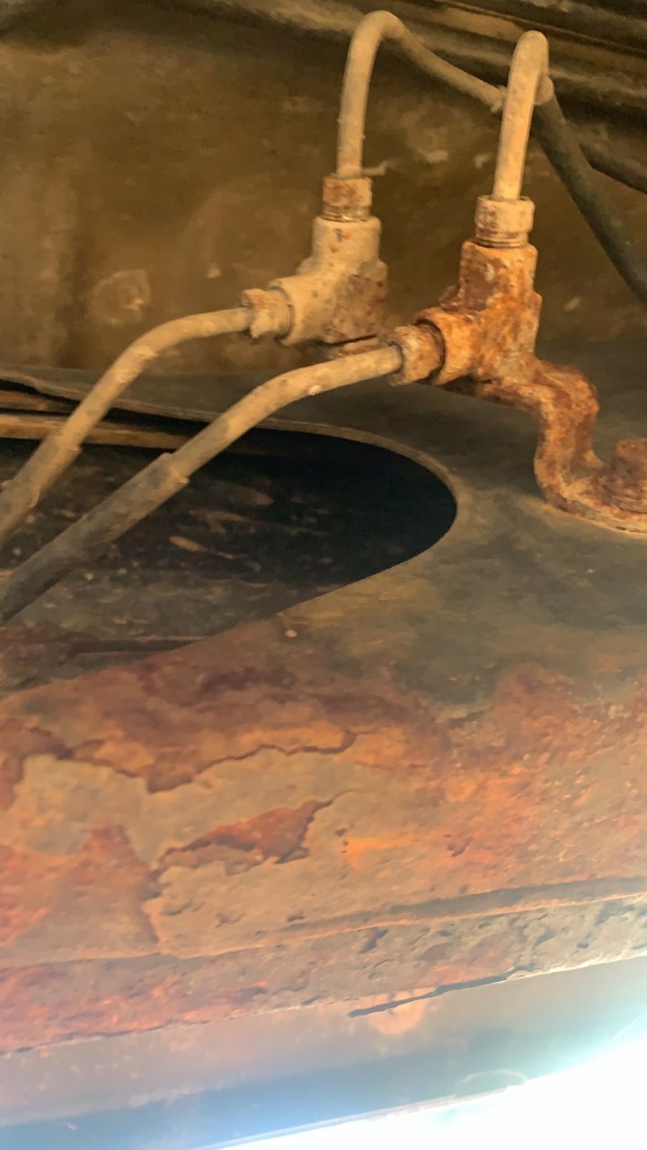

    Hi guys, so i took my 2011 taco into get the inspection recall for the frame and they said frame has major surface rust but no perforations and would schedule me in for the crc application
    i went home and took some pictures, let me know what your thoughts are should i go and question the dealer some more or contact toyota canada and see what they suggest or can do
    any helpful insight is appreciated

    Without seeing pics up near the cats, I can't say for sure, but looking at the pics you posted, I'd have to agree with them. Unless they can poke a hole in the frame with a ball peen hammer, it technically passes.

    thank you, i will still do my own due dilegence and take a hammer to the frame this weekend and look up near the cats just incase the tech missed anything

    I wouldn't recommend that as you may void the warranty. Leave the hammering to a dealership.
