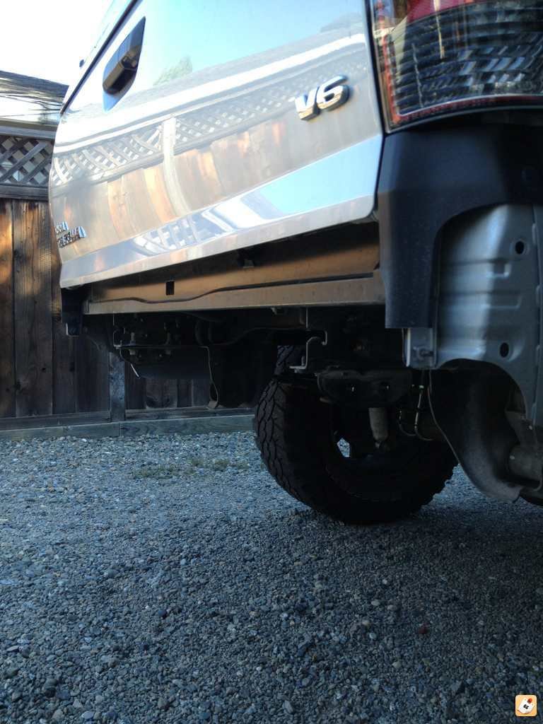

    Today I partially debadged and took off my rear bumper in preparation of my 63 Chevy swap. I'm getting pumped.

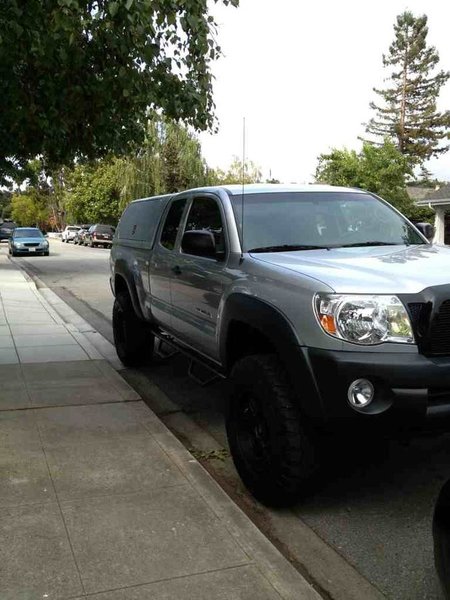

    I decided to plastidip this morning after a surf. Turned out good.
