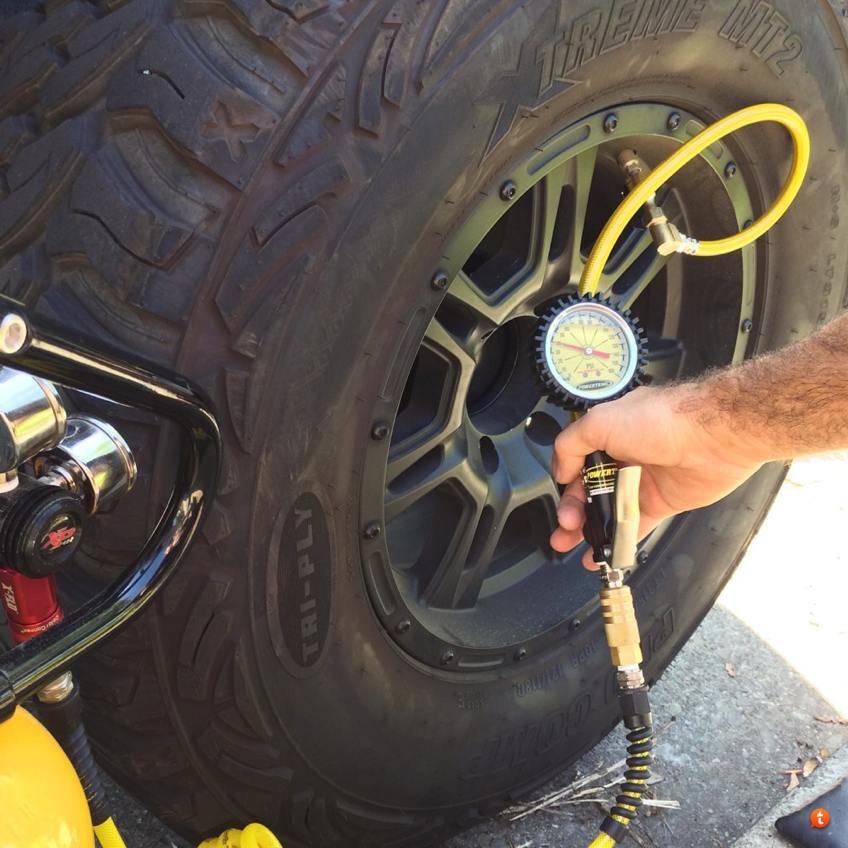

    Played with my new euro chuck today.

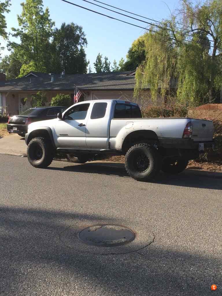

    Took the shell off last night. I'll try and keep it this way until after my brewer lake wheeling trip.

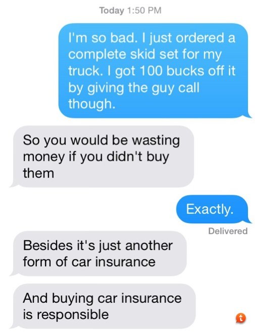

    So this is how my day is going :)....... Lol

    Is that your gf/wife? If so mad props to you my friend, you struck gold! :cheers:

    Bahahahaha.........no. That is my buddy who can always come up with a great way to justify irresponsible financial decisions. My wife is going to kill me.
