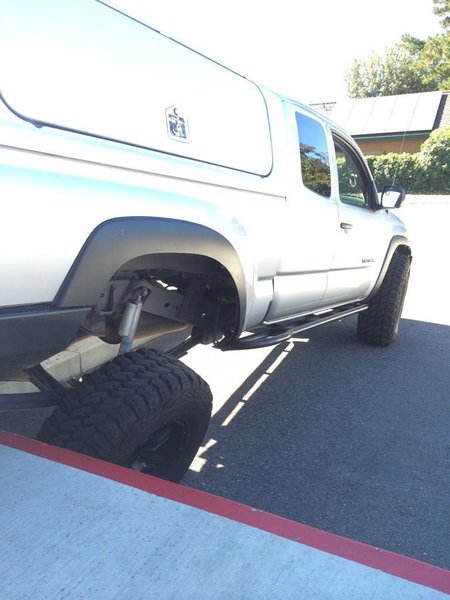

    Thank you sir, so do you think it would be worth it to relocate the shocks and run 14's?
  3. Nov 17, 2014 at 10:09 AM
    #303
    Pdugan6
    Pdugan6 [OP] Well-Known Member
    Aug 11, 2013
    #110271
    1,489
    Patrick
    Sunnyvale California
    3 link solid axle 2011 Tacoma 4x4
    Yes and it would also allow for more droop depending on your shackle length and angle.

    And you could avoid dropping your bump stops to keep as much uptravel as possible. The way I had mine set up the 12" shocks weren't limiting droop but I had to drop the bump stops 2.5-3" to avoid bottoming out the shocks. I still had like 4" uptravel but it was quite high :eek:

    Pdugan6 do you have your bumpstop set for when your spring starts to go negative or when the shock is bottomed out?
  7. Nov 17, 2014 at 2:37 PM
    #307
    Pdugan6
    Aug 11, 2013
    #110271
    1,489
    Patrick
    I set it up so the bump stops keep the springs from going negative.
    Yep. There is plenty of room for up travel on mine but my shocks would bottom out too. And the springs would go negative.

    I really like your truck man... I got some info from you on the rear chevy springs.. I even have all the parts: rear flip kit, rear (front side) leaf hangers and springs I just cant seem to cut into it since I dont have a working welder anymore. :( I did my extended shock towers two nights ago at my buds shop.. but I might hold off on the springs. In the mean time keep posting on here :)
    I got a q for you: what length shocks were you able to run? Looks like you got a lot of droop
  17. Dec 4, 2014 at 3:12 PM
    #317
    clupi
    clupi Well-Known Member
    May 29, 2014
    #130897
    827
    Sacramento Ca
    07 taco 4x4
    Never mind.. I seen your length of rear shocks on the first page of the build :) 12" with stock towers? You must be sitting pretty high in the rear.
  18. Dec 4, 2014 at 4:42 PM
    #318
    Pdugan6
    Aug 11, 2013
    #110271
    1,489
    Patrick
    12" and using the stock shock mounts. I am sitting high in the rear. When I'm not loaded with tools and my shell it probably lifted it 4-4.5" but that can also be adjusted with what length shackles you use.

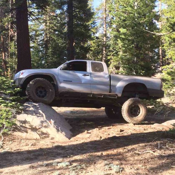

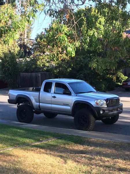

    Random pics
    ImageUploadedByTapatalk1417740803.428275.jpgImageUploadedByTapatalk1417740848.148648.jpgImageUploadedByTapatalk1417740976.361614.jpgImageUploadedByTapatalk1417741065.000442.jpg
