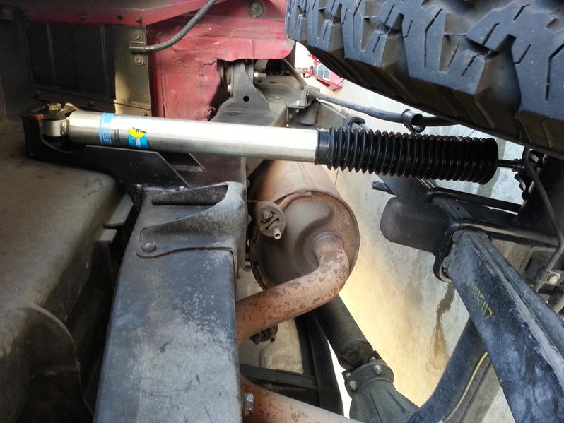

  6. Dec 5, 2014 at 5:53 PM

  7. Dec 7, 2014 at 4:05 PM
    #327
    Pdugan6
    Pdugan6 [OP] Well-Known Member
    Aug 11, 2013
    #110271
    1,492
    Patrick
    Sunnyvale California
    3 link solid axle 2011 Tacoma 4x4
    If I'm on the freeway and hit a big dip I will bottom out. My shell weigh around 200# and I am always loaded with around 500# of tools. It was painful to listen to the knocking of my shocks bottoming out on themselves before I added the bumpstop extensions. Since I put them on it hits the poly bumpstops on the the extension. As far as the front goes, I bought my truck with a procomp 3" from the dealer. I'm not sure what the actual height from stock is. I had to cut 3" out of the front, bash the shit out of my pinch welds and cut and plate my cab mounts to fit 35's. I have 5" shackles in the rear. Yeah, you know you want to dump 7-8k but damn. That's a shit ton of money.:) I will get there some day. I'm sure you will too. It's just a matter if making irrational decisions. Hahaah. This crap is expensive. That's great that you've been able to do your own welding. I don't have the skills to do that myself or the equipment.....yet. It's great to see more 05+ with the 63 swap. Cheers!
