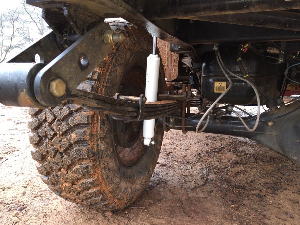

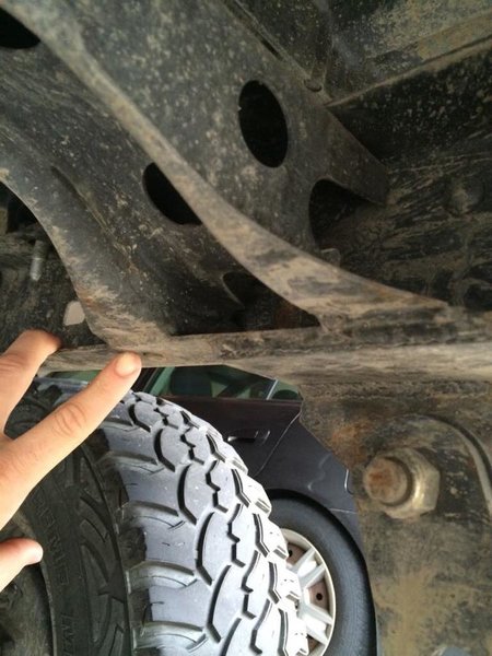

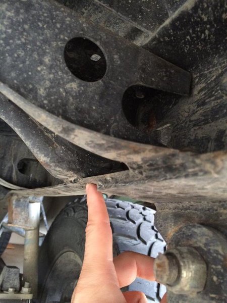

    ImageUploadedByTapatalk1421515500.063382.jpgImageUploadedByTapatalk1421515538.500813.jpg
    Ground and then small weld back to frame
  2. Jan 17, 2015 at 10:13 AM
    #342
    SMKYTXN
    SMKYTXN If it can't be overdone it's not worth doing Vendor
    Mar 11, 2011
    #52810
    14,040
    Nathan
    Houston
    11, 4dr, TRD Sport, 6sp
    DCFB
    Cool, that's what I was planning on doing. Thanks.

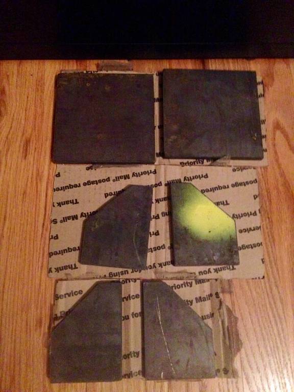

    Ah I see. Cool! So basically it's impossible to do this without flipping your shackle?
  13. Mar 2, 2015 at 6:39 AM
    #353
    SMKYTXN
    Mar 11, 2011
    #52810
    14,040
    Nathan
    Houston
    DCFB
    Correct. These leafs are designed to be run with a conventional shackle, our yotas are the inverted ones.
    The first gens don't need the rear perch since their frames don't taper like ours. That's why the 63 kits you find don't have the perch.
    When you're ready to do your swap send me a PM. I can cut out the rear perch pieces for you.

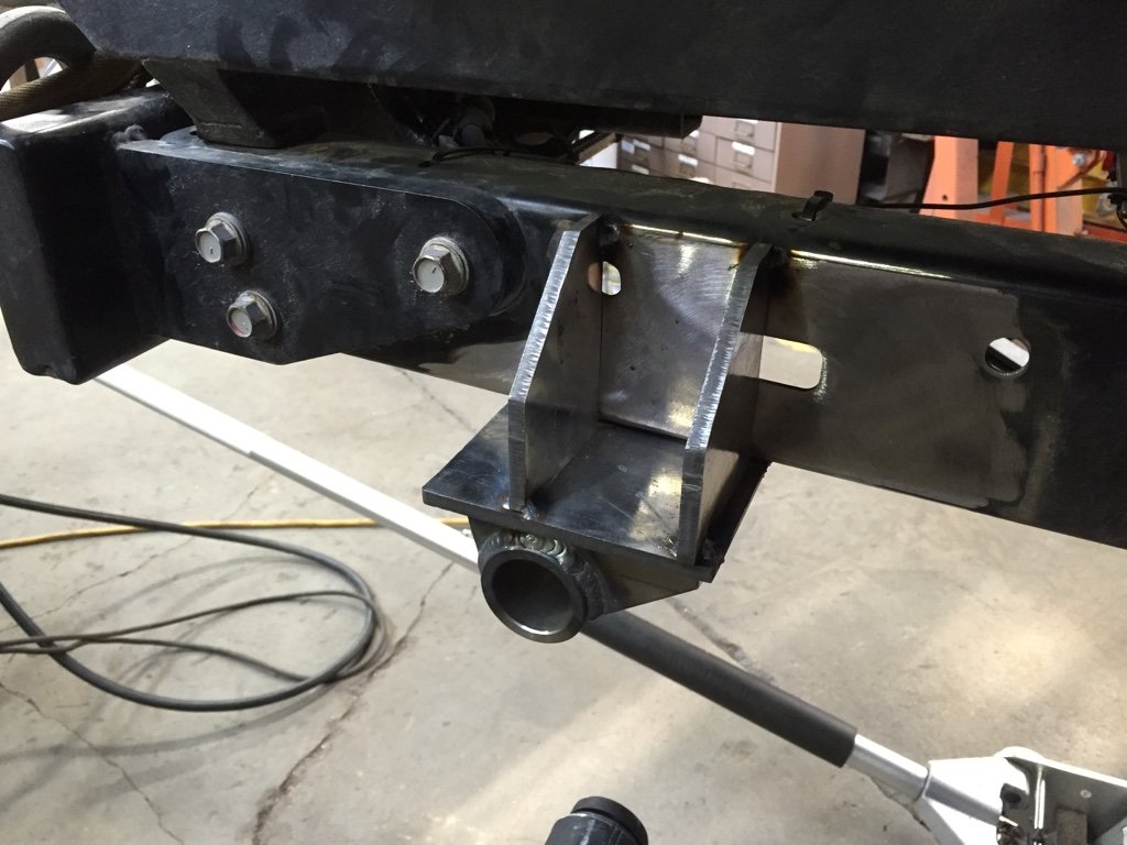

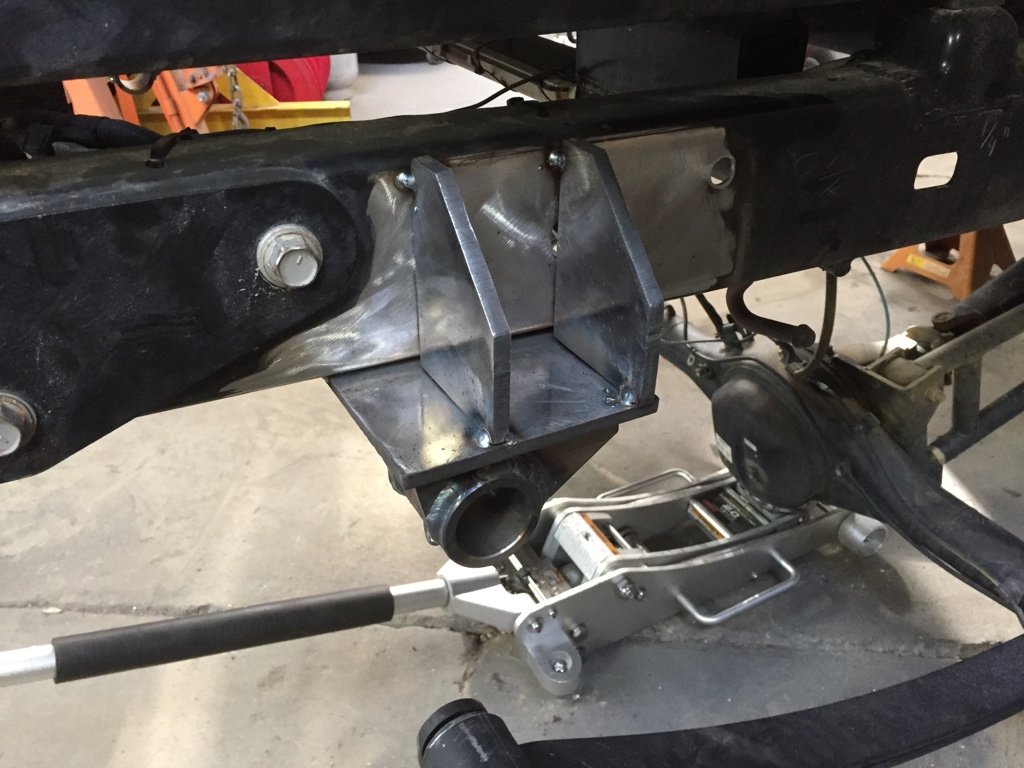

    I cut this set out for geekhouse23. He's in the process of acquiring all the parts necessary for the swap.
    Here are the same plates on my build for reference.

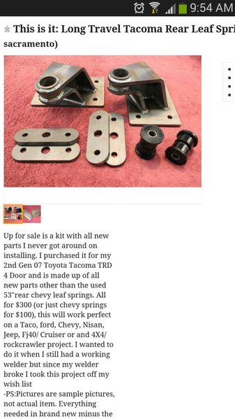

    Ive had all the Ruff Stuff parts to swap mine for about a year now and cant convince myself to do it! I got them on the discount rack since they are here local and I think I spent about $50. I actually posted it for sale on Sacramento CL. Im just woriied it'll come out too tall, if you leave the oberload spring in order to use it for heavy loads you probably gain a lot of lift! No??
    I got some prety nice brackets for the rear (shackle side) Ruff Stuff can build them custom to your spec
    Edit: but regular price are not cheep! I got them on clearance, they were built to the wrong spec for someone so I had to cut them down a little

    Thats a nice install! Whats with the anti wrap bar? Do you think its needed?

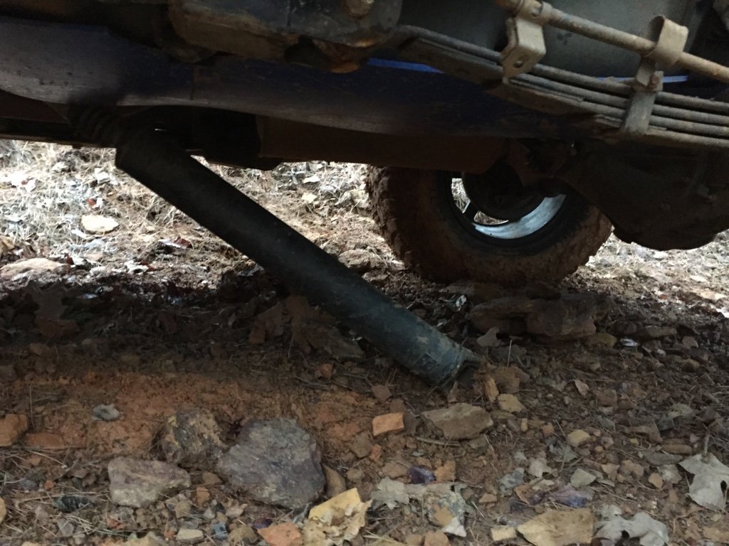

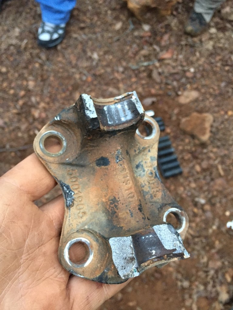

    Let's put it this way. I wheeled without it this past weekend.
    My leafs wrapped hard enough to put the driveshaft at such an angle that the rear flange broke and twisted my new leafs into pretzels.

    So did it do ok, is there a reason you did? A little insurance?? What tires are you running? Are you running a 3 pack (including the overload) chevy 63"?
    Edit: ops, I posted this before your pix uploaded :D
    Before the problem... did you habe a good angle on your driveline? Patrick I domt think is running anti wrap bar.. I wonder why that happened

    I'm running skyjacker 5" lift springs, without the overload. It's my own fault that shit broke. I wasn't running bumps or the trac bar. Both of my temporary rear shocks blew as well. :D
    It was an expensive weekend.
    Yes, I would run a traction bar.
