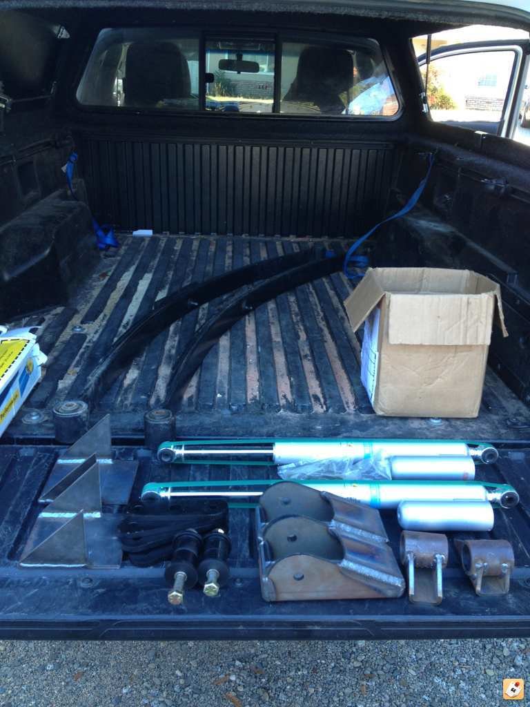

    I got all the goodies together for the Chevy 63 swap tomorrow.

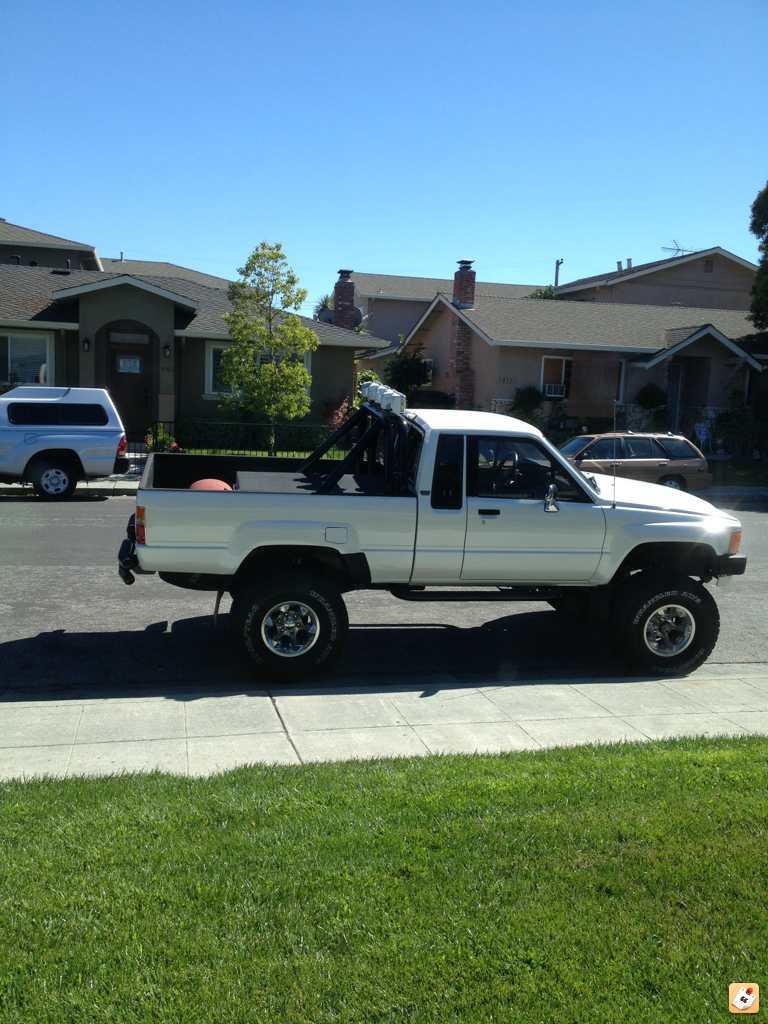

    Took the truck to any 7 offroad for the swap. Now I get to roll around in my father in laws clean 85' :)

    Pick up my baby tomorrow morning. I can hardly wait. Now I'm going to have to find some time to flex it out :) hopefully my ATO rear bumper and 4x innovations sliders show up at my doorstep soon.

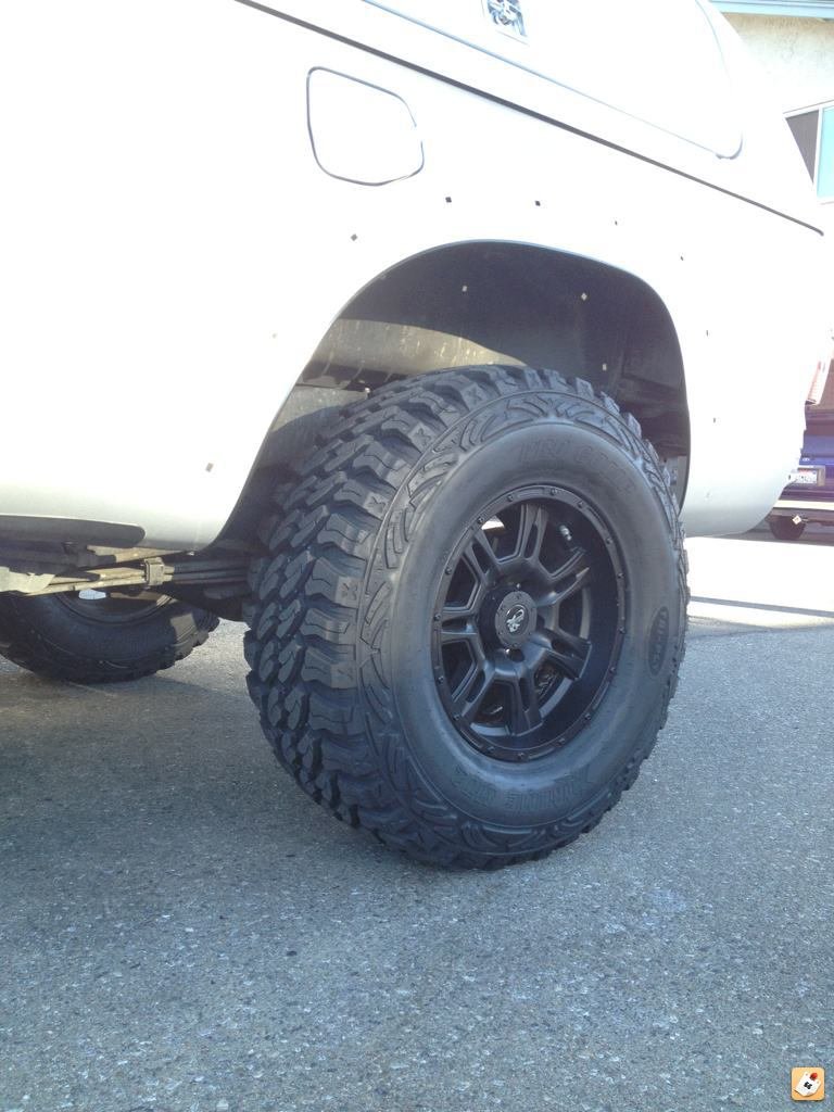

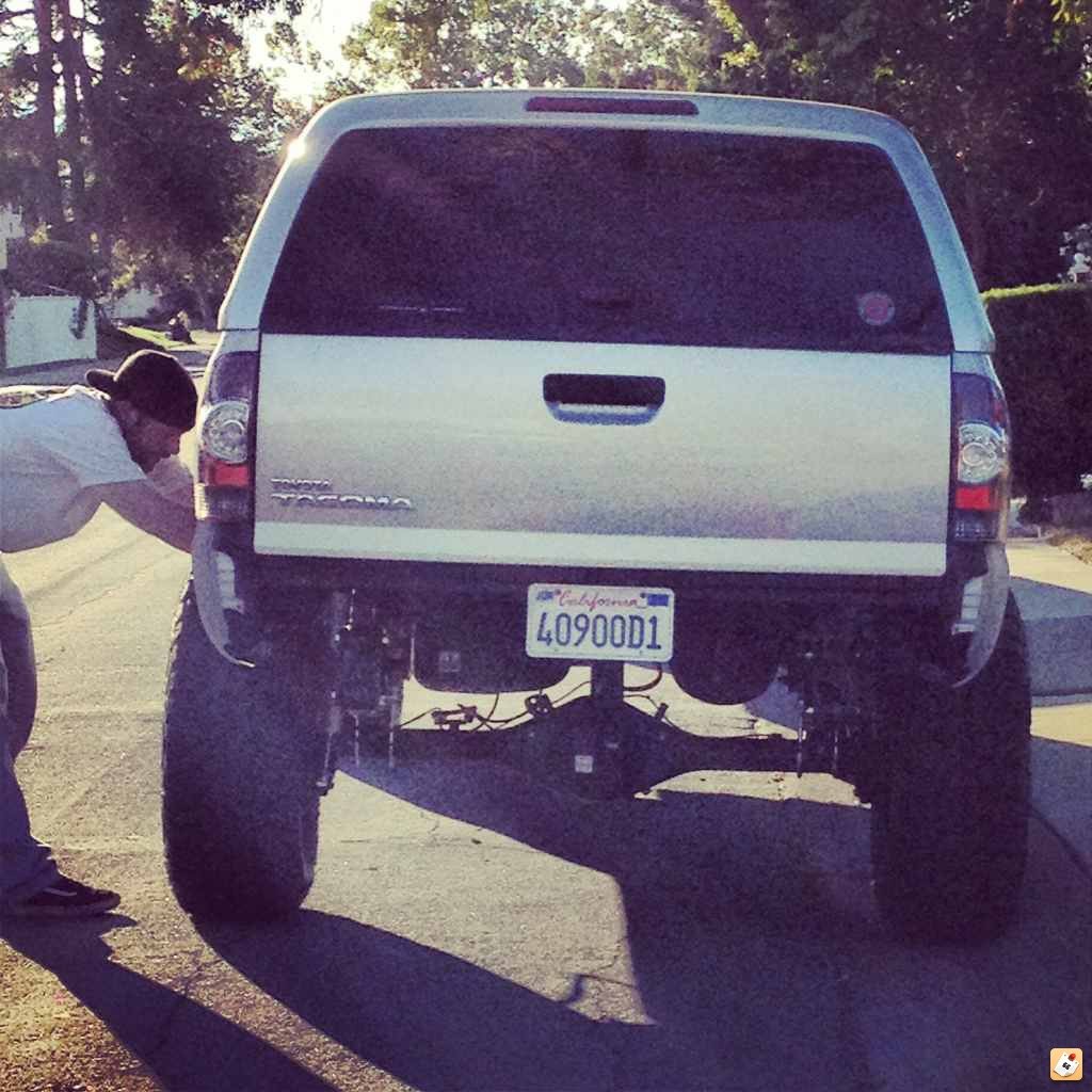

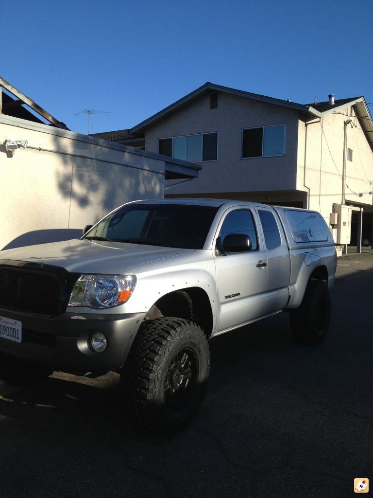

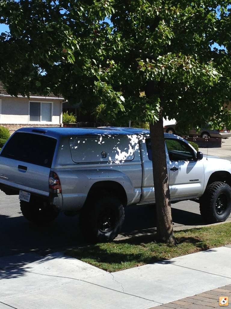

    Well I picked up my truck and....I LOVE IT! It gave the rear 3" of lift and I have so much more travel with the Chevy springs and Billsteins. It rides very smooth on the road and I can't wait to get out really use them. Here are some pics.

    Thanks for the pictures kind sir.

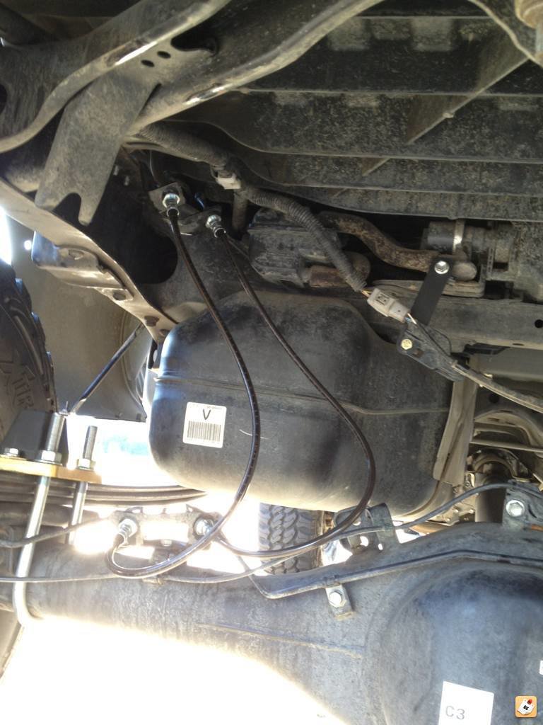

    I needed some extended brake lines also. I think the stock ones were 12-14" long. I put 26" stainless lines in.

    Nice! You either need longer bump stops or shorter U-bolts though! :laughing:

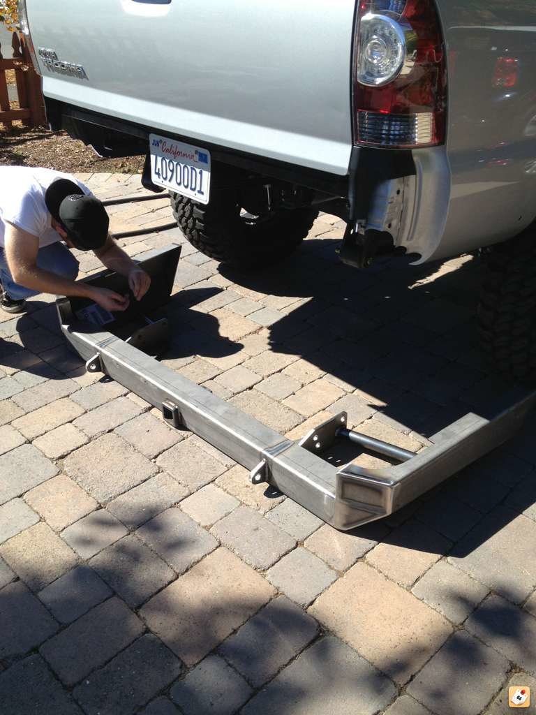

    I need to weld an Extension from the frame an additional 4". And definitely chop those long U bolts. There is still some detail work that needs to be done with the set up as well. I need to reattach the E brake lines to the frame by drilling and tapping for a mounting point.
    My rear bumper came in the mail today. So pumped.
    ATO Wraparound high clearance bumper.
