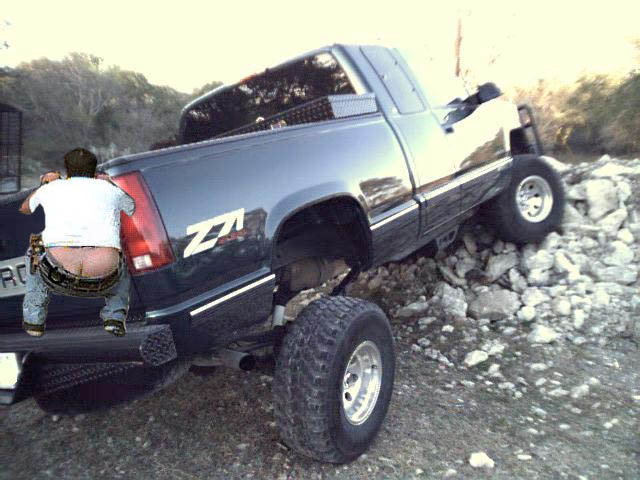

    You should try jacking the rear corner of the truck up to make sure you have enough hi-lift to get a rear tire off the ground. On my 97 GM w/ the long springs I can't get the rear tire off the ground, all the way to the top of the hi-lift, 48". So, I have to wrap a chain around the axle and frame to limit travel. Anyway, I only mention it since you switched the same rear springs. Better to find out now than in a pinch. :thumbsup:

    I have an old pic of my 97's rear flex. You'll have to excuse the photochop on it though.. ha ha (an old buddy being funny) it's the only pic I can find quickly. The 63" GM springs flex like mad. In the pic, that tire is nowhere near lifting, even though it's not a jacking pic.. you get the idea. They'll stretch and stretch until you run out of jack, unless you have a 60" and even then, I'd still limit axle travel with the chain/strap to prevent having to jack it up too high out on a variable surface that you'll likely have out wheeling. Just safer for you and the truck that way.
