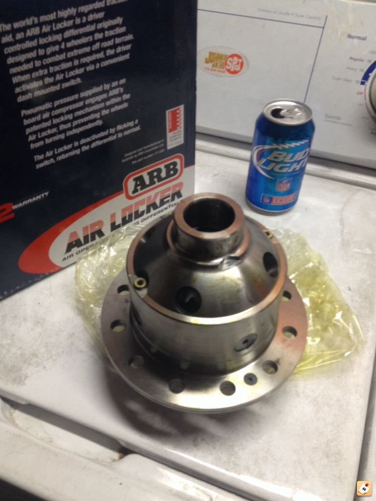

    I am picking up my R129 ARB locker and compressor today. :) I need to wait and save some skrilla to take it in the shop and have it regeared and I think it will be time to cool it on the spending. Its coming along though.

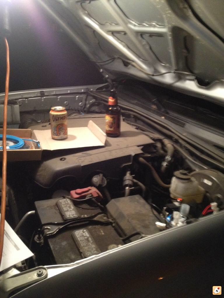

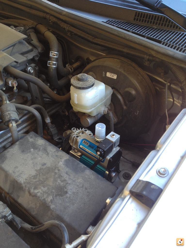

    I thought I would take advantage of my lunch break to mount my compressor.

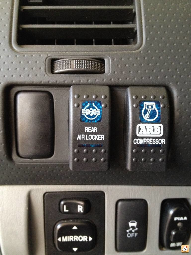

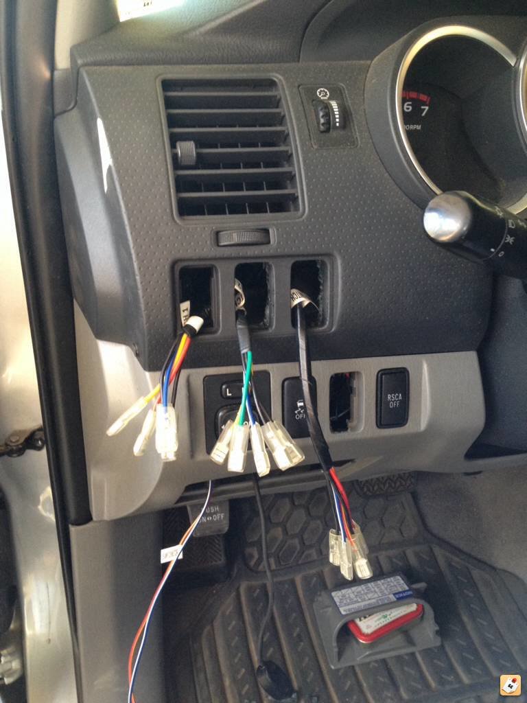

    I got the switches in and am all prepped with the wire harness. The diagram makes it real easy to connect everything.

    I picked up my truck today from the shop. Regear and ARB installed! I replaced the bearings in the rear also because apparently they were failing. The pinion bearing was noticeably gritty feeling when turned. 4.56 gears are A MUST when going to 35's. My truck no longer feels like it doesn't have a first gear. Now for the VERY IMPORTANT break in process.
    For the first 100 miles there is no going over 50mph and after every 15-20 miles of consecutive driving you need to stop and let gears cool for 1/2hr. Then for the next 400 miles continue to take it easy and keep it under 65. After that, Change oil and drive how you will.

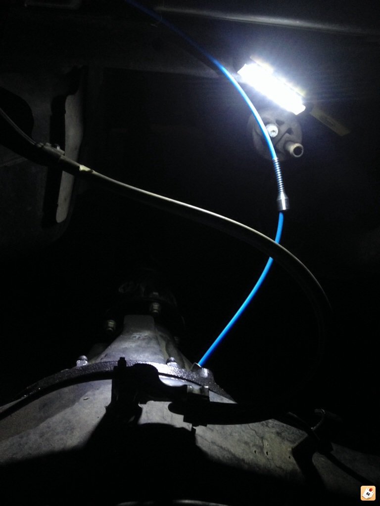

    Got the plumbing done tonight.

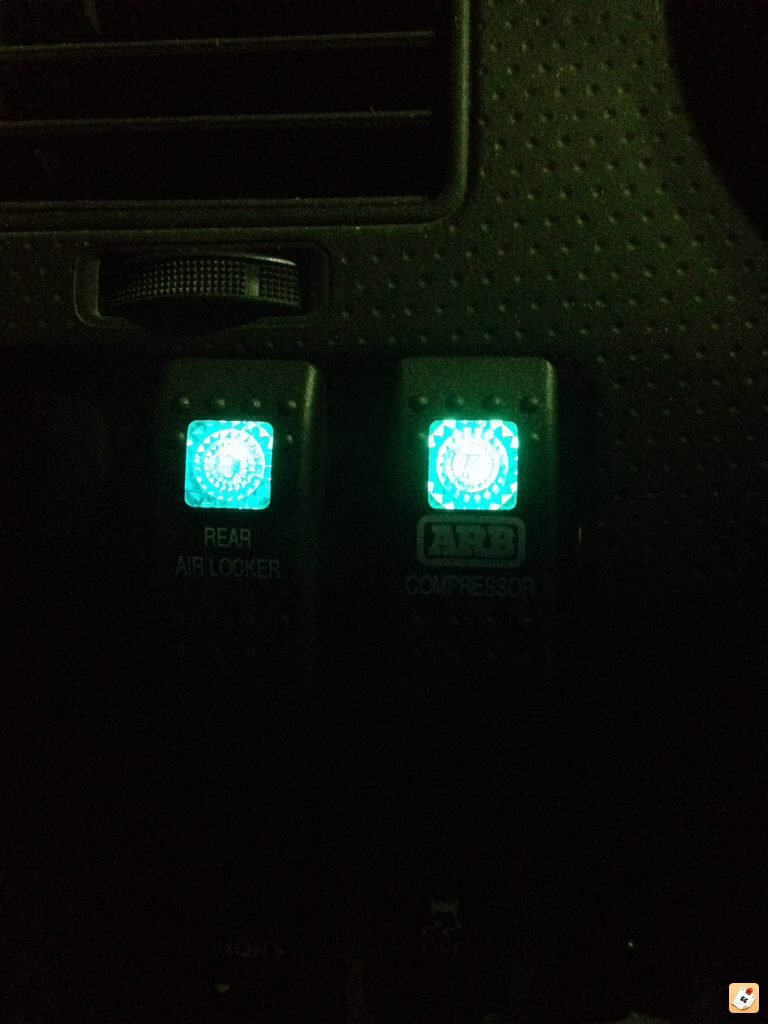

    That's a comforting glow ;)
