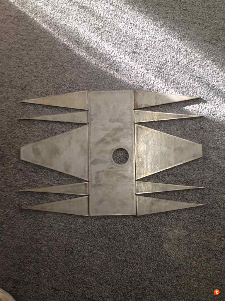

    Got my diff protection burned out.

    any word on those diff covers :D

    It's in the works. Still have to bend up the middle section and I'm thinking of making the small fingers out of a solid piece with a bend down the middle to eliminate welds.

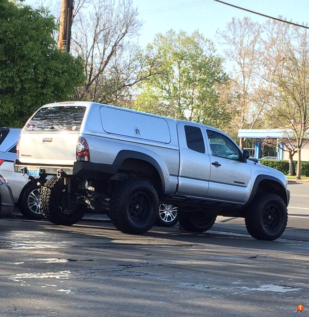

    Getting a bath right now.
