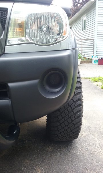

    so I have a 2011 base model aclb and I would really like to add a set of led fogs or like a pair of rigid dually etc. In the front bumper it already has holes in the bumper that look like there for this exactly. Now my main?? for the good folks of TW is that I'm wondering if they already have wiring to sort of plug and play an aftermarket set. Any one who delt with this or anyone who has an answer I would greatly appreciate input on the subject here's a photo of what im talking about with the cut outs already being there

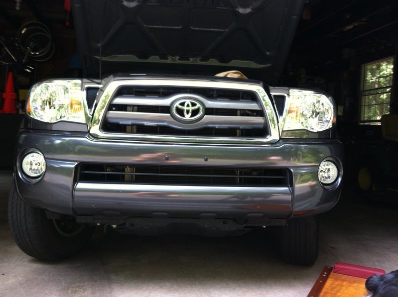

    +1 on the Amazon kit. I used this to help install https://www.tacomaworld.com/threads/non-oem-fog-light-install-on-anytime.3990/
    I found the same problem with that switch. Take the switch apart and cut the bulb out that is always on. Boom, when the light is on, so are the lights.
    jc11taco89[OP] likes this.

    ya so I just crawled under and I'm one of the unlucky ones no wires anywhere in sight:(
