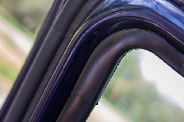

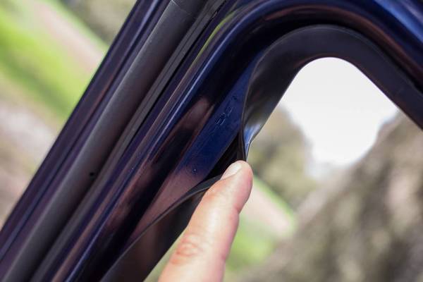

    I found that the noise for me is coming from the weather stripping around the window, where it contacts the door frame. You must peel it back gently and lube up the area where the rubber stripping contacts the door. Been using 303, but I will try this Napa product next time as the 303 is not very permanent.

    This is the stripping I'm 90% sure is making noise for mine. Put some 303 along the inside of the stripping, but that only worked a little. Any suggestions on what to put in here to quiet the rubber squeeking against the door?
