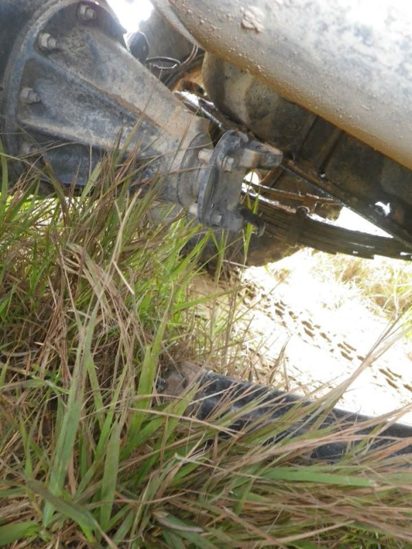

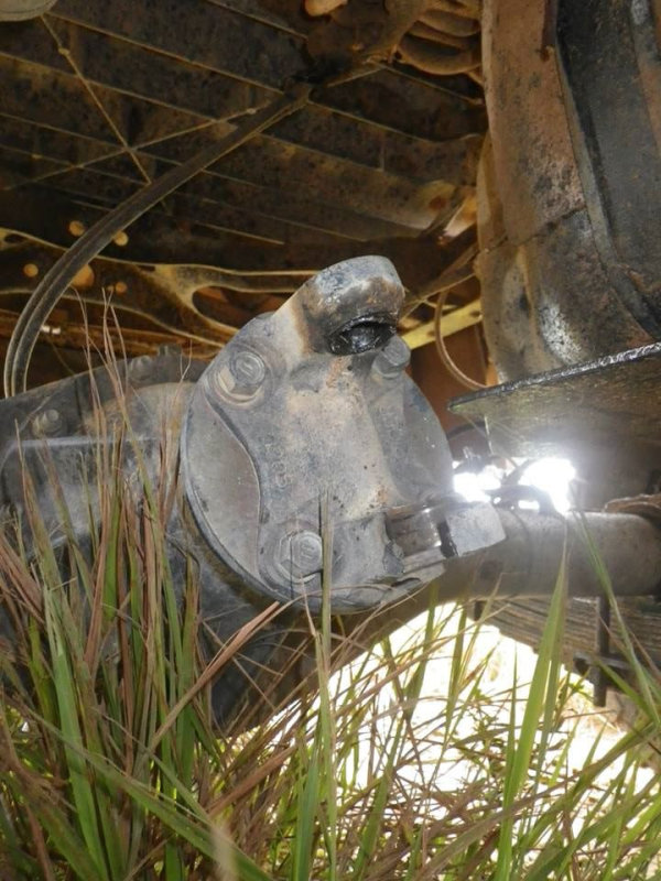

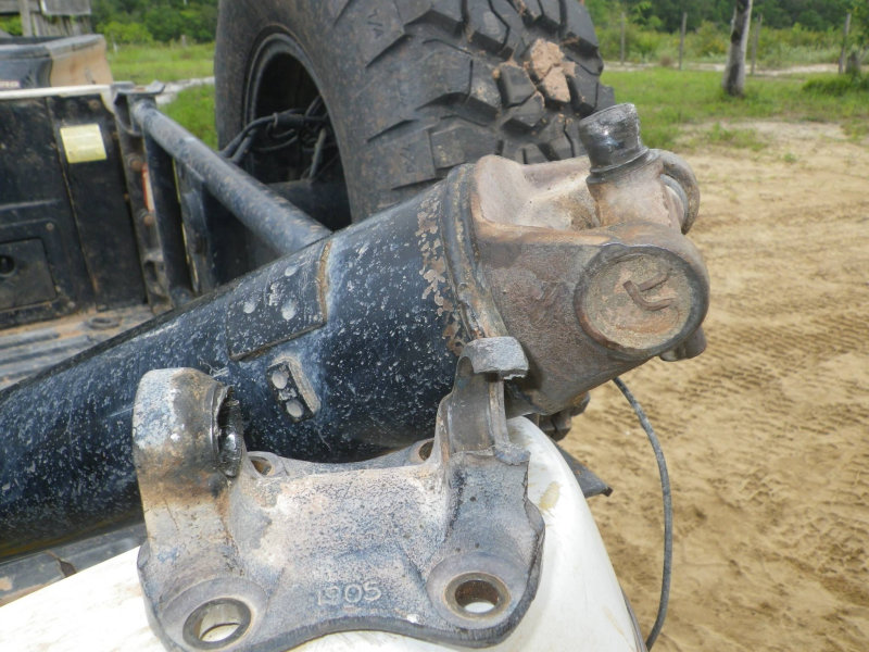

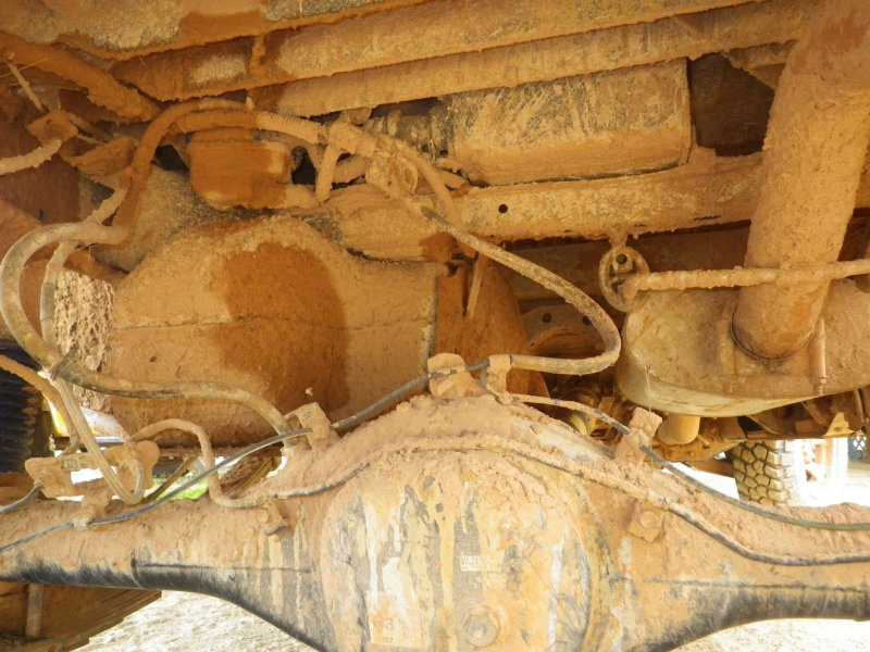

    Bang..rattle rattle..ass jumping...driveshaft failure

    That's the first 05+ tacoma that I've seen with a broken yoke ..

    The pre-runners with the sealed cv joints do that here and there. It's usually the front or center joint that goes first though instead of the rear.

    The nipple broke off some time ago and the joint was not serviced. It's just lack of Maintenance combined with the severe dirt and water. Surprisingly there was no significant vibration. Good luck for me it failed at low speed. I have 3 of the hard to find yokes in my garage..Toyota does not sell it separately so I was lucky to find the yolks with a lot of research. If you damage your yolk the option is either a new or used shaft. Good luck to find a yolk..lol

    Had a similar issue with the nipple. Noise and vibration occurred suddenly while driving home from work one night. Replaced the ujoint and all was fine after. I have pics that I will post later.

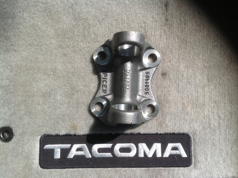

    Thats a flange not a yoke. :p
    And this is a yolk:

    Actually its a Flange Yoke..my spelling mistake.

    Thanks for that wonderful Video. I just came back from Guyana and ran through everything on the truck. For the battering it took while down there its still in pretty good shape. We had a Driveshaft Bearing failure but that was due to lack of Maintenance...GREASEEEEEEE lol. Andrew gave me a lesson on grease types..now I am educated.
