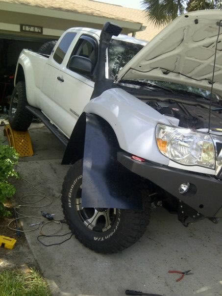

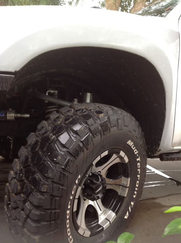

    My god, thanks! Is the 3/32 sufficient enough for the amount of abuse that it goes through? Like does it get any rips, tears or holes? I've been looking for something like this for a while.
  3. Nov 16, 2012 at 5:26 PM
    #143
    Milowilli
    Milowilli [OP] Milowilli
    Jan 17, 2012
    #70857
    370
    Miles
    Naples FL
    05/ 07,09/11Tacoma access cab 4x4
    Yesss it's strong. If you mold it with heatgun it's even stronger. Start on rear of front fender and fasten up towards front. Make sure you have enough overlap on inner fender and at least 6 inches on outside before trimming,

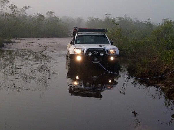

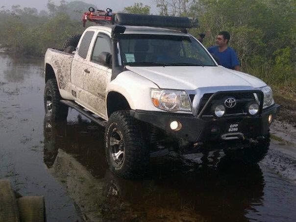

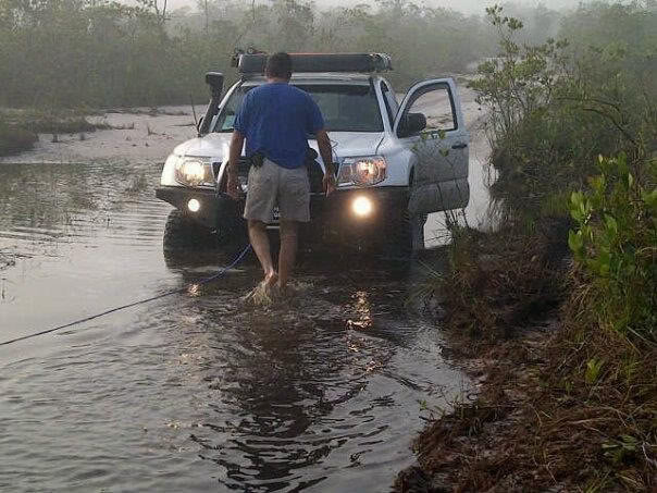

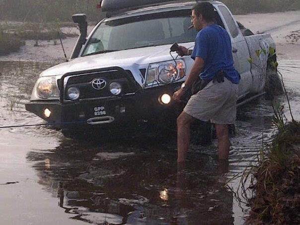

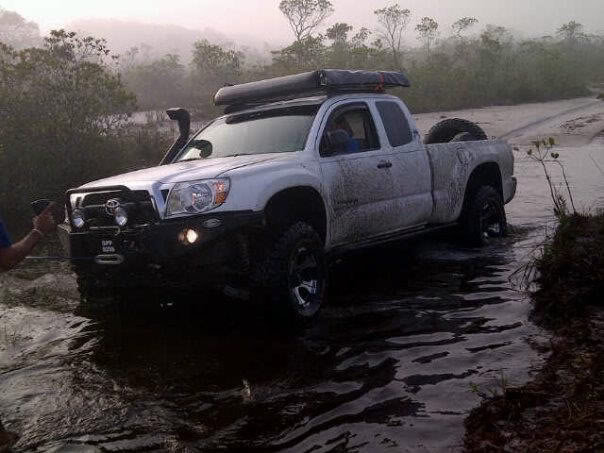

    Testing the Winch in a peat mud hole!!

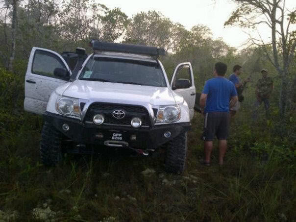

    Hunting trip in the jungle

    Looks clean. And you make it sound easy to install but I'd probably mess something up. I'm looking to get a snorkel & fixing my fender wells at the same time. Thanks for the info

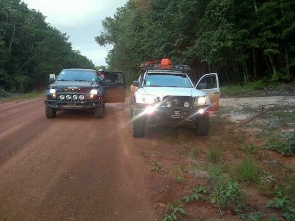

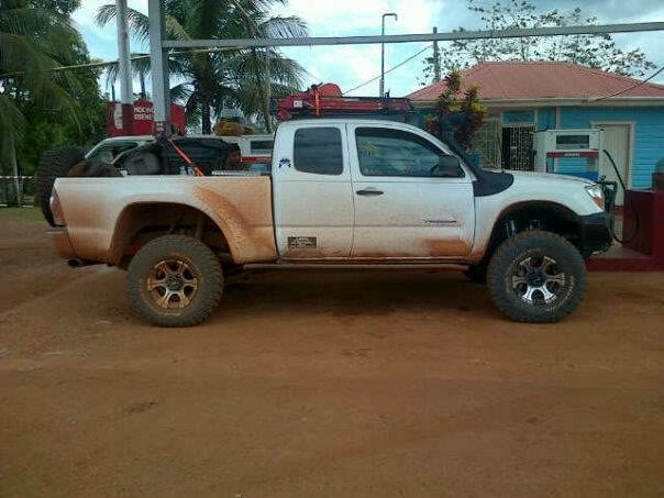

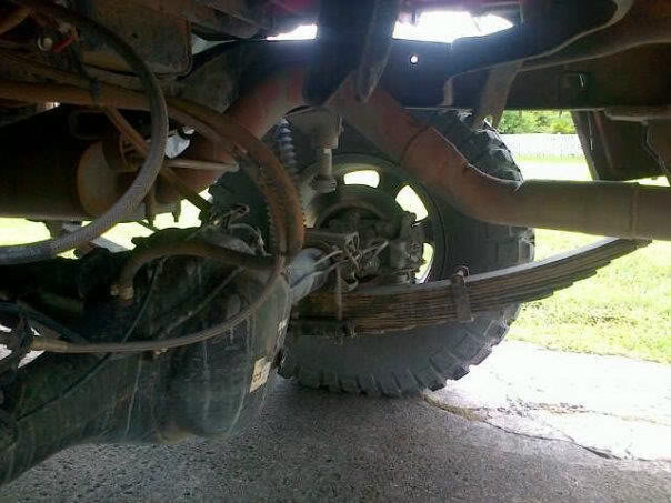

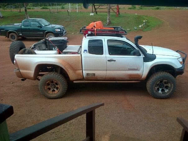

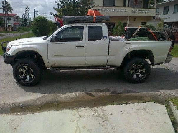

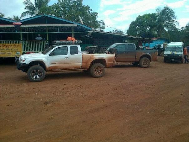

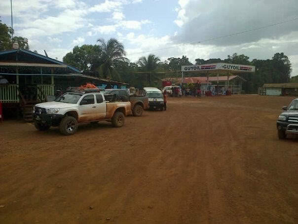

    Tacoma going on a 600mile off road trip in Guyanas Jungle..pics coming slowly depending on Internet access.
    Loaded ready for the trail.
    Rear suspension loaded lots of up travel left.
    Raptor chase truck.
    Snack stop at 58 Mile Mabura.

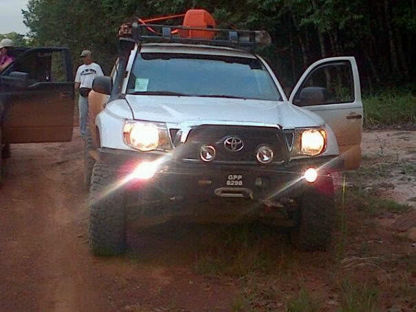

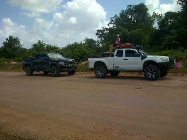

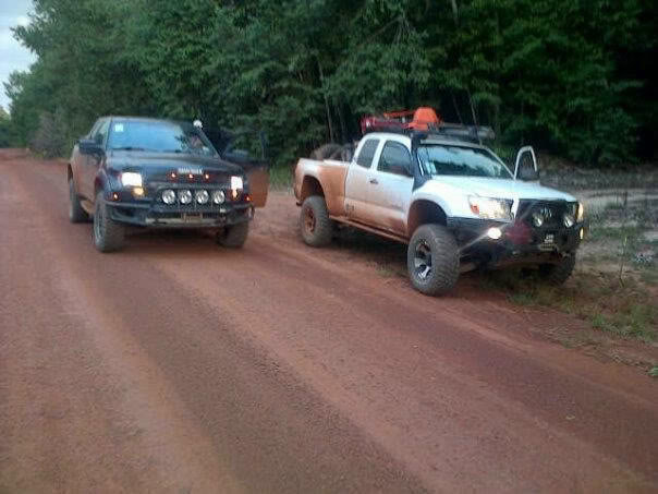

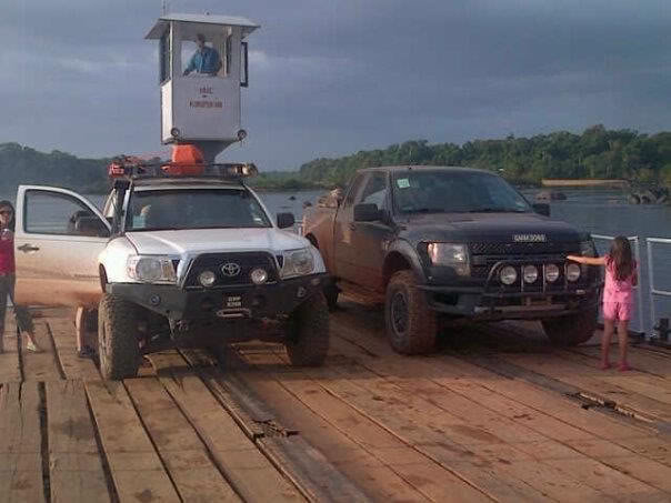

    Ford Raptor and Tacoma at kurupakari crossing the Essequibo River on way to Lethem Guyana..more pics to come soon.

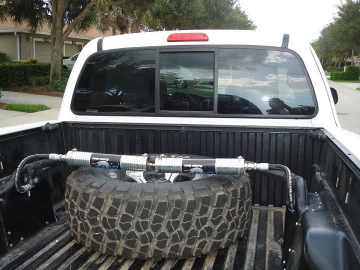

    Differential Breather Mod Light Bar: 4 Cree LED lamps Bilstein 5100s Ride Rite Air Bags
    Nice job... and good one with the rear diff. breather mod! Why did you pick Fox... they were recommended for me as well... for use in Baja and the desert. Thank you!

    How many times have you pulled the Raptor out of the mud?

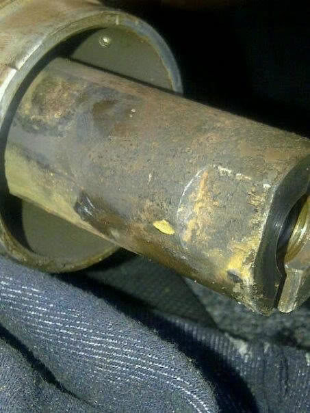

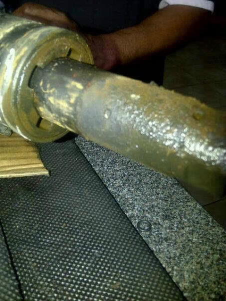

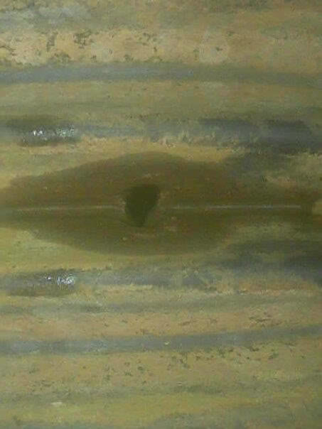

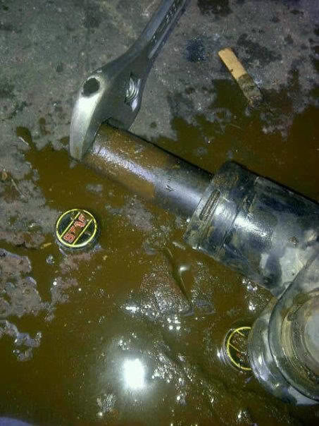

    We had a steering issue. There was a small burn hole in the rack boot which sucked in water and rusted the rack causing steering tightness..the rack was removed and serviced and fixed the problem. Two leaves were added to the rear Deaver spring pack to deal with the load carring issues of the pack. Other than that all is well so far with truck..nothing broken yet!!!!

    None yet..Raptor holding its ground!!!

    Fox rocks man!!!! King has just come out with IBP Shocks..sweet..read up on them.

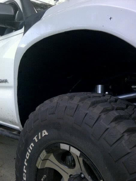

    Small burn hole we missed in Rack boot
    Water and muck got in causing rack to get tight.
    Water damage..less tha 5K miles on truck
    Does this look like a brand new rack??? Lol
    I wonder how some guys run racks with spherical bearing rack ends without boots??? The rack was cleaned out and serviced..so far so good.
